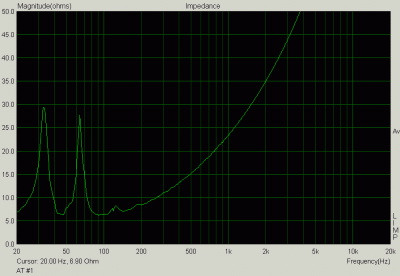

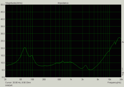

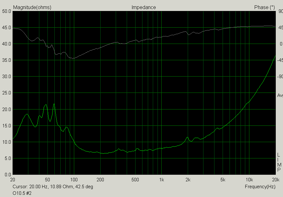

So tonight I took a few scrap components, threw together a Q&D jig, and took impedance plots of 6 cabs all in one evening and it cost me nothing but a little time.
Autotuba
Wedgehorn 8
Omni 10.5
Posts: 2704

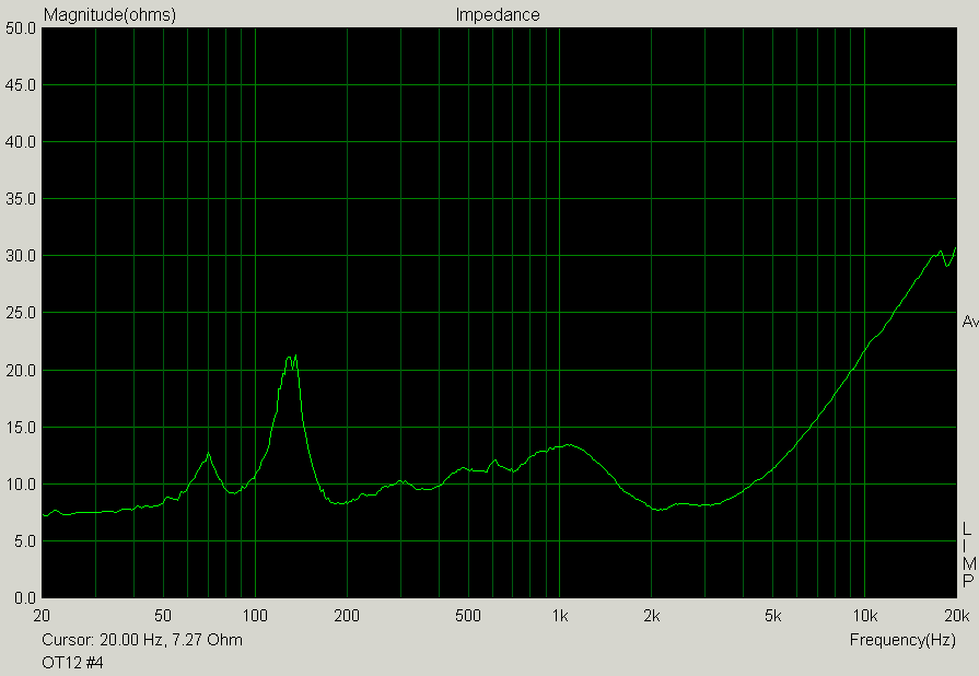

It got interesting as I got to my OT12 cabs.
OT12 nr 1
OT12 nr 2, very similar
OT12 nr 3, somewhat different
OT12 nr 4, very different
I would think there is something not quite right with the number 4 cab. Could this be a leak of some sorts? Other than the handles/ports it should be pretty much airtight. Can something like a sloppy driver gasket show up like this in the impedance plots?
Posts: 29094
Re: Impedance testing
AntonZ wrote:
I would think there is something not quite right with the number 4 cab. Could this be a leak of some sorts? Can something like a sloppy driver gasket show up like this in the impedance plots?
Yes. The reduced and shifted lower peak indicates the cab is tuned too high, and either a leak or an over-sized port will do that. But as the upper peak is also shifted higher a driver gasket leak is the most likely source.

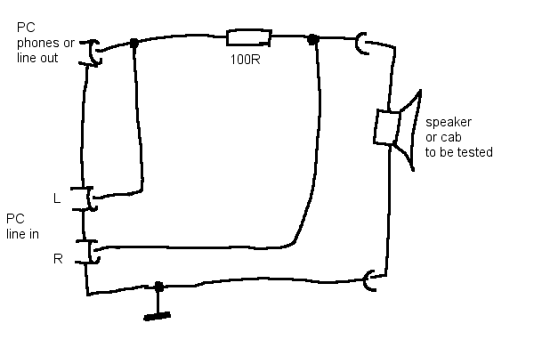

I don't think I have ever made anything simpler than this. A bit of wire, a few connectors and a resistor. I threw it together in a rather haphazzardish way, so I'm not going to make any pictures of my sloppy solder work and wires hanging loose. Instead, here's the schematic.
The program that I used is called LIMP. It comes with Arta (clickable).
Personal license is €79, commercial license €149. Screenshots were made from the evaluation version.
I think the same thing can be done with another program called "Speaker workshop" which is free. I haven't tried that one.

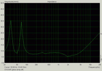

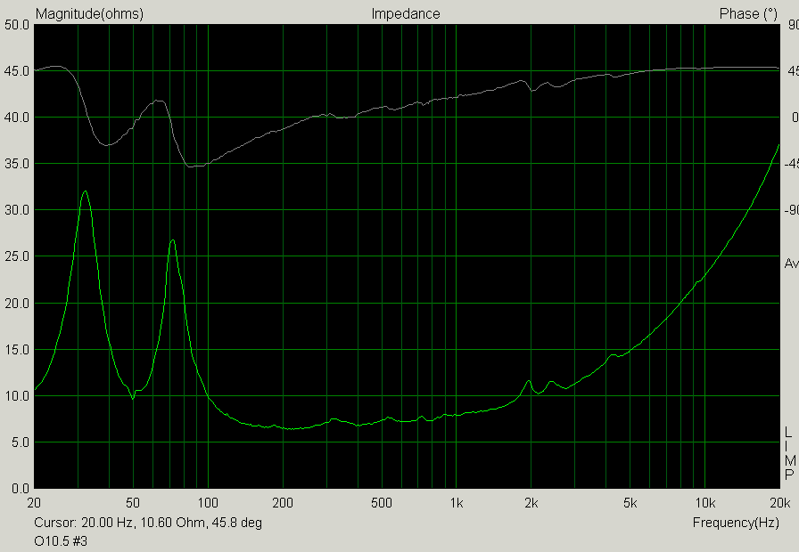

As I wrote in the opening post of this thread, I am currently working a bit on my pair of O10.5. So the cover on one of the pair was not tightened down today, because I'm working on the inside. Things like add piezo HP filter, a bit more egg crate foam, get wiring ready for melded array in the horn mouth.
Just to see what effect it has on the impedance curve when the back is not properly sealed, I tested both tonight. Both cabs face down but up from the floor (sitting face down across two other cabs).
One of the pair is properly sealed, screws on the back all tight. The impedance plot looks like this:
On the other one the back is not tightened down. Just gravity pushing down on the back.
As soon as I put a bit of my weight on the back of the last cab, the plot cleans up and starts to look just like its' sibling. Useful stuff, and I will look into the #3 and #4 OT12 cabs. Those will be opened, driver gaskets checked, driver screws either tightened or replaced by bigger size if they have torn from the wood. Going to report back after that (may take a while).
