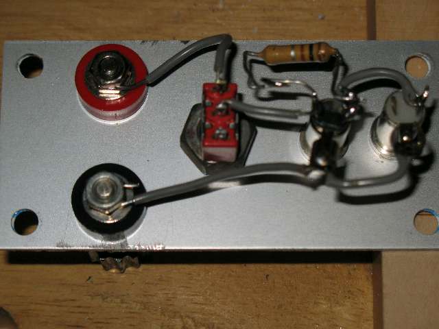

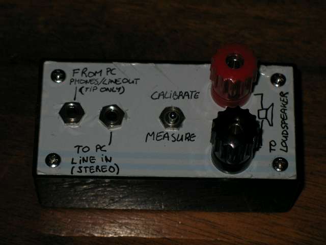

The first incarnation of my impedance testing jig was ugly. Just some loose wires, connectors, a resistor, all hanging from the back of a pc's audio jacks. Something dropped off my desk and tore the whole thing apart. By now I am convinced by the usefulness of these measurements. So I made a better version that will hopefully last me a long time.
Front drilled, connectors and switch installed. All wired up. This is all there is to it, even I can do this
Here is the finished jig.
I intend to take plots of all my cabs over time. If somethings goes wrong with any of them, I can use the existing plots as a reference of a good cab.

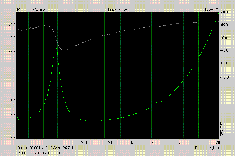

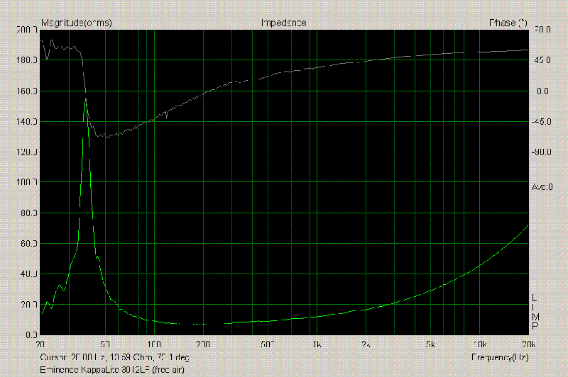

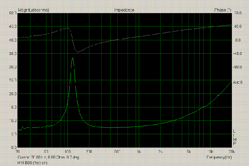

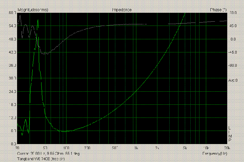

With the new jig ready, I decided to take plots of a few drivers. No cabs, just drivers free air. Here are some popular drivers:
TangBand W8 740E (fs = 32Hz) HiVi B3S (fs = 80Hz)
(this is a nice and good looking 3" driver that can be used for small versions of SLA and SLA-curved (see pics on Leland's website http://www.speakerhardware.com ) ) Eminence Alpha 8A (fs = 73Hz) Eminence DeltaLite II 2510 (fs = 53Hz) Eminence KappaLite 3012LF (fs = 37Hz)
Re: Impedance testing
From most of these drivers, impedance plots can be found online. My measurements pretty much match the online plots. Good
Note from the plots above that the peak in the impedance plots happens more or less at fs (resonance frequency) from the driver specs. The little HiVi driver is a bit off, but my guess from the above is that the impedance peak should match fs. Can anyone confirm this?
