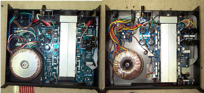

More room for better airflow around the Behringer transformer?
Just kidding, just kidding.
Re: Behringer EP4000
In EP4000 transformer is biger than 2500. I will post a pic later.

Here it is, EP4000 open
Very big capacitors

hi pal a friend of mine blew 2 in a night (i think he is the missing link he had blown away crowns and the old reliable peaveys by dozens each) in the fact that if an amp can get 4000 w frm a 15a circuit 2000w @2ohms per ch are 63 volts 1200w are 49
I overlooked one of the blown amp (we made an autopsy that was great) and it is fairly the same ep2500 amp maybe with disctint architecture. they are made to cover the main flaw of the 2500 in the road that is almost no headroom at lower impedance. they sound the same as 2500 except maybe for that even that you need a great supply of power to move them we used a 30A 240v in that show. i mean do not connect 2 of them in the same oulet/breaker

producerd wrote:Here it is, EP4000 open
Very big capacitors
mines are bigger hahhahh

As has been shown in the photos, the EP's are essentially reverse-engineered QSC RMX with cheaper components substituted in some places. They may be cheap but I dislike Behringer's business practices enough that I don't even consider them an option.
For an inexpensive amp, stay tuned for the new super-lightweight IPR amps coming out from Peavey. They are due later this month, and have lots of power at very reasonable prices.
