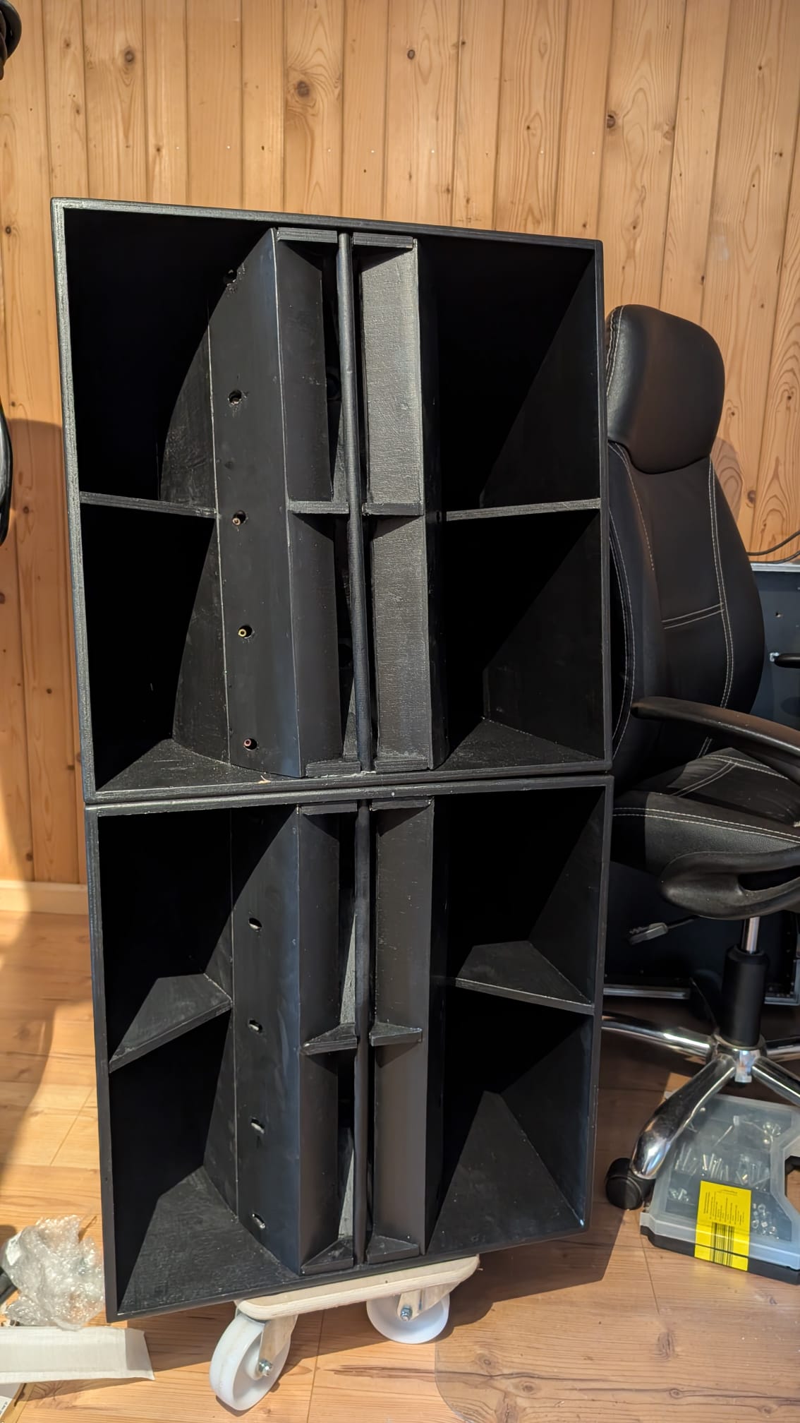

Just a short update, sanding and first layers sprying before duratex ongoing as the weather started being nice enough :)
Soon to be completed.
edit: first layer of finish as well :)

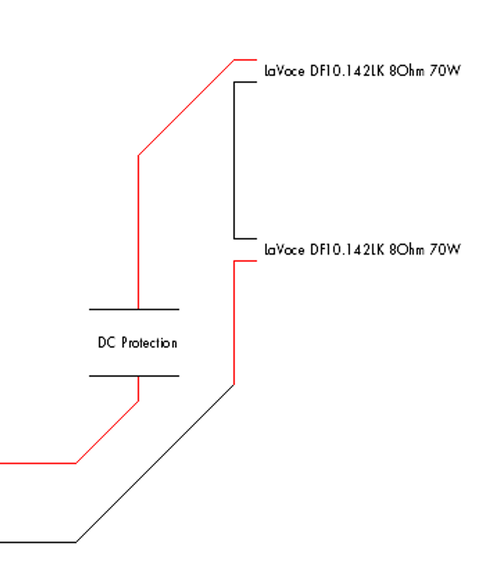

Got the software installed so far, the filler as well as the half-soft-ware; now the interior design is complete except the electric parts :)
One Question before i solder something bullsh*t together:
the dc protection on the hf module, wired in series - in the hot line or the line back? Between the drivers? Does it matter at all?
I mean this situation; my assumption would be (for "protection") befor the CDs in the hot line: The LP so far clear, as it is in the plans.

Hrhr, well yeah :)

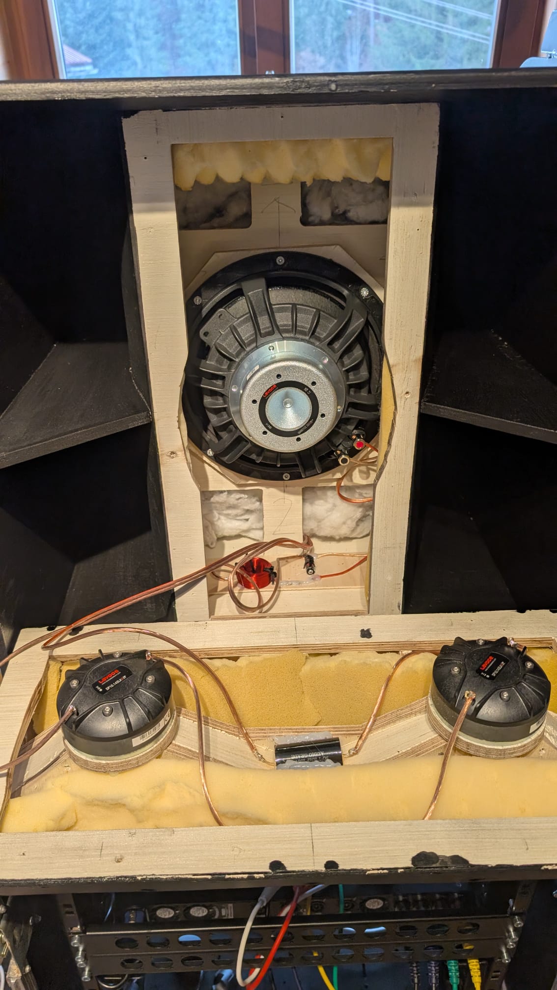

So i did it as painted above, put everything inside, and gave it some music to feed on.
Gladly, the trip was worth ist even without eq :D super clean sound, timing already (at least audible) in time and directivity is awesome.
I had to stop cranking it up way before any limits, outside it is raining and in the little room i did not want to risk ear damages :D
But i got what i expected, thank you bill for this and the others for guiding me as well :)

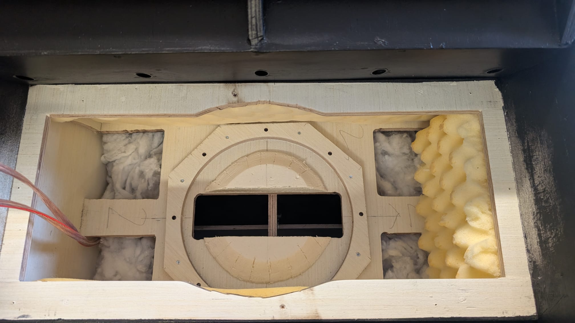

The inside before closing
Both wired and finished.
(First damages in the surface already, and the tape around the hf module did squish the middle a little bit out. will see if this sets over time.
The wiring from the rack also done finished, 4 channels in two cables running fine.
The linking also works as intended, both ways.
Will see when the weather gets dry enough, take them outside and measure it and play around there :))

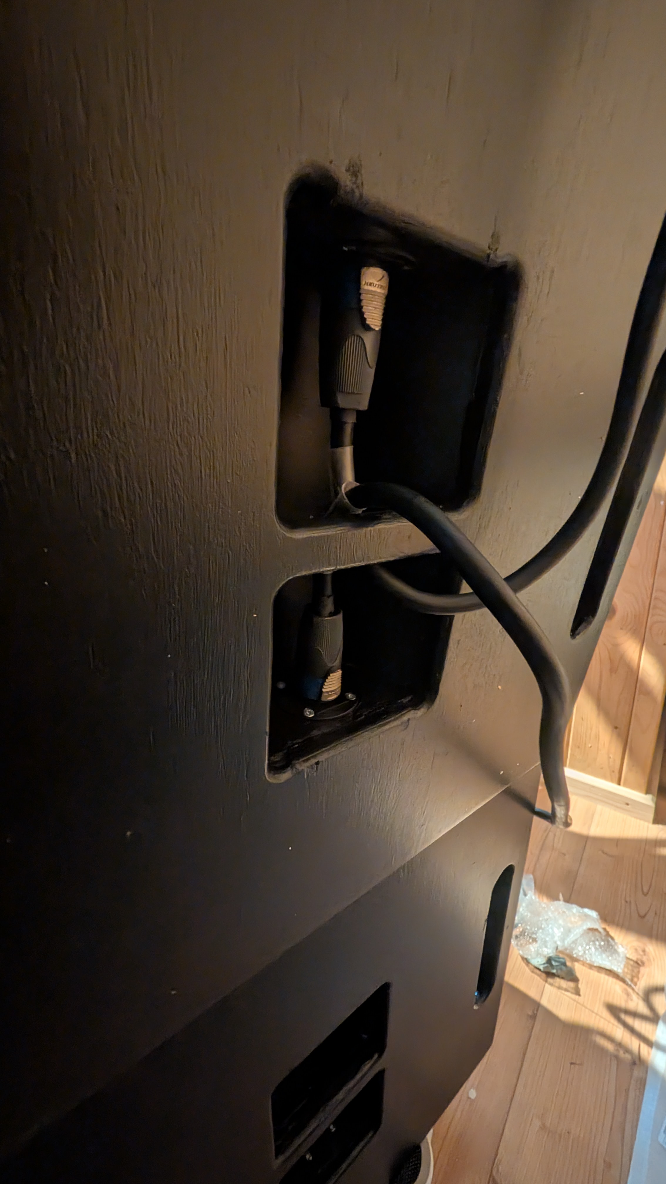

To the wiring inside the handle:
Works as planned; the handling of the connector super easy (even a bit smaller would be possible, but smaller the handle is no more grab-able by my slightly oversized hands)
Happy with that solution :) Will add that to the next pair as well. But the next will be only one 4pole connector i guess

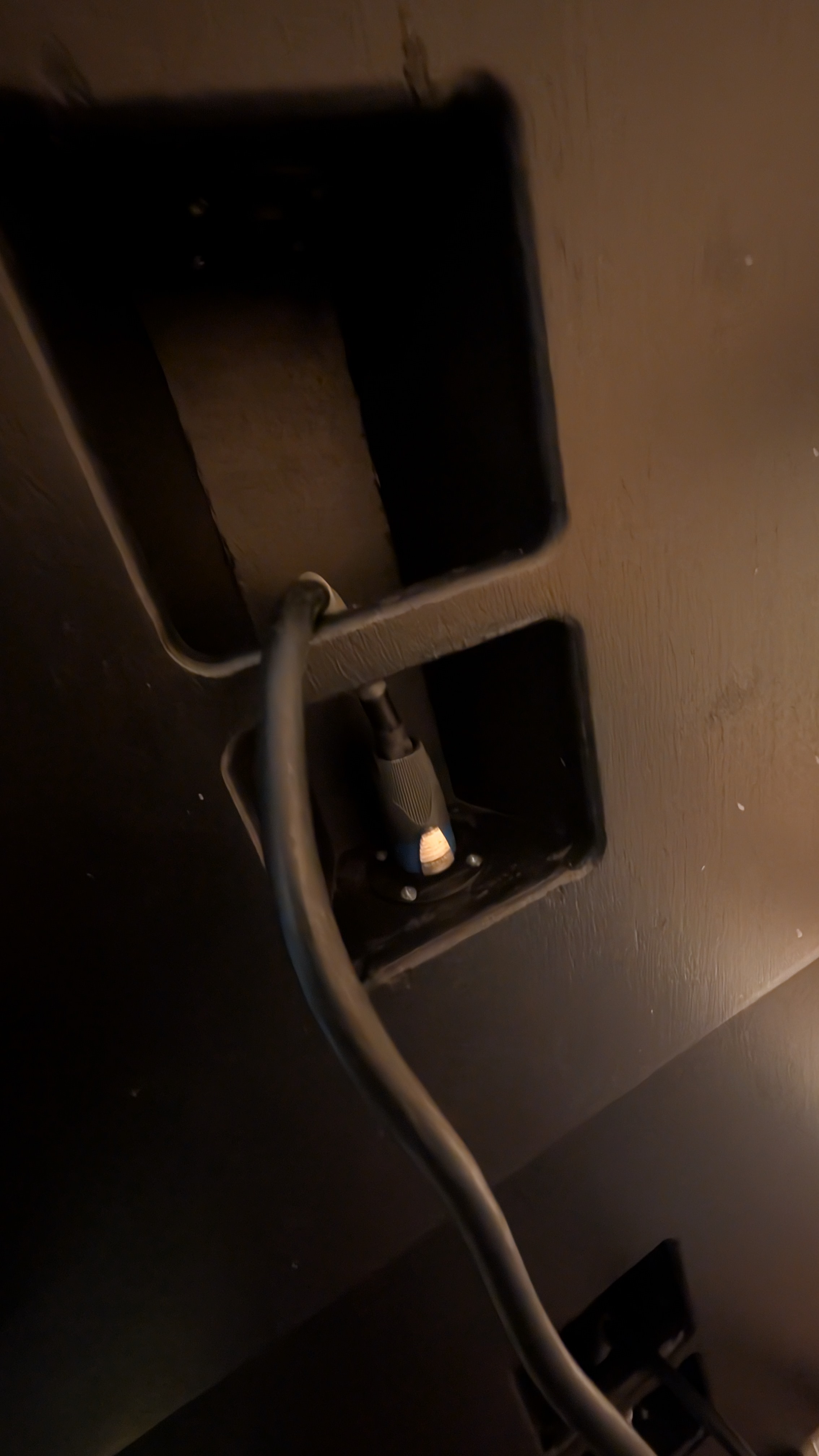

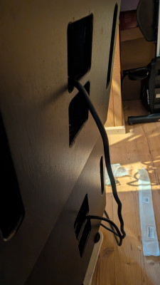

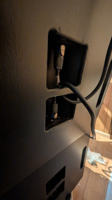

Noticed the first f*ckup :D one of the 8-wire-connectors got loose, probably not properly done by me due to space issues.
After fishing the lost cable out there, i got a new solution with a piece of solid wire as a spacer.
But conclusion from this trip: go and make all the wires to one bound pack some space beyond the connector, to avoid loosing one behind the little hole...

The amp i power them with has its own voltage limiter, i set them according to the drivers specs but i never came close to the limiter activating.
This is how the limiter looks like in the amp interface, it is a wharfedale DP4065F. Would be enough power to have 4 DRS on it, 2 channel for midrange and two for the HF-region.
Seperation is done in the driverack, limiter is the only fancy part of the wharfedale i use.
Then i did some measurements "naked"; shows a wild curve and especially a deep dive around 1,2 khz: This was naked spl and phase (no calibrated mic, and no calibrated spl. Leveled with SPL app on my phone)
I tried around a lot, also with the crossover placement and how steep it could be. And i added 4 bands in the EQ in the driverack to correct the curve a bit:
The smoothest so far (got louder in between yes); XO set at 1,7 KHz now. seemed audible the finest point, when i can drive them outside i will optimize that further.
Low cut is now at 100Hz as i want to use them with subs; just wanted to see how it feels down there.
Yeah probably works for some applications w/o subs; not for me. But as a top, sounds fine :)
And then i thought i could try to poke the limiter.
Well, no i do not want this. the output is kind of obscene; i did not want to reach to the limit. Especially when in the same room and not really a place to hide :D
But interesting yeah, sounds good as far as i pushed it.
Took the HF section 2db lower, to have it a bit easy on my ears, and listened to different styles of music...all of them went well through there, i like it :)
When i can go out and do real measurements, i will add them here for completion :)

- Posts: 29100
Re: 2 DR250 build - Europe Materials -finished-
Try reversing the polarity of the tweeters, that may fix the dip.
Marflinger
- Posts: 113
- Joined: Thu Dec 04, 2025 1:20 pm
- Location: Germany-Blackforest
In the first view, the tweeters were crossed at 2khz; but in the last shot they are inverted yes, this helped.Bill Fitzmaurice wrote: ↑Sun Feb 15, 2026 8:03 am Try reversing the polarity of the tweeters, that may fix the dip.
