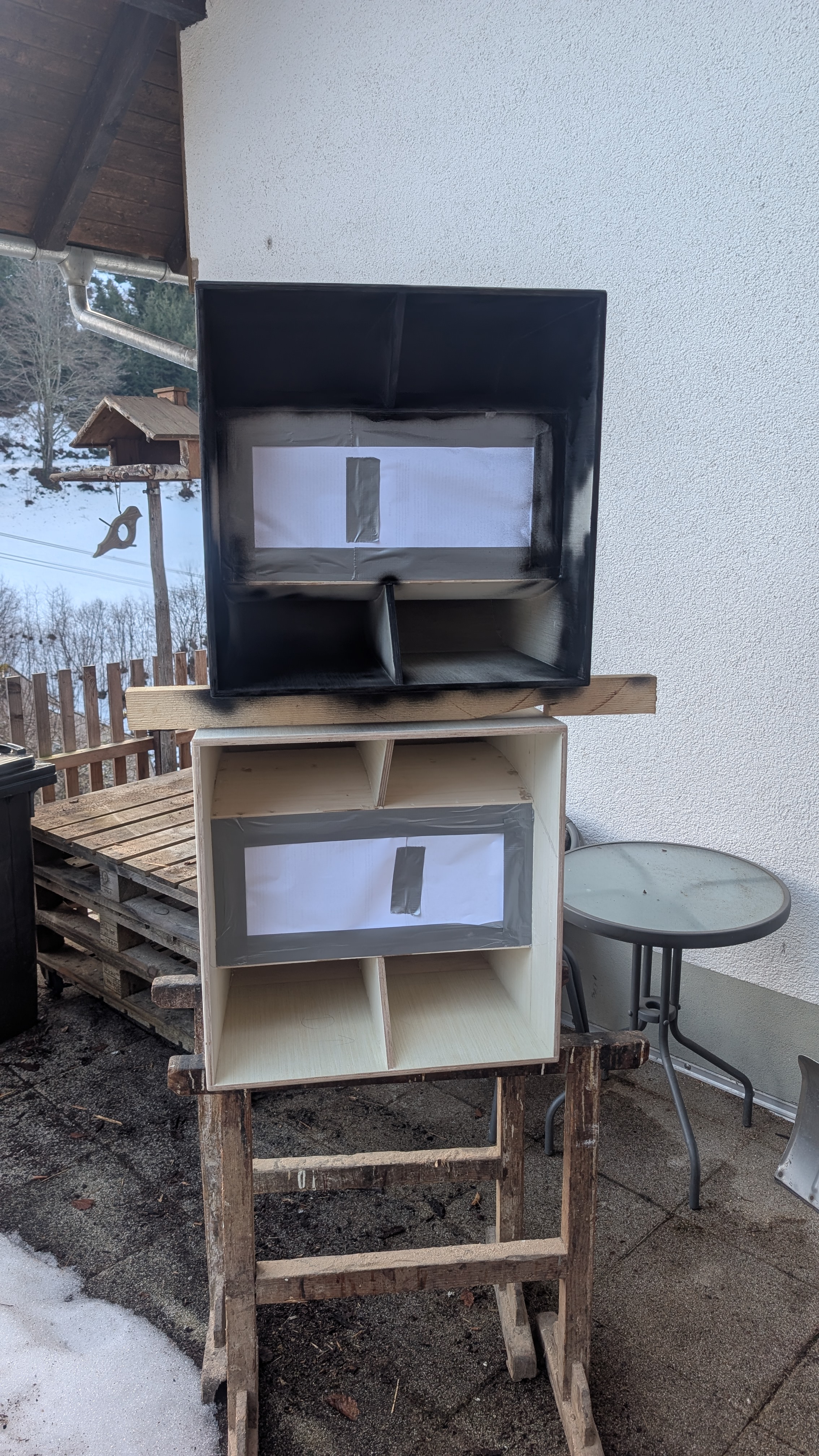

Just a short update, sanding and first layers sprying before duratex ongoing as the weather started being nice enough :)
Soon to be completed.
edit: first layer of finish as well :)

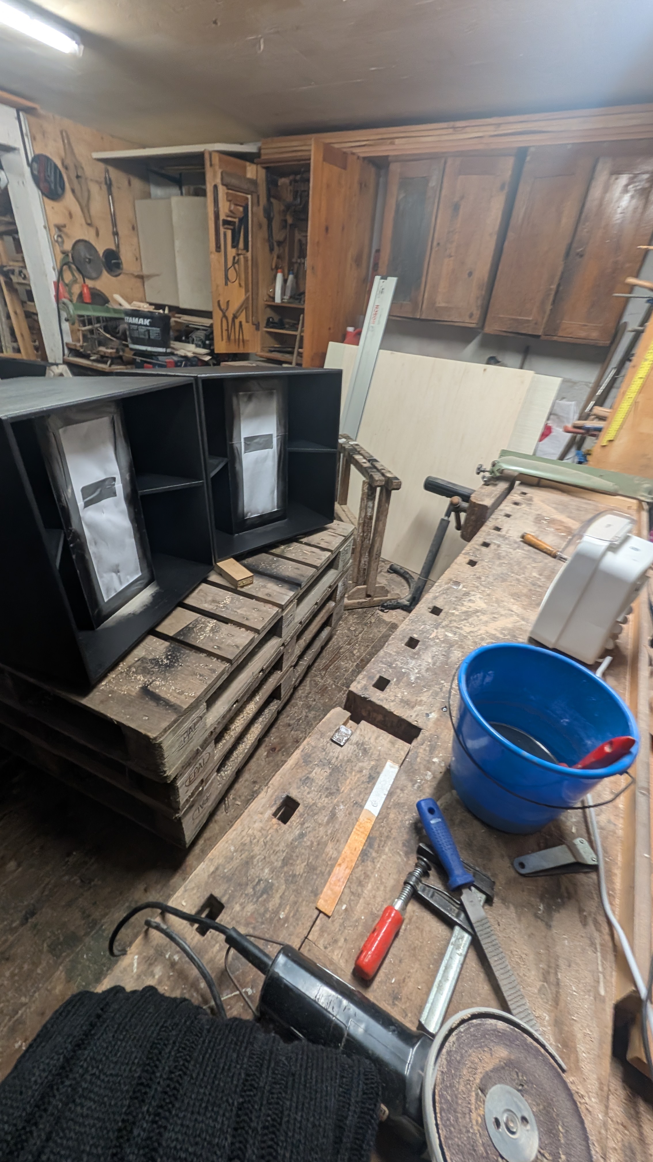

The inside finished and drying...In front of a heater due to winter still wintering
Today will be the last coat on the outside as well, as soon as i can flip them over :)

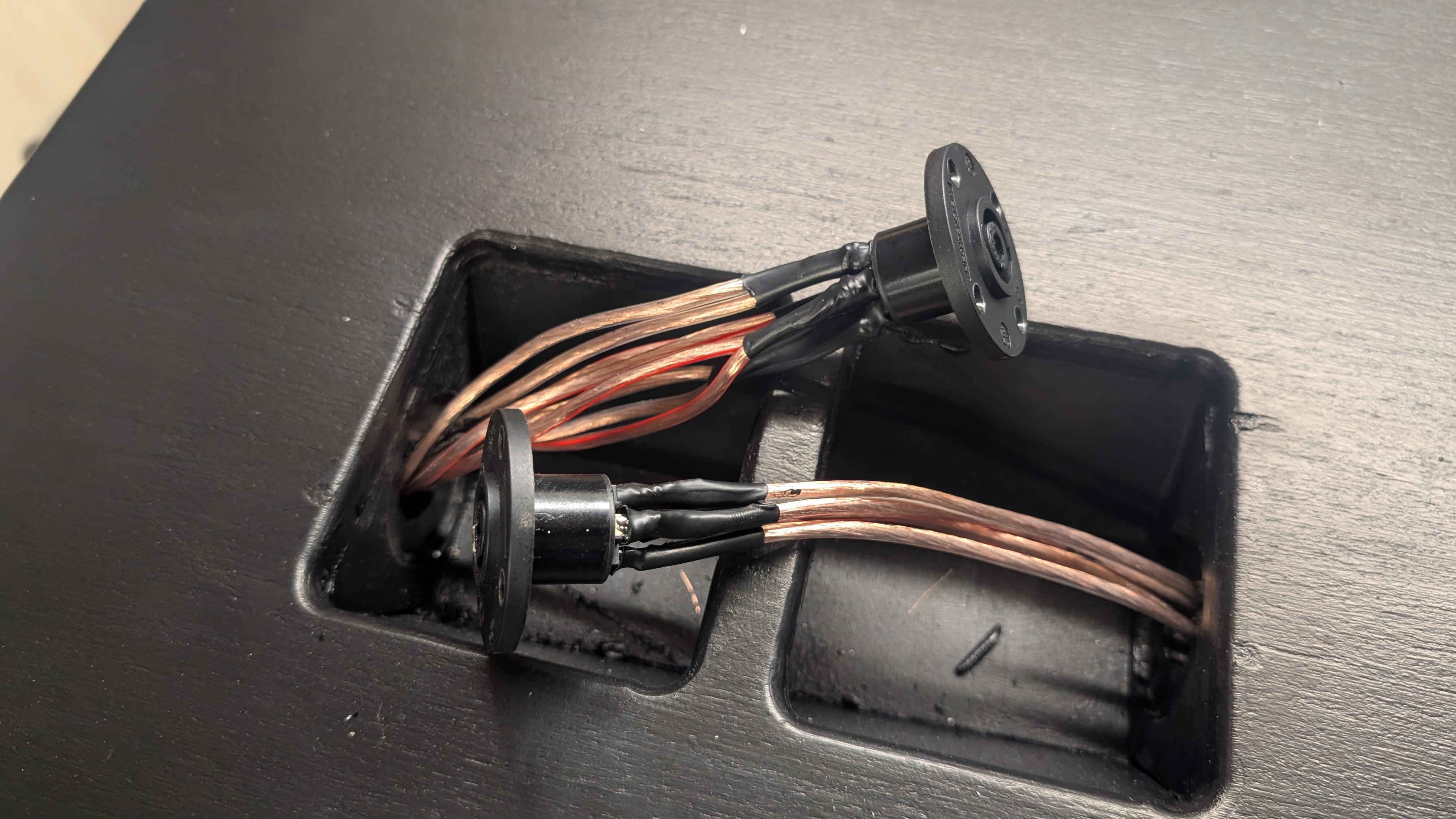

Did the wiring of the connectors (to big wires, used a shrinking tube to keep them sep.)
Esp the input is sort of in suspension with 8 wires soldered to it :D

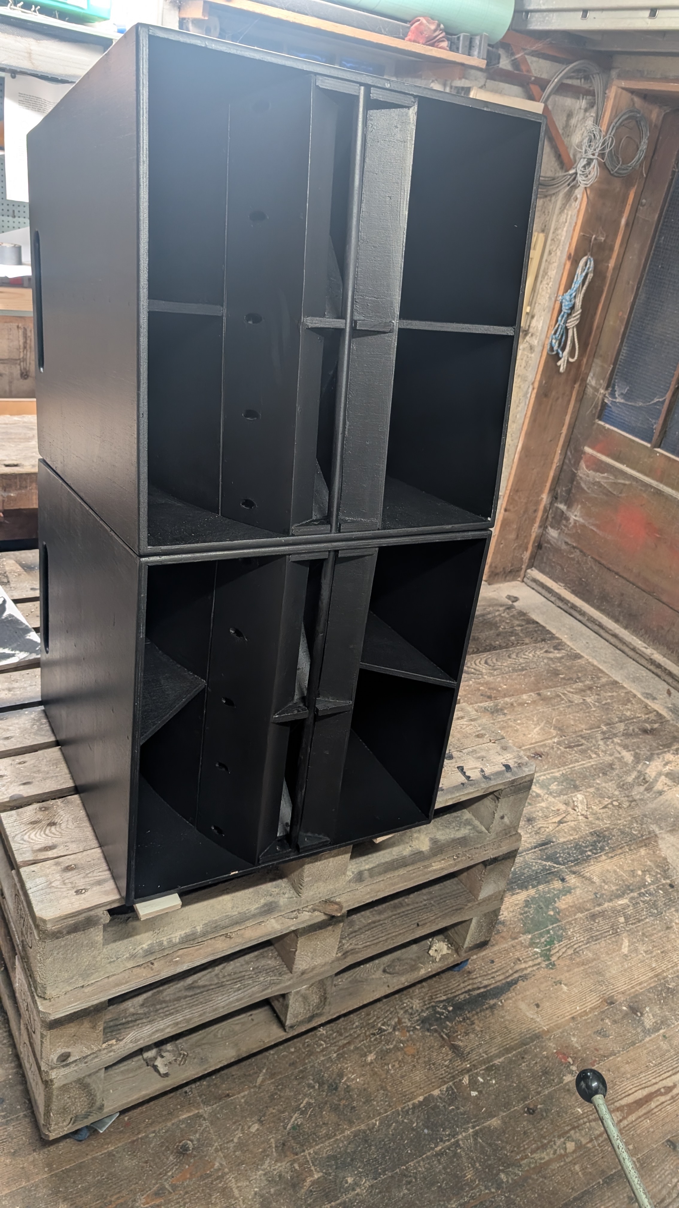

Hrhr, well yeah :)
So i did it as painted above, put everything inside, and gave it some music to feed on.
Gladly, the trip was worth ist even without eq :D super clean sound, timing already (at least audible) in time and directivity is awesome.
I had to stop cranking it up way before any limits, outside it is raining and in the little room i did not want to risk ear damages :D
But i got what i expected, thank you bill for this and the others for guiding me as well :)
The inside before closing
Both wired and finished.

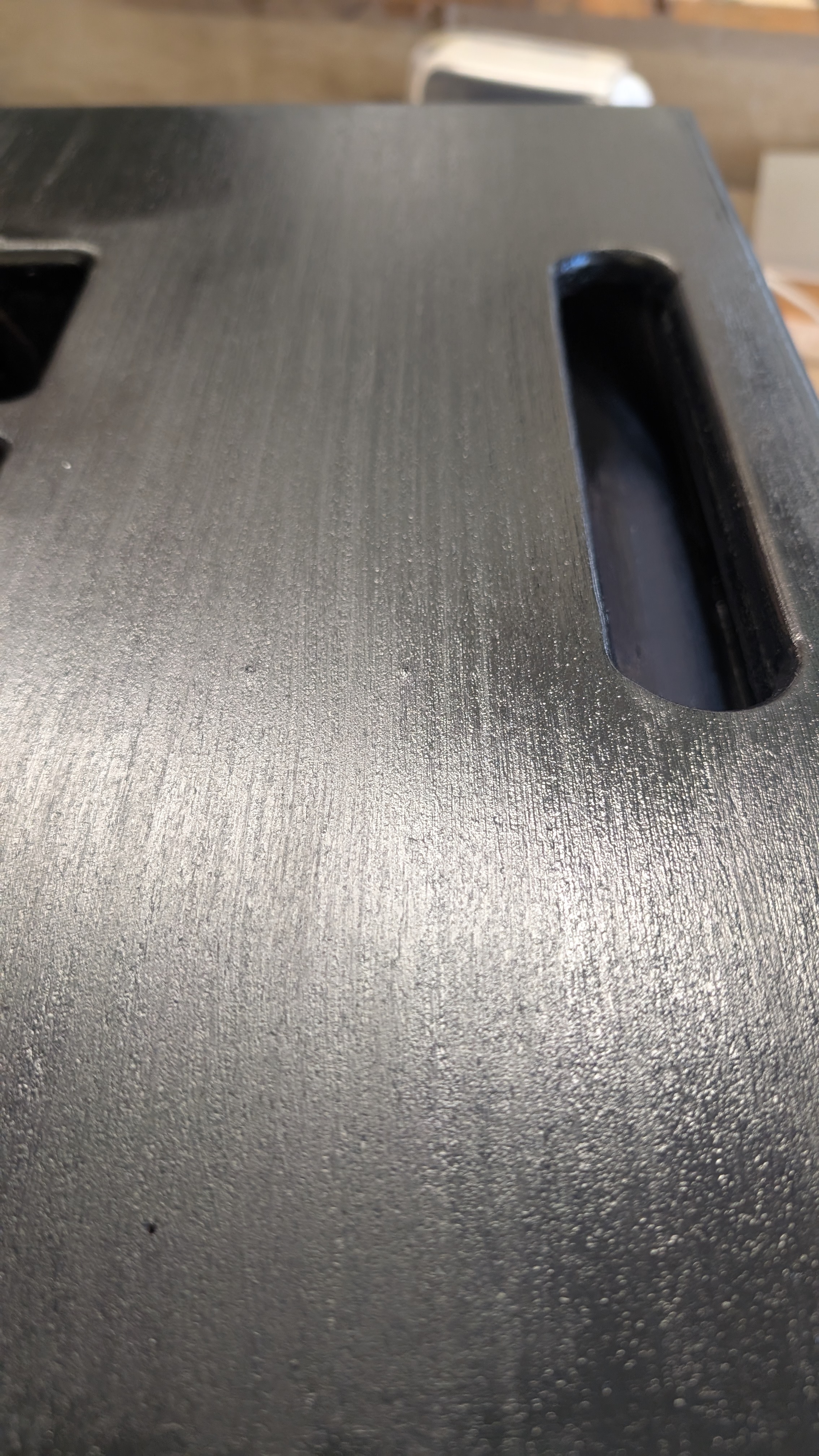

(First damages in the surface already, and the tape around the hf module did squish the middle a little bit out. will see if this sets over time.
The wiring from the rack also done finished, 4 channels in two cables running fine.
The linking also works as intended, both ways.
Will see when the weather gets dry enough, take them outside and measure it and play around there :))

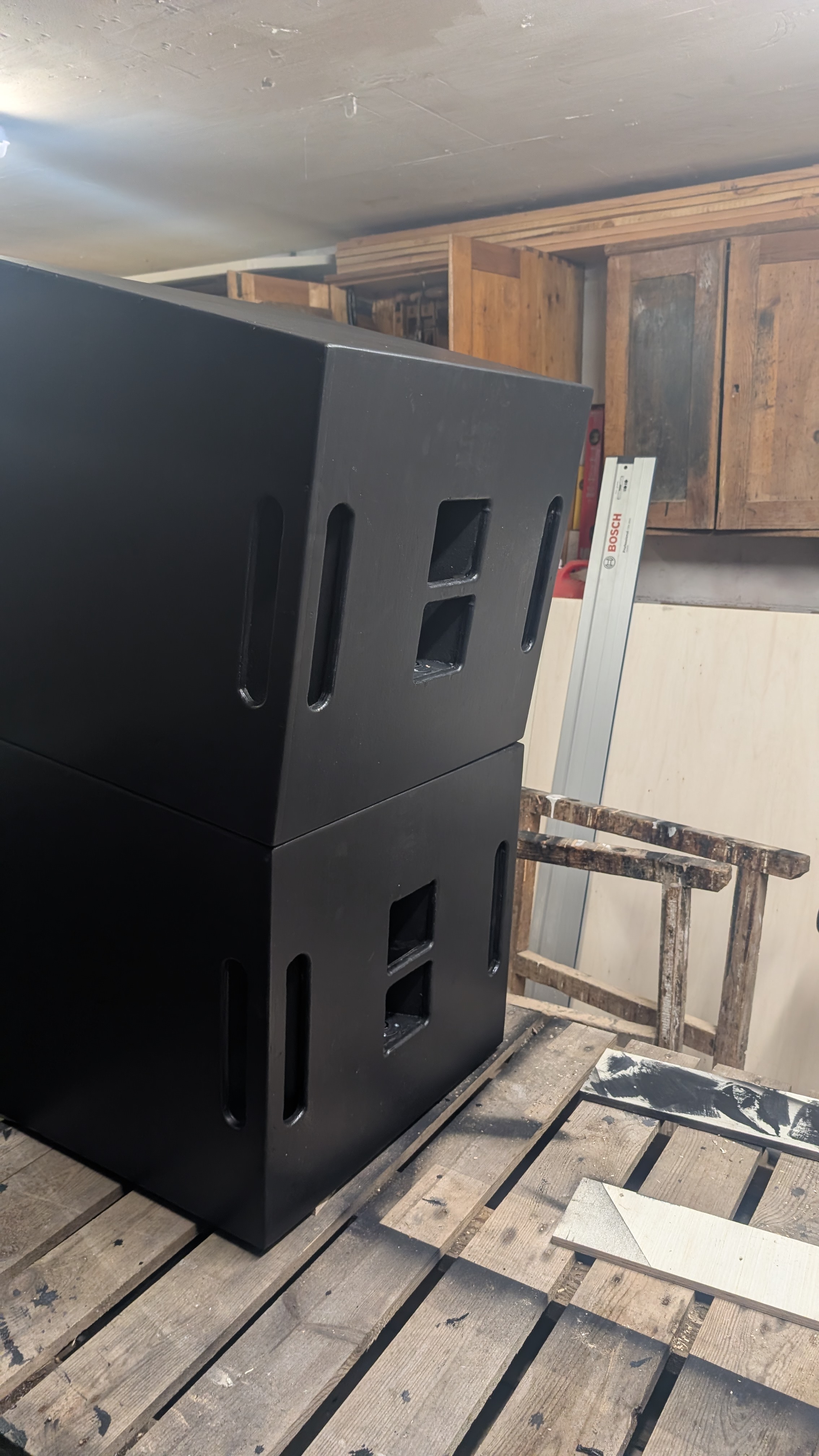

To the wiring inside the handle:
Works as planned; the handling of the connector super easy (even a bit smaller would be possible, but smaller the handle is no more grab-able by my slightly oversized hands)
Happy with that solution :) Will add that to the next pair as well. But the next will be only one 4pole connector i guess

As i dont care about the optics, surface quality is not that high on these two. But it is really doable, just filling and sanding more. I just wanted to have them dark to be not that present, and protect the wood surface. Did one spraypaint-layer (go for the graffitti-spraypaint as this covers way better, and is even cheaper) and then two coats of warnex (=duratex). This is super forgiving material, use it. Had 1kg, used around 2/3 of it for both cabs total inside and outside. I took a brush, will try how spraying does it on the next cabs.
