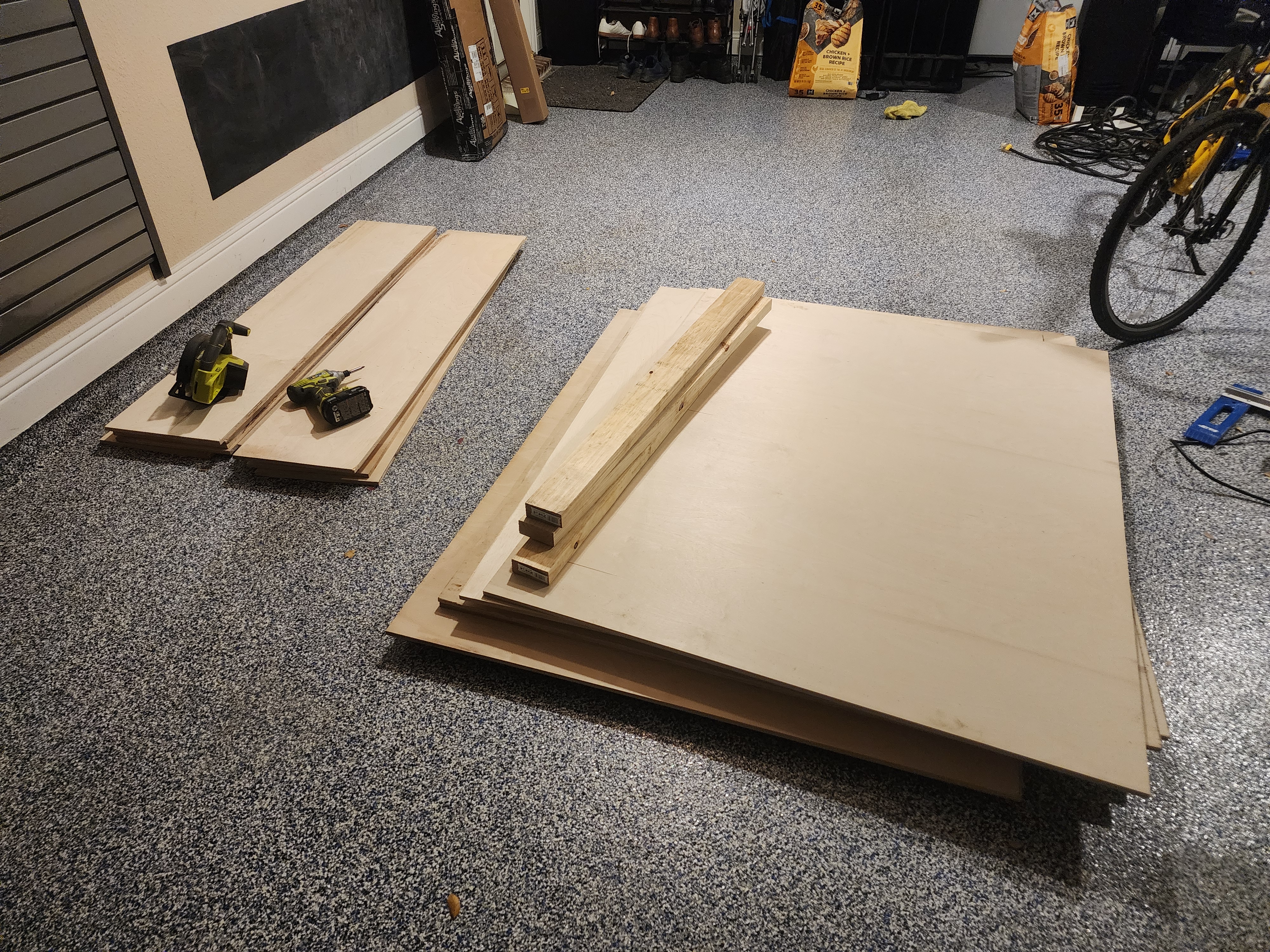

Well team, I was able to procure 10 sheets of 5x5 Russian Birch! Had to cut it down a bit to fit my Suv. Should be enough to build 2xt45 and perhaps a t60.
I used a 24tooth blade and circular saw, cuts weren't perfectly straight and there's some slight tear out. I should be able to clean it up on the table saw with a 60tooth blade.
