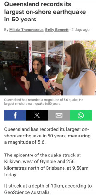

There was an earthquake triggered on Saturday morning when the system was running..
Coincidence.. l think not :)

Having lived in California for most of my life, I've experienced quite a few in my time and I'd say a magnitude 5.6 is about spot on for your system. Well done mate, well done.
