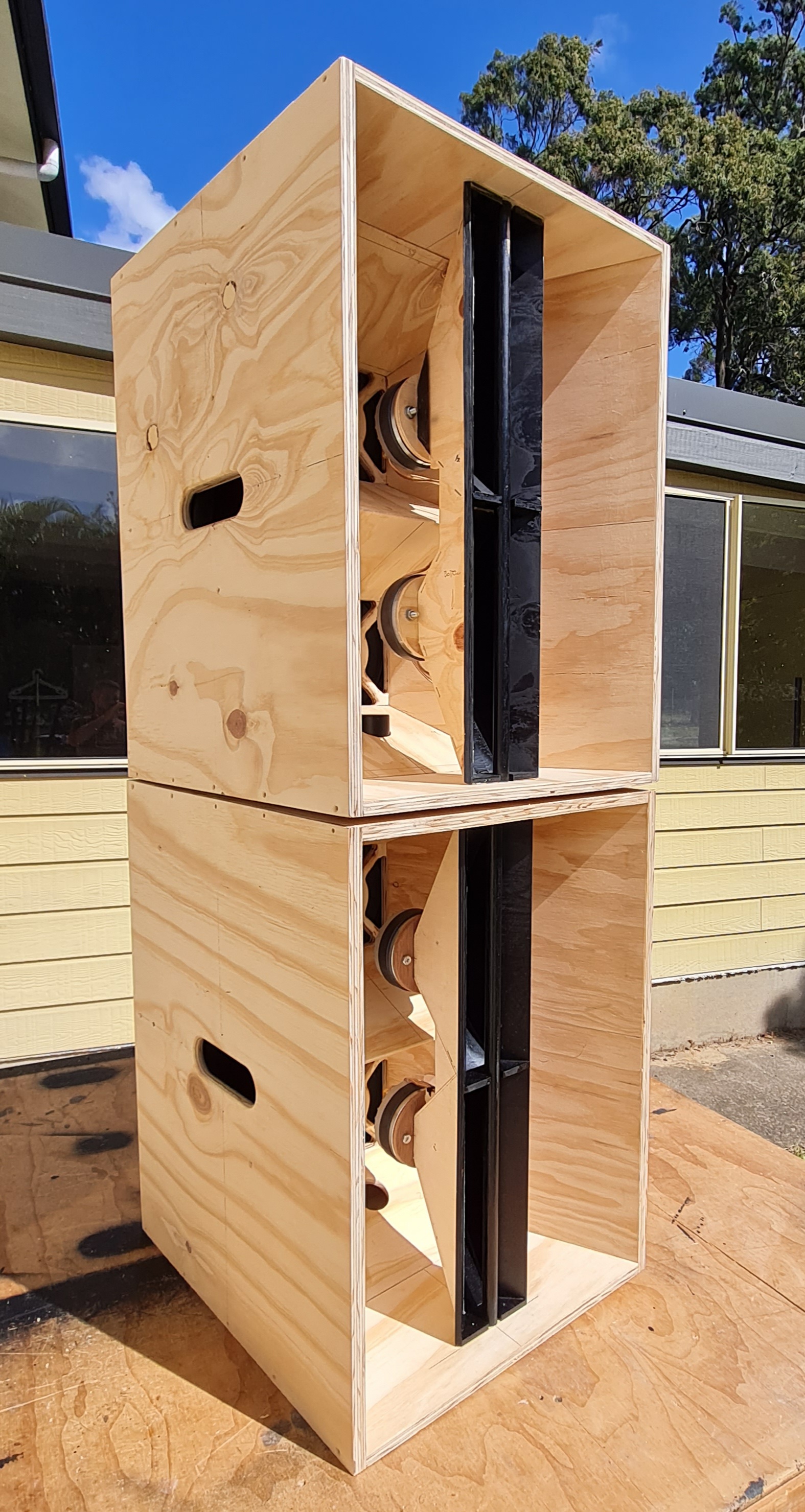

To isolate the 2 circuits, switches were fitted to both + between the filter and drivers, and - between woofer and filter, attached to the woofer baffle accessible through the port so l didn't have to fit and try sealing the switches on the back panel.
You probably wouldn't set out to build 8 OT8s from the start, but l like the narrow height and look when spirally arrayed.
I fitted 8.5" strips to the top of each cab to help stability when set up that way.

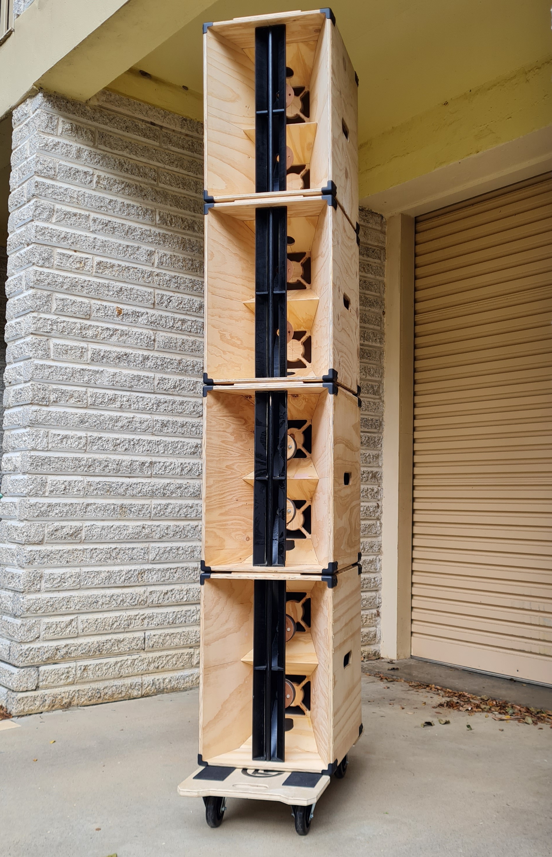

These 4 cabs are ready for paint, l'm trying not to give into the temptation of fitting drivers and wiring to the 2 Bi-amp only cabs to see how they perform, as l've moved into this century with a PA2 and RTA-M, and keen to use it's features!
I just know I'll have to spend more time pulling them apart when it comes to painting..

Keryn O'Shea wrote: Fri Oct 11, 2024 5:35 pm ...l'm trying not to give into the temptation of fitting drivers and wiring to the 2 Bi-amp only cabs to see how they perform, as l've moved into this century with a PA2 and RTA-M, and keen to use it's features!
You're a better man than I am. Ida had those suckers wired up and wailing first chance I got! Your patience and perseverance is admirable. And they're looking darn good Keryn! Well done sir, well done.
Soooo... paint tomorrow and a tuning party Sunday?

That OT8 tower is a thing of beauty Karyn!

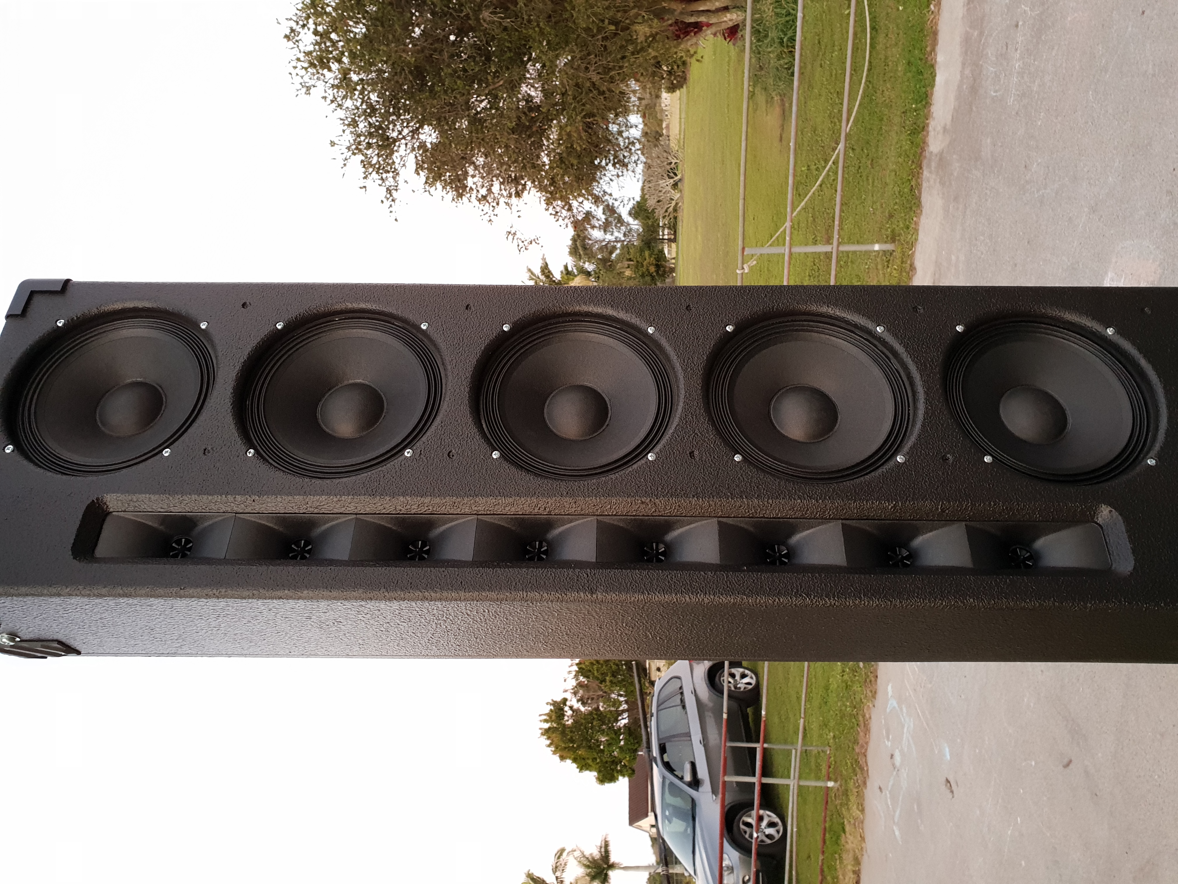

Also would an SLAP trump an OT8 in any way?

Only benefits I can think of for the SLAP is the size and it's really easy to build. Other than that, it takes more amplifier to get to the same SPL, costs more, and doesn't stack as well.
