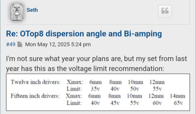

If you know the Xmax of your driver, we can help you with the voltage limit setting.

Yes it is, however if the OP has a driver not listed in the plans, which we now know he does, this table is very helpful..
I have the 2013 plans which don't include this table.
Also if the cabs were bought used, there may be a chance the OP doesn't own plans. And if they don't, it would be best to purchase them.
