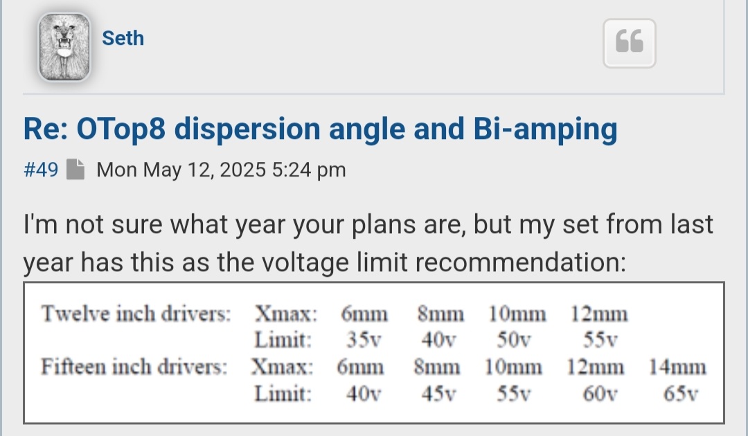

If you know the Xmax of your driver, we can help you with the voltage limit setting.

It's in the plans.Keryn O'Shea wrote: ↑Mon Jul 21, 2025 3:18 pm If you know the Xmax of your driver, we can help you with the voltage limit setting.

9.6mmJmoore wrote: ↑Mon Jul 21, 2025 5:25 pmEminence Kappalite 3015LFKeryn O'Shea wrote: ↑Mon Jul 21, 2025 3:18 pm If you know the Xmax of your driver, we can help you with the voltage limit setting.

Yes it is, however if the OP has a driver not listed in the plans, which we now know he does, this table is very helpful.. I have the 2013 plans which don't include this table.Bill Fitzmaurice wrote: ↑Mon Jul 21, 2025 4:28 pmIt's in the plans.Keryn O'Shea wrote: ↑Mon Jul 21, 2025 3:18 pm If you know the Xmax of your driver, we can help you with the voltage limit setting.
Also if the cabs were bought used, there may be a chance the OP doesn't own plans. And if they don't, it would be best to purchase them.
