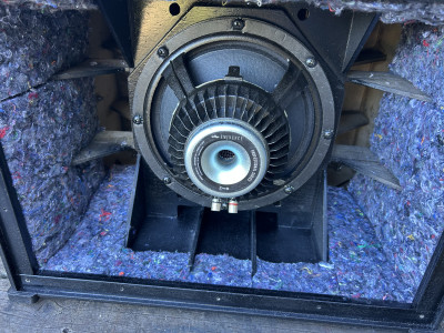

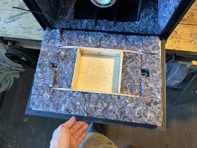

Good progress on the box. Sayisfying trimming the horn sheath to sides joint and giving it a little radius.
Have been mostly able to use 23 Ga. x 1/2" pin nails to hold things in place till PL cures. A few spots needing staples.
Wondering if there's a reason to NOT extend the baffle plane out to meet the side walls with a fill in pair of vertical rectangles? Could be problematic if you wanted to access nuts holding driver in place? This would decrease interior air volume that the speaker worked to compress on the "backstroke" and might increase oututput through the ducts?
Is there likely to be a change in overall tone due to closing off these volumes? It would simplify installing dampening materials at the end.

If you change those volumes it raises the tuning of the cabinet. You don't want that.

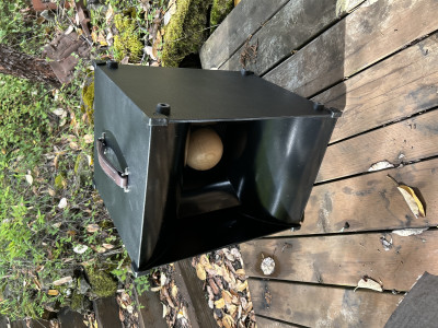

Wrappped up build. Sounds great with an emminence 2510.
Overall 22#. Used semi gloss spray on unside of horn and rest of external surfaces got 3 coats Exohyde texture paint.
Machined some corner bumpers from hdpe on cnc router.
