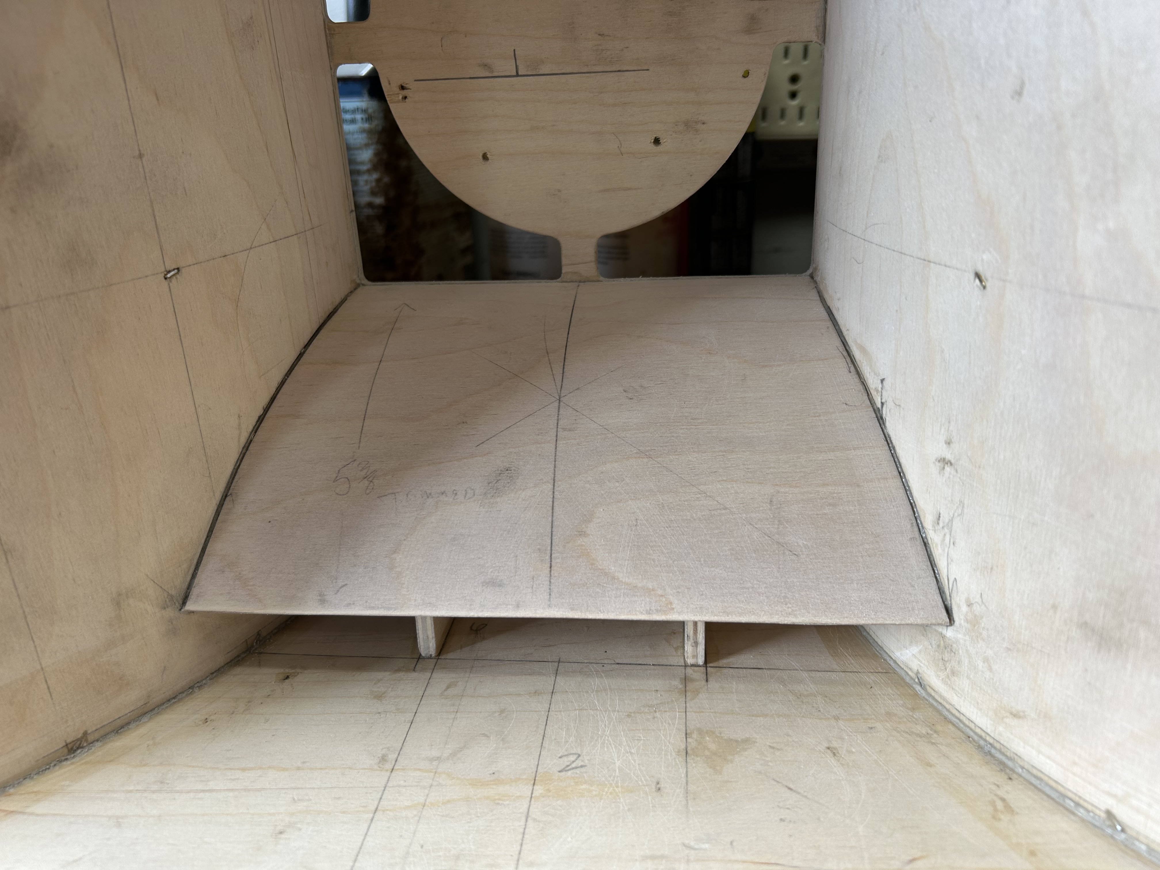

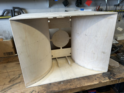

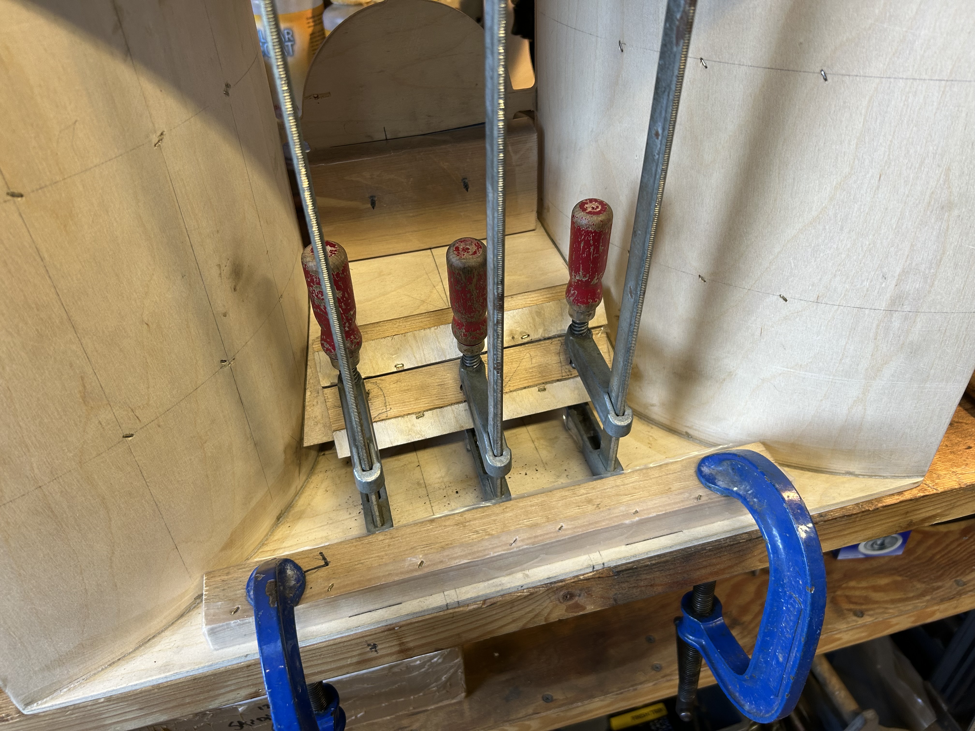

Good progress on the box. Sayisfying trimming the horn sheath to sides joint and giving it a little radius.
Have been mostly able to use 23 Ga. x 1/2" pin nails to hold things in place till PL cures. A few spots needing staples.

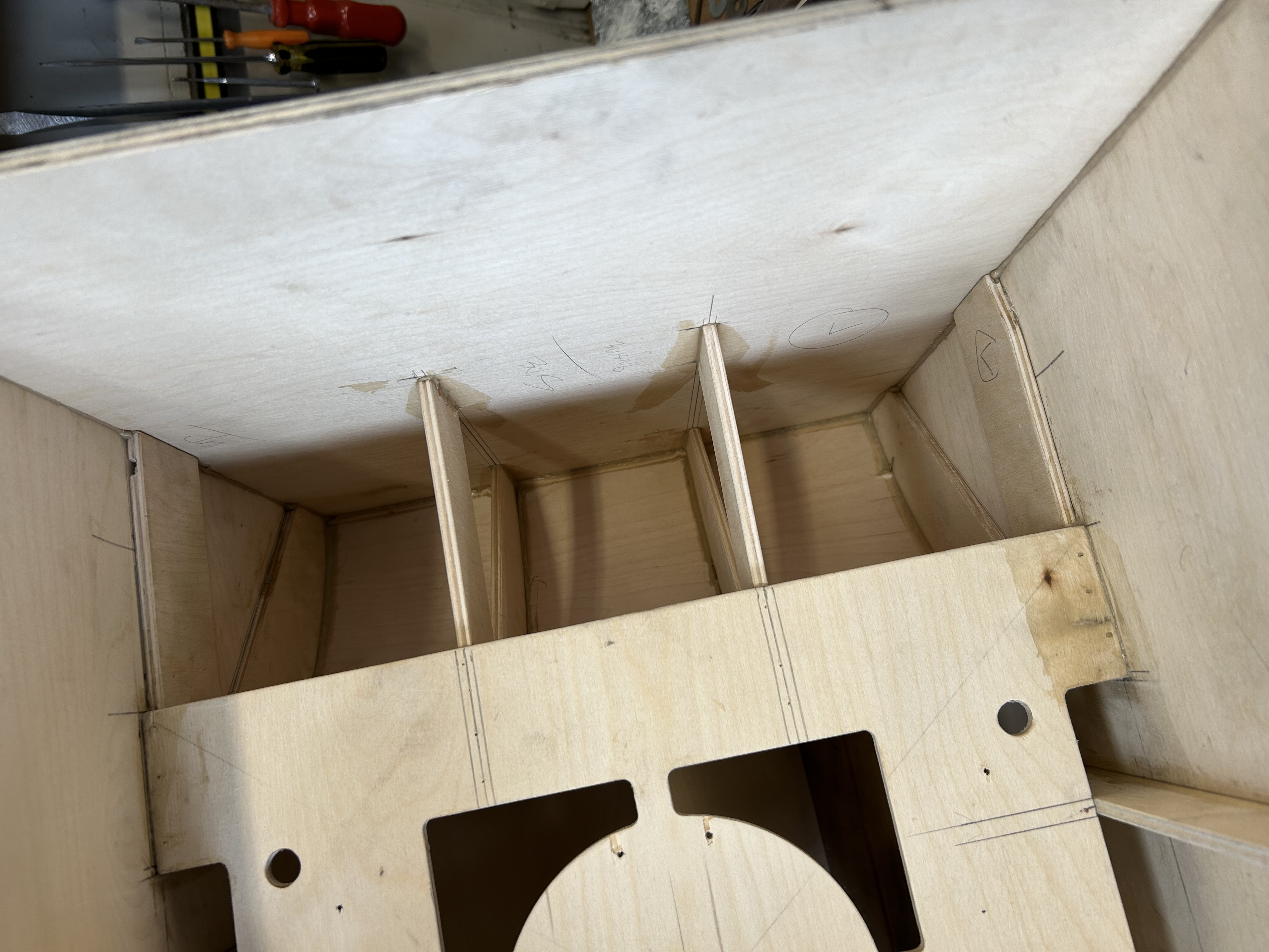

Wondering if there's a reason to NOT extend the baffle plane out to meet the side walls with a fill in pair of vertical rectangles? Could be problematic if you wanted to access nuts holding driver in place? This would decrease interior air volume that the speaker worked to compress on the "backstroke" and might increase oututput through the ducts?
Is there likely to be a change in overall tone due to closing off these volumes? It would simplify installing dampening materials at the end.
Good fun overall and the whole structure stiffens up nicely. I can just feel what it will be like to grab the leather top handle. Thinking lots about what corner protectors to use.
Thanks Bill.....

#34 Post by AndrewMoore »
pictures
Keryn O'Shea

Reposting to hopefully get Bill's take on the possibility:
"Wondering if there's a reason to NOT extend the baffle plane out to meet the side walls with a fill in pair of vertical rectangles? Could be problematic if you wanted to access nuts holding driver in place? This would decrease interior air volume that the speaker worked to compress on the "backstroke" and might increase oututput through the ducts?
Is there likely to be a change in overall tone due to closing off these volumes? It would simplify installing dampening materials at the end."
Thanks, Andrew
Posts: 29112
Re: Navigator Jack 10L Build
#39 Post by Bill Fitzmaurice »
If you change those volumes it raises the tuning of the cabinet. You don't want that.

That duct sheath took some force to get bent into position even with making sure I had the bend bias going in the right
direction. Was able though to clamp it like horn sheath and did not need to add staples.

I used clamps and staples, just to be sure.

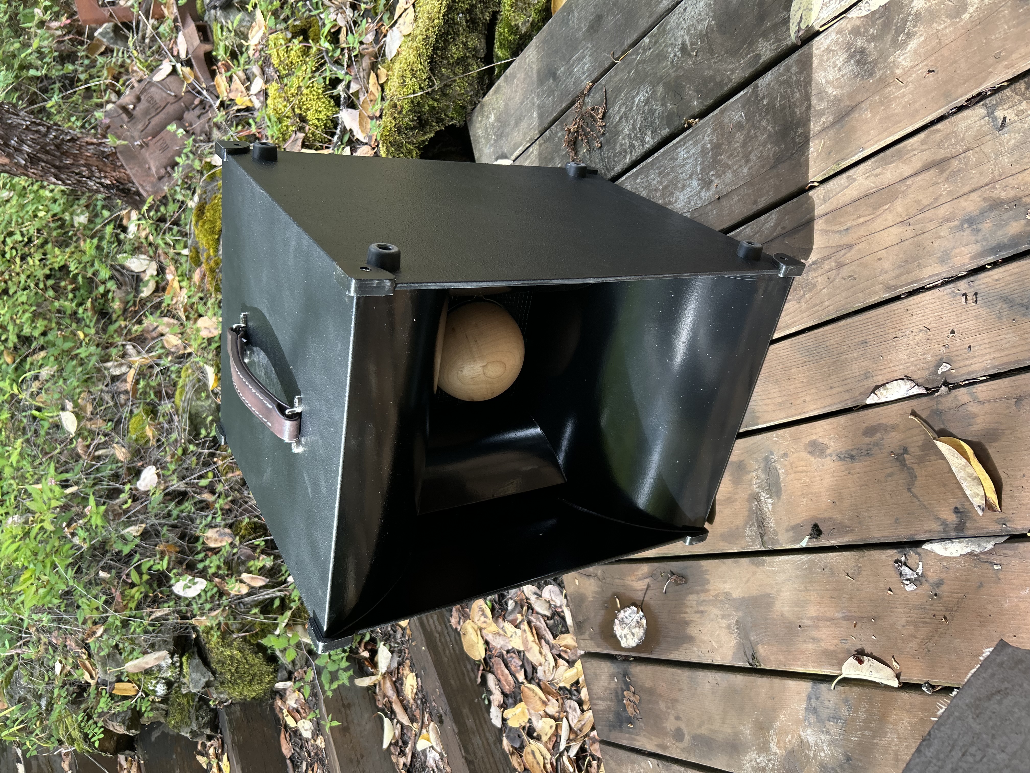

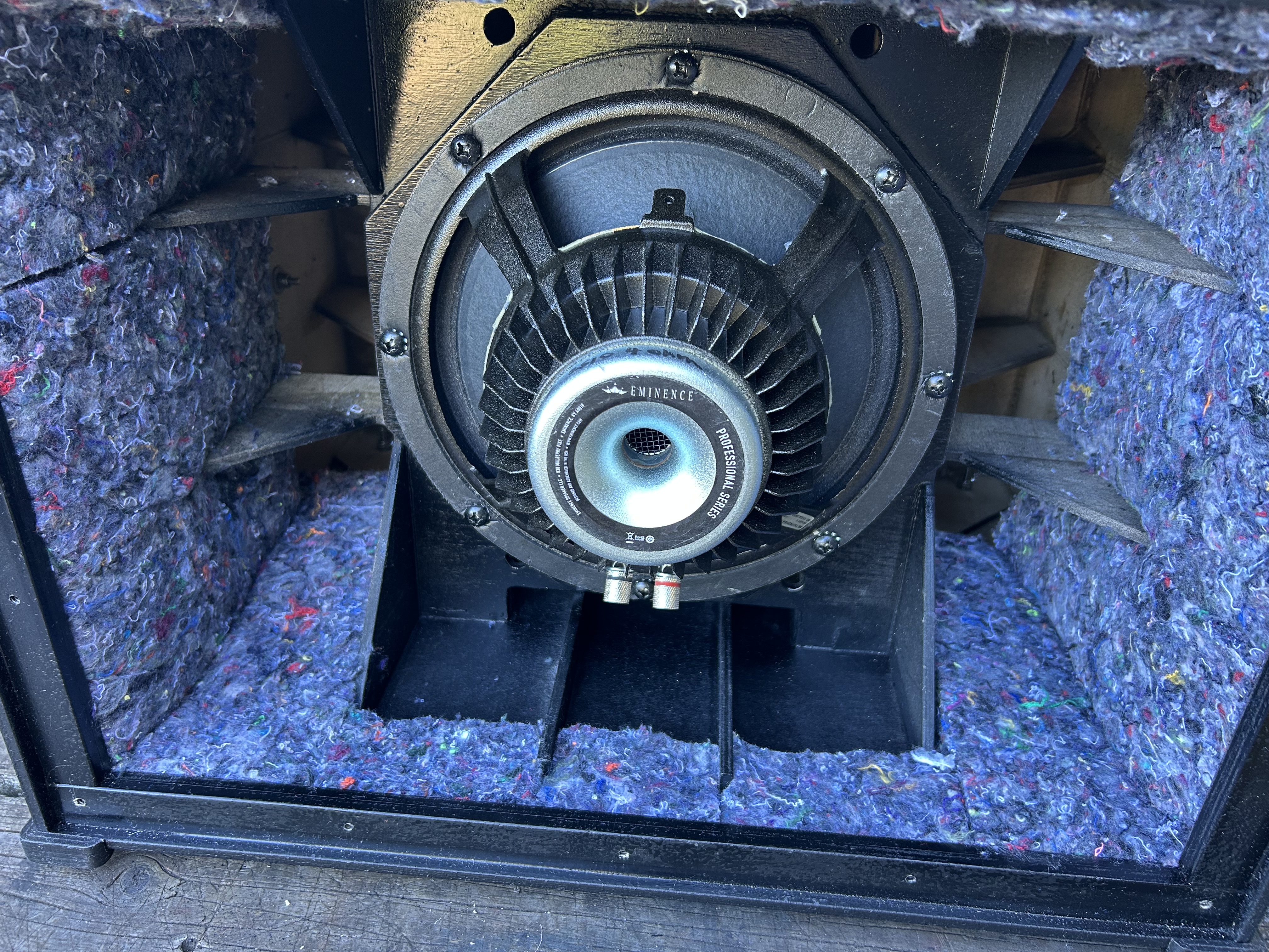

Wrappped up build. Sounds great with an emminence 2510.
Overall 22#. Used semi gloss spray on unside of horn and rest of external surfaces got 3 coats Exohyde texture paint.
Machined some corner bumpers from hdpe on cnc router.
