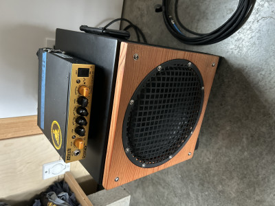

to see what the other half of the rhythm section was all about. Settled on a G&L short scale with flats. Bought a small Markbass Nano amp and got creative salvaging a home stereo Martin Logan subwoofer cube. Pulled out the dead electronics and swapped the metal cone 10" driver for an
Emminence Deltalite 2510 ( 4 ohm darn). Works pretty good as a practice set up. But now time to up the cabinet situation. A 110 Jack lite seems a good starting point. Baltic delivering today.
