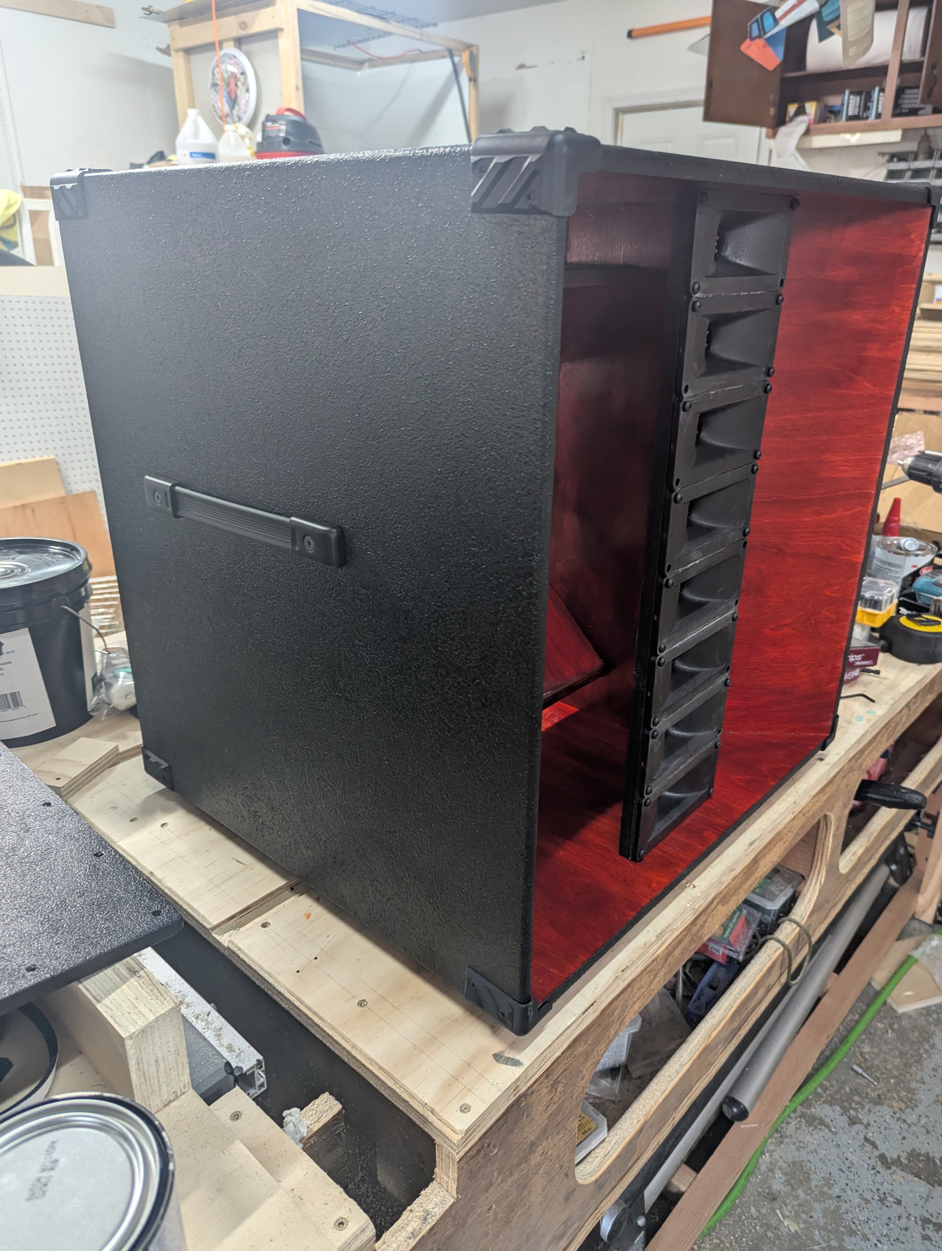

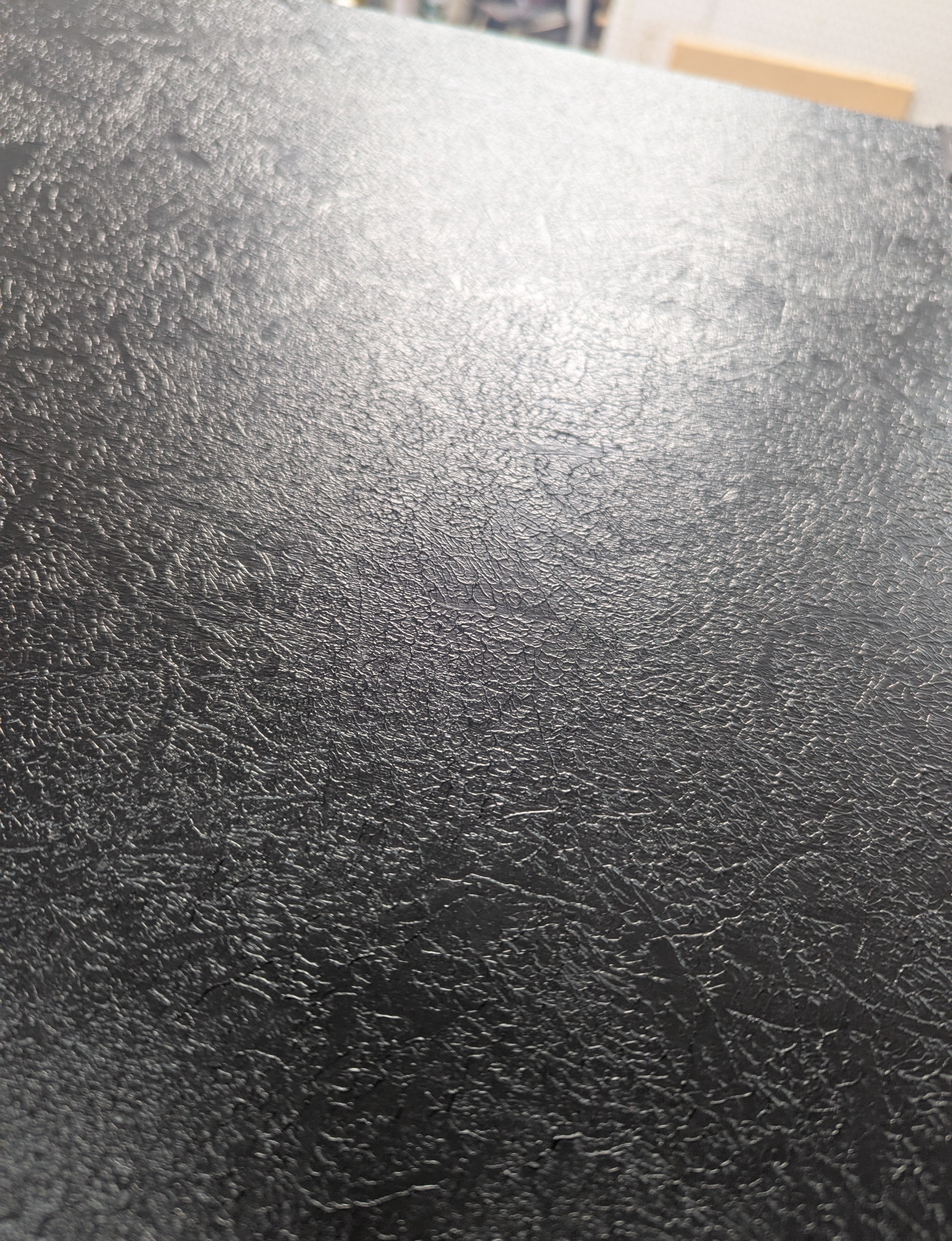

Gave it one Duratex coat with the foam texture roller, let it dry a couple hours, then gave it a second coat and blotted it with a plastic bag to give it a bit of a faux leather type texture. I wasn't super excited by the roller texture.
Attached the corners and handles this morning. Next up is foam inside, gasket for the back, and then the wiring.

I like that faux leather plastic bag look. Great job!

Aaron315 wrote: Mon Jul 14, 2025 8:39 am Gave it one Duratex coat with the foam texture roller, let it dry a couple hours, then gave it a second coat and blotted it with a plastic bag to give it a bit of a faux leather type texture. I wasn't super excited by the roller texture.
I've always used the textured rollers that I bought from Leland at Speakerhardware years ago. If you don't like the sharp points, then lightly go back over it with just the weight of the roller....it will give it a really nice pebbled texture and looks just like a store-bought cab.
Those are the ones I used. It was definitely too rough for my liking...felt a bit like sandpaper. I'm really happy with this faux leather look.

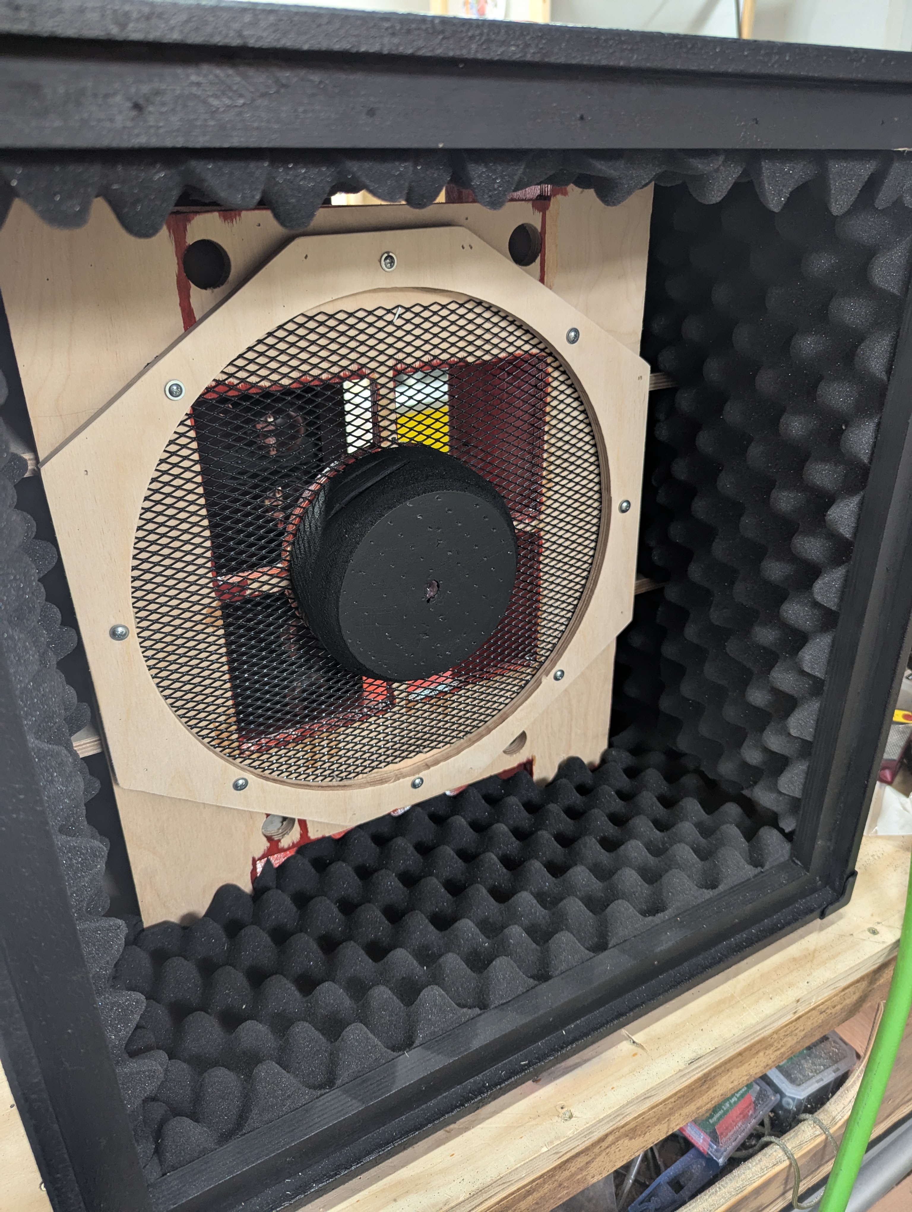

Got the foam glued and stapled. I haven't decided where I want to mount the crossover so that bottom piece of foam isn't attached yet.
Where do most people attach it? Inside the cab on the bottom? Or attached to the back panel?

Aaron315 wrote: Mon Jul 14, 2025 2:25 pm Those are the ones I used. It was definitely too rough for my liking...felt a bit like sandpaper. I'm really happy with this faux leather look.
Yep, if you don't go back over it - dry-rolling it very lightly with just the weight of the roller - it will definitely feel like sandpaper. Your finish looks good....and if you're happy, that's all that matters.

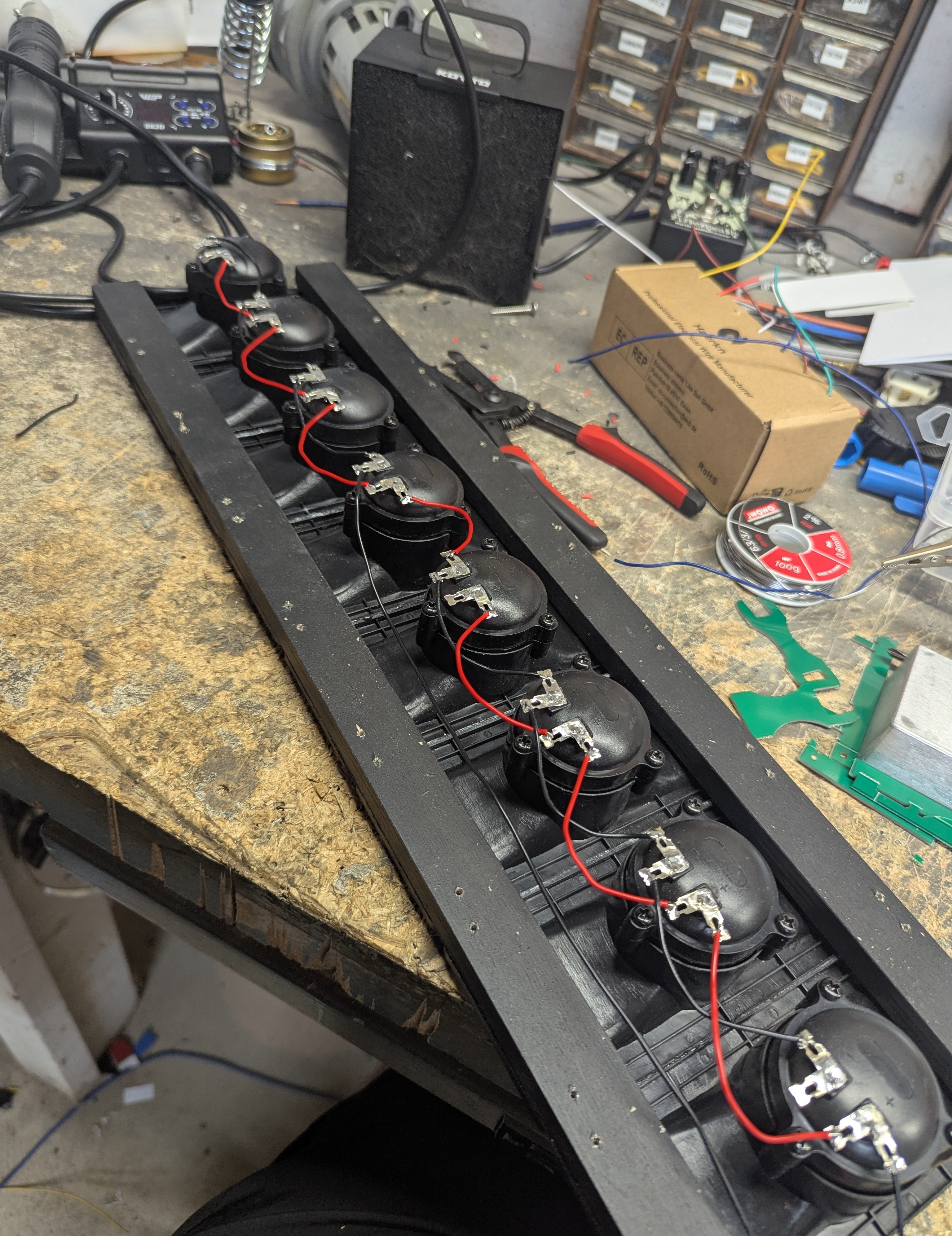

Had a bunch of 22 gauge wire on hand from tinkering around with guitar pedals so I used that for the piezo array.

I decided to mount it inside the cab on the bottom. I was originally thinking about mounting it on the back panel closer to the jacks but decided it didn't make sense to have additional weight on the back panel and be fighting gravity.
