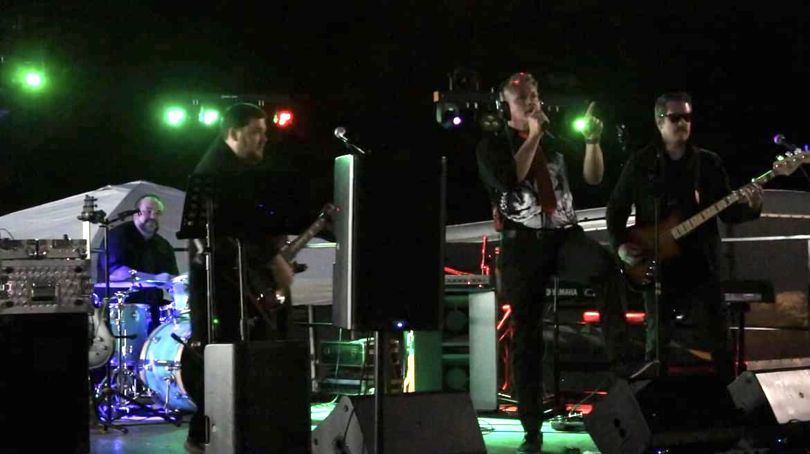

Got a chance to try out the Jack 210 at a live show last night.
It was actually my first live gig since 2001.
Some friends of mine and I set up a festival to raise money for our town of Spruce Pine to deal with the aftermath of Hurricane Helene and we were the final act.
I was running a my Squier vintage modified JB into an HX stomp with LA compressor and Ampeg B15 blocks, out of the stomp I split to the PA and my ancient GK 400RB into the Jack 210.
My band uses IEM’s and I didn’t technically need the amp and cab on stage but I liked the extra feel and folks said it sounded really good overall.
It must have been doing something right because I had one of the other bass players from earlier in the day come up and grill me about my setup and the cab I was using afterwards.
I’m really happy with the setup and how it worked out last night.

My band was the entertainment for our town’s Independance day celebration.
At most of our smaller shows I go direct from my helix into the PA but this outdoor show I had decided to bring the Jack210.
I was initially worried about being too loud and told our sound guy to let me know if I needed to turn down.
After about the second song he came over and said he was running out of headroom on the subs and could I turn my amp way up.
I cranked the volume on the XLS1002 and let the limiter do its thing.
For the next hour and forty five minutes the 210 happily blasted away behind me.
I had several folks after the show come up and tell me it sounded pretty good once I turned up.
Almost a year in and I’m still very happy with the Jack210.
And yes, we will be using a bigger PA the next time we play a big outside show.
