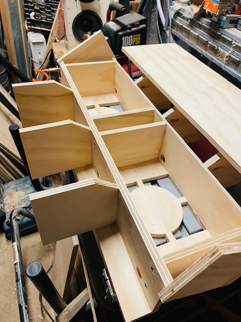

I built a Jack 210 last week.
I used some Chinese Eminence neo drivers that I picked up really cheap from parts express a while back as the specs seemed to be within the recommended range.
So far I’m really enjoying the sound.
I should get a chance to try it out at band practice this weekend and see if it can do a better job of keeping up with our drummer than the Markbass combo amp we had in our practice space.
I still haven’t decided on a finish for the cab.
I wanted to play it for a bit and make sure it didn’t fall apart or have any leaks before I got some finish on it.

A while back I did run some EQ sweeps on the cab with REW and my UMIK.
I ended up plugging the center port with a piece of pipe insulation foam and added some pieces of pool noodle inside the back of the cab to reduce the internal volume slightly to tune things better to the drivers I used since they were spec’d with a smaller Vas than the recommended drivers.
After doing so the response flattened out a little and I’ve been very happy with the sound.
Posts: 28916
Re: Josh’s Jack 210
#7 Post by Bill Fitzmaurice »
Regarding plugging the port that will lower the cab tuned frequency, which may or may not be a good thing. Reducing the port area also raises the port velocity, which may cause chuffing. Of course what matters is the end result, so it it works it's all good. If you get chuffing you can extend the port depth to lower the tuning and reduce the rear chamber volume.
