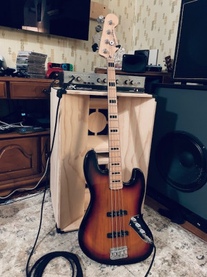

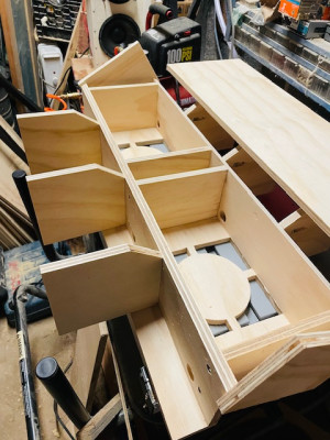

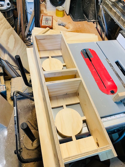

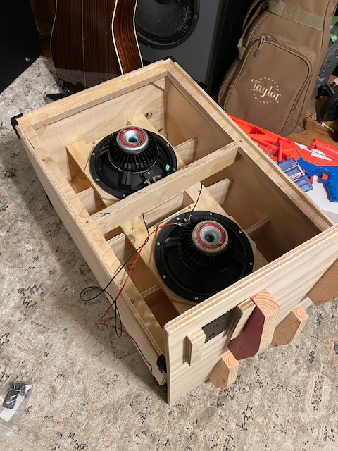

I built a Jack 210 last week.
I used some Chinese Eminence neo drivers that I picked up really cheap from parts express a while back as the specs seemed to be within the recommended range.
So far I’m really enjoying the sound.
I should get a chance to try it out at band practice this weekend and see if it can do a better job of keeping up with our drummer than the Markbass combo amp we had in our practice space.
I still haven’t decided on a finish for the cab.
I wanted to play it for a bit and make sure it didn’t fall apart or have any leaks before I got some finish on it.

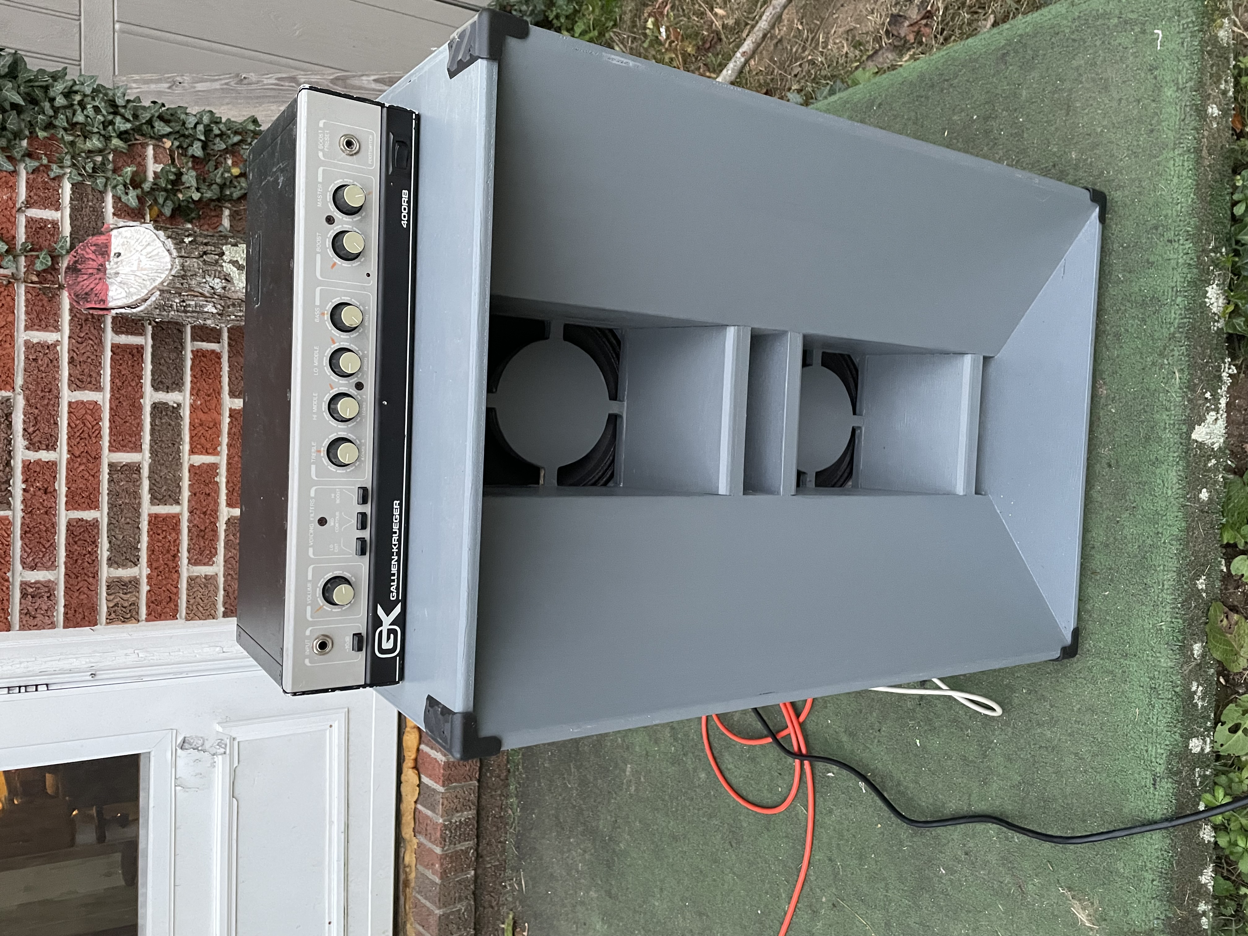

The guy playing bass for the opening act played through my rig, the GK 400RB into the Jack 210, so I got a chance to see how it sounded throughout the bar.
It had a nice punch to it and you could actually hear the individual notes, even when around the corner at the far end of the bar.
Once again I had some of the other bass players come up and ask what kind of cab I was using and compliment me on my sound.
The guys in my band were happy with it as well.
A while back I did run some EQ sweeps on the cab with REW and my UMIK.
I ended up plugging the center port with a piece of pipe insulation foam and added some pieces of pool noodle inside the back of the cab to reduce the internal volume slightly to tune things better to the drivers I used since they were spec’d with a smaller Vas than the recommended drivers.
After doing so the response flattened out a little and I’ve been very happy with the sound.
