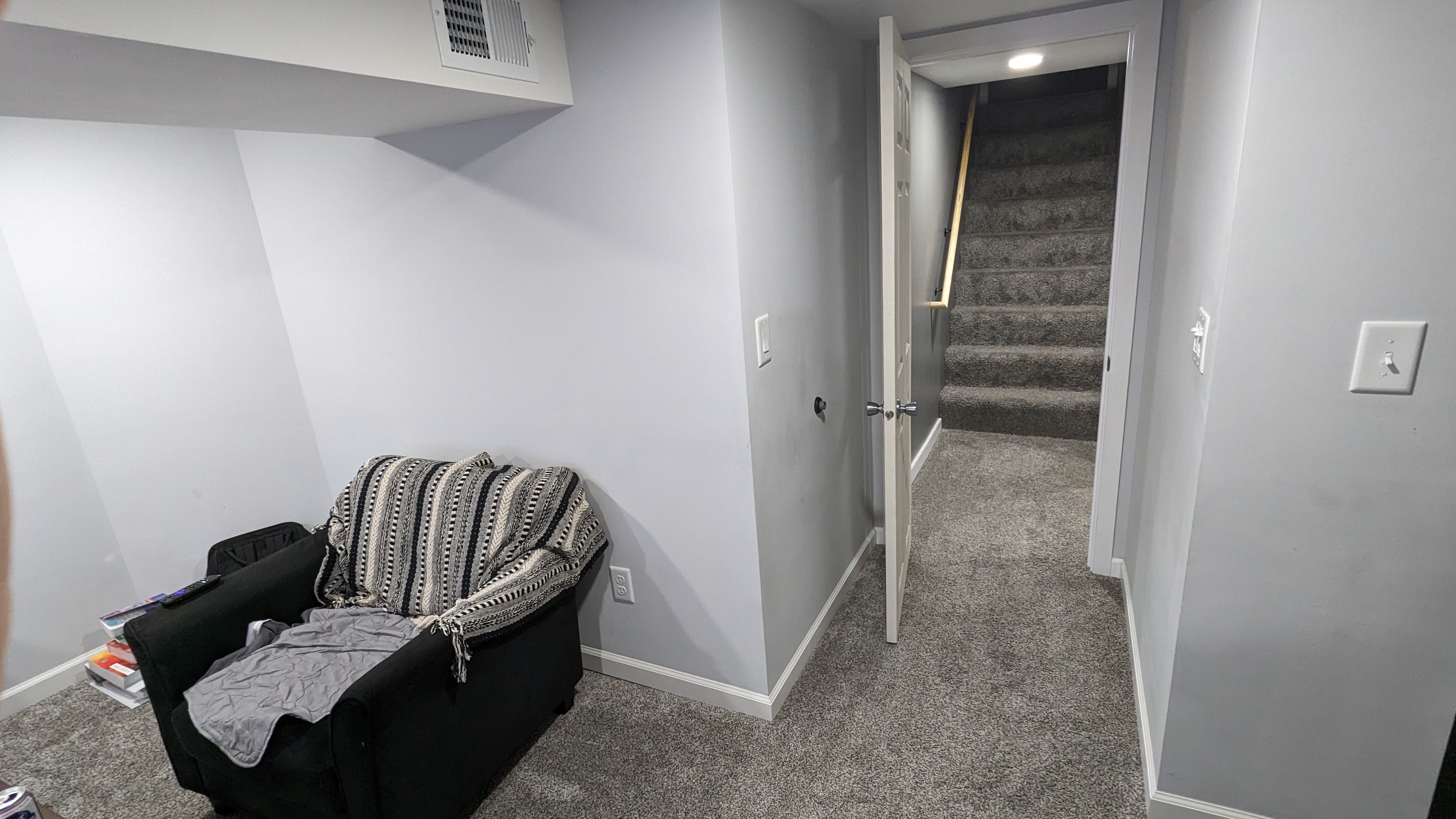

Definitely test first. Move the sub left and right along the wall, run your test track, and walk around the room listening for the most even coverage throughout the space while giving priority to your primary listening position. Move it and test it a bunch of times. You may find a couple inches one way or the other with the sub position might make a large difference of how it sounds in the room. So, take your time and focus on the sound, NOT where a hole will look best on the wall. My guess is it will sound best as close to the 45º corner on the left as possible or even firing into the nook with the door on the right, through the wall from behind the door in this pic.

Flip the sub over so the mouth is nearer the floor or lay the sub on it's side. If it were me, I'd only cut the hole in the drywall the dimensions of the mouth, leaving any studs in place, case and frame the hole. Maybe stretch some grill cloth over an insert and stick it in the hole to hide any unsightly-ness with studs and whatnot. That way, it's really easy to undo. A little plug, patch, putty, texture, and paint 'n you're all back to a normal looking wall again.

Sounds good. Thank you sir. I did see you mentioned that previously, but just wanted to make sure I read it right lolBill Fitzmaurice wrote: ↑Sat Dec 02, 2023 5:42 pm You can test it by aiming the sub mouth at the wall from a foot away. It will give the same in room response as flush mounting in the wall. Once in the wall anything in front of it will have no effect on the sound. Fourteen foot wavelengths go around obstacles. But anything in front of it will probably vibrate.

That's the way I've always had it with the sub mouth on the floor, but in that particular position it actually sounded better with the mouth up...Seth wrote: ↑Sat Dec 02, 2023 7:43 pm Flip the sub over so the mouth is nearer the floor or lay the sub on it's side. If it were me, I'd only cut the hole in the drywall the dimensions of the mouth, leaving any studs in place, case and frame the hole. Maybe stretch some grill cloth over an insert and stick it in the hole to hide any unsightly-ness with studs and whatnot. That way, it's really easy to undo. A little plug, patch, putty, texture, and paint 'n you're all back to a normal looking wall again.

I will definitely only be cutting a hole in the wall where the mouth is.

That little nook you're talking about is just the entry way into the bedroom.. oddly enough, that's where the sub sounds the loudest when I'm walking around the room and I'm sure it's just because I'm in that little cubby. But man if I could get the whole room to sound like that or even the listening position I would be ecstatic.... Unfortunately that opening is about the same width of the sub, so it'd be really hard to push the sub over there and do some testing on it
Please don't mind our crappy Walmart chair lol. Waiting for our chase couch to get here, but I'm impatient and need my AV / bass fix

Try doing the Sub Crawl. You very well may luck out and find that location is a good location. It looks to me as though it could be. Place the subwoofer at the primary listening position in the room, play a track or several tracks that has many bass frequencies, play some test tones too, get on your hands and knees, and crawl around the perimeter of the room listening for locations that are louder. Placing the subwoofer in those locations is very likely to sound amazing at your primary listening position.Comatoast wrote: ↑Sun Dec 03, 2023 3:54 pm That little nook you're talking about is just the entry way into the bedroom.. oddly enough, that's where the sub sounds the loudest when I'm walking around the room and I'm sure it's just because I'm in that little cubby. But man if I could get the whole room to sound like that or even the listening position I would be ecstatic.... Unfortunately that opening is about the same width of the sub, so it'd be really hard to push the sub over there and do some testing on it
Play music and test tones. Frequency response in the room will change with frequency. Take written notes and choose a location with the best compromise of frequency response.Any particular track or test tone or YouTube video that you guys use for finding the exact placement where it should go and for room listening? Or just play a 30 hz test tone and see where it sounds best?

I'll do the sub crawl.... Again lol.. so when the tht is at the MLP should the mouth be firing against the wall, or in room?

If you put the mouth roughly where your head would be, you'll get the best results. Doesn't matter which direction the mouth is facing.
