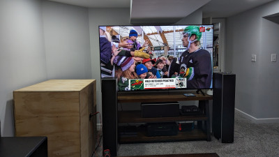

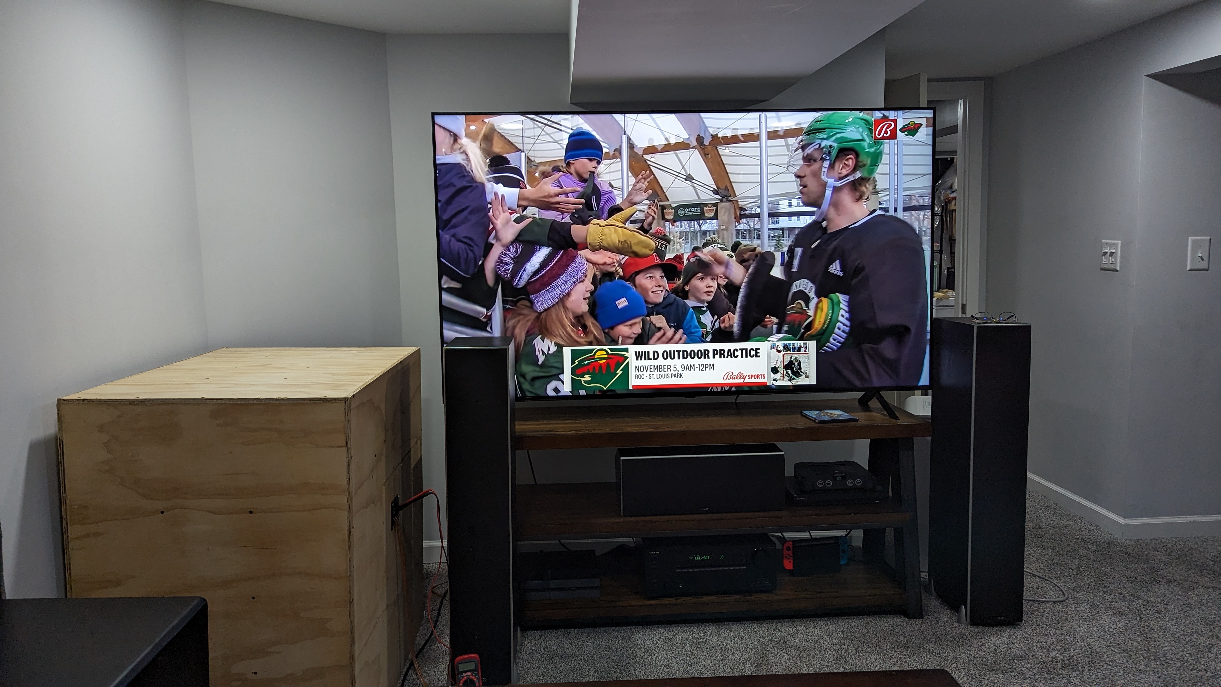

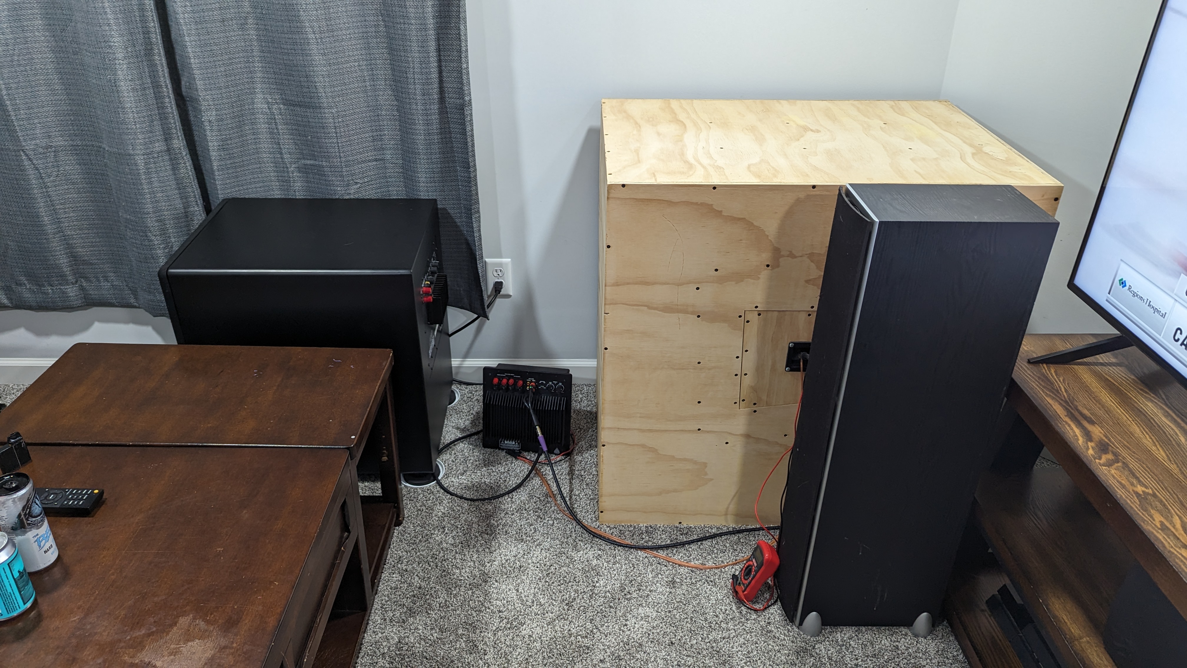

So I built this thing around 12 years ago. And 2 years ago I put it in storage because I didn't have any space to put it. I just pulled it out of storage last week and have not done any calibration, or room correction and it's still just kind of sitting where my old sub sat ( HSU vtf3 mk5 )
It's a small area.. I remodeled our basement into our bedroom one. Half of it is our bedroom. The other small portion is my " mini man cave " lol..

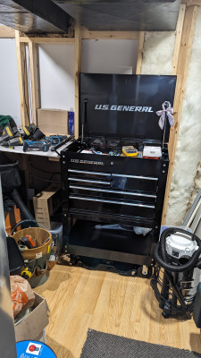

I've always had this sub corner loaded but I'm just curious as to what happened if I were to fire it directly into the room... It sounds like a simple thing, but it would actually mean cutting open the wall in the theater room and putting the sub behind the wall in an open area .... But it would not be corner loaded, but be firing behind my TV , into the room ..
The mouth would be firing through the wall behind the TV
The enclosure would be right around where the black toolbox is

Basically what I want to do is put the enclosure behind the wall, but cut a opening in my room where the mouth will fire into, and as long as I seal it off good it should work...
I've just never fired this into an open area. Always been corner loaded..
I don't have any issues with trying things, but would suck to customize the sub into the back area ( furnace area ) then cut open a big hole in the perfectly good wall ( that will be trimmed out , more than likely with an acoustic transparent mesh ) just to have it not perform to its full potential

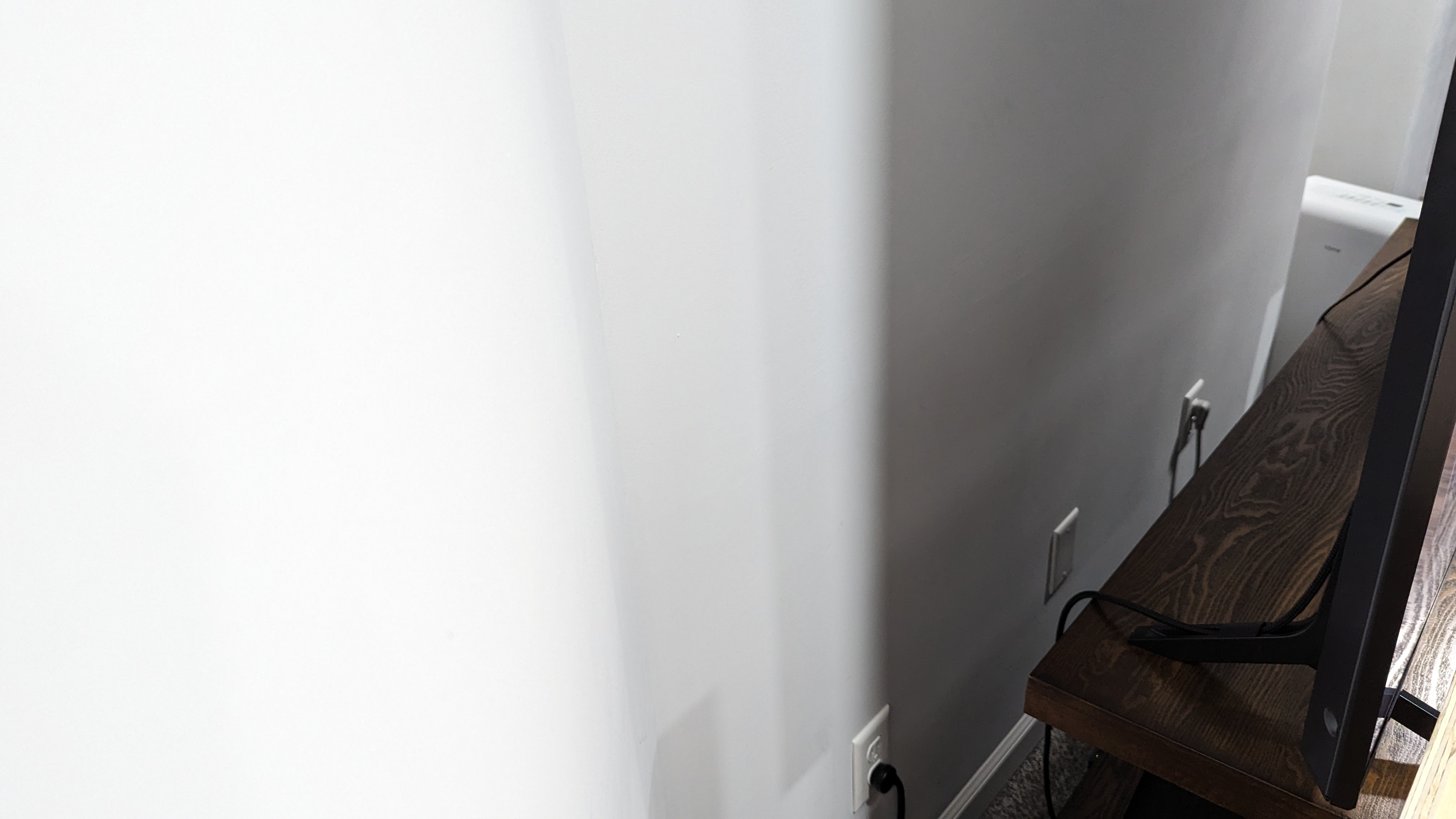

Ahh gotcha. Here's a vid during the remodel... It's a bedroom/ away from the kids room lol
But shows the layout. The TV is not on the opposite wall. Where the bookshelf speakers are sitting
