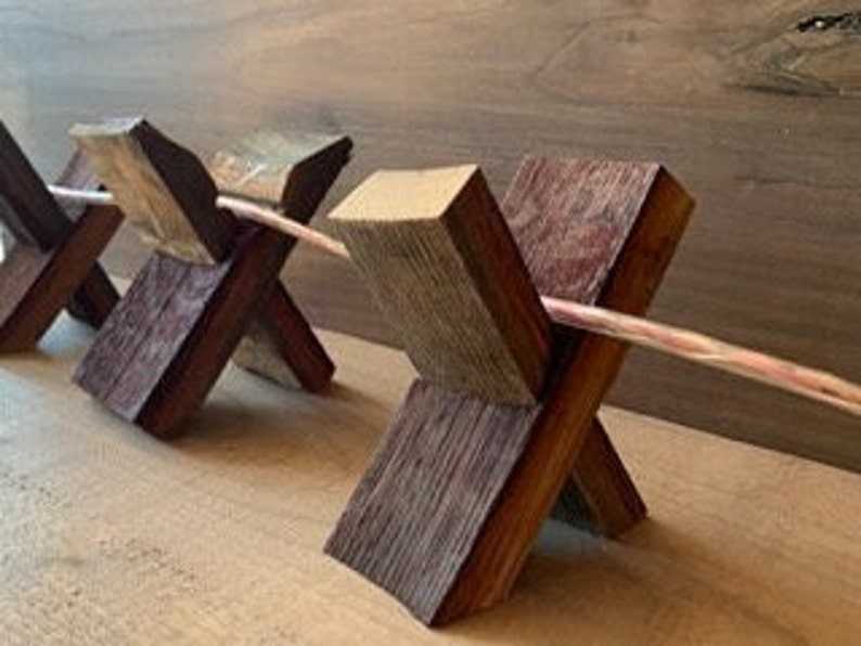

As long as we've gone down the snake oil rabbit hole: how BS are speaker cable risers? (Allegedly eliminate static charge from interference from carpeting.)
Posts: 28966
Re: High priced Hifi cabling
If you believe they do anything I'd like to speak to you about Bernard L. Madoff Investment Securities. :noob:
Lifting speaker cables off a damp concrete floor or wet ground outdoors has value, as they can suffer capacitive losses. But static charge from a rug? Rugs don't hold static charge. Objects that are rubbed against a rug can acquire a static charge, but even if you did so with a speaker cable it wouldn't affect the sound, since static charges are DC, not AC.
