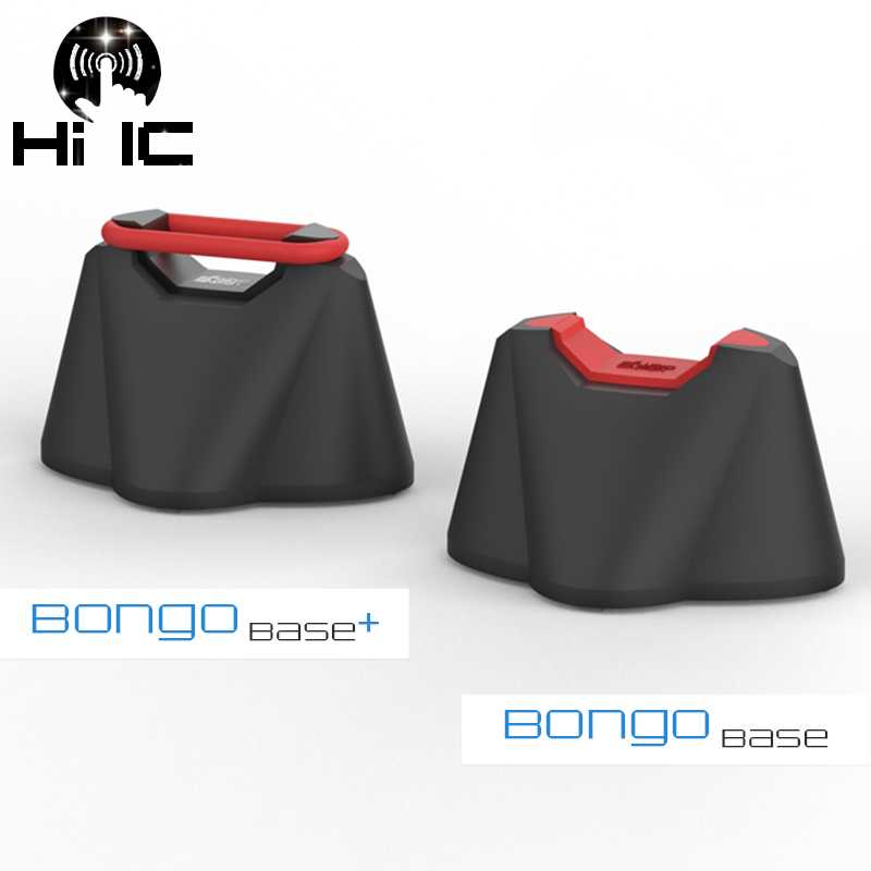

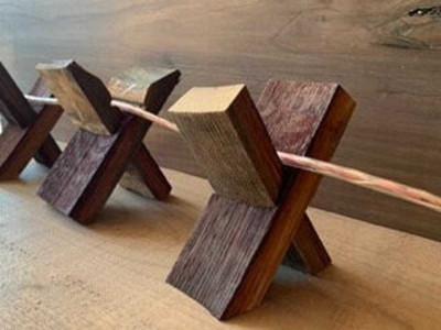

As long as we've gone down the snake oil rabbit hole: how BS are speaker cable risers? (Allegedly eliminate static charge from interference from carpeting.)
- Posts: 29093
Re: High priced Hifi cabling
If you believe they do anything I'd like to speak to you about Bernard L. Madoff Investment Securities.
Lifting speaker cables off a damp concrete floor or wet ground outdoors has value, as they can suffer capacitive losses. But static charge from a rug? Rugs don't hold static charge. Objects that are rubbed against a rug can acquire a static charge, but even if you did so with a speaker cable it wouldn't affect the sound, since static charges are DC, not AC.

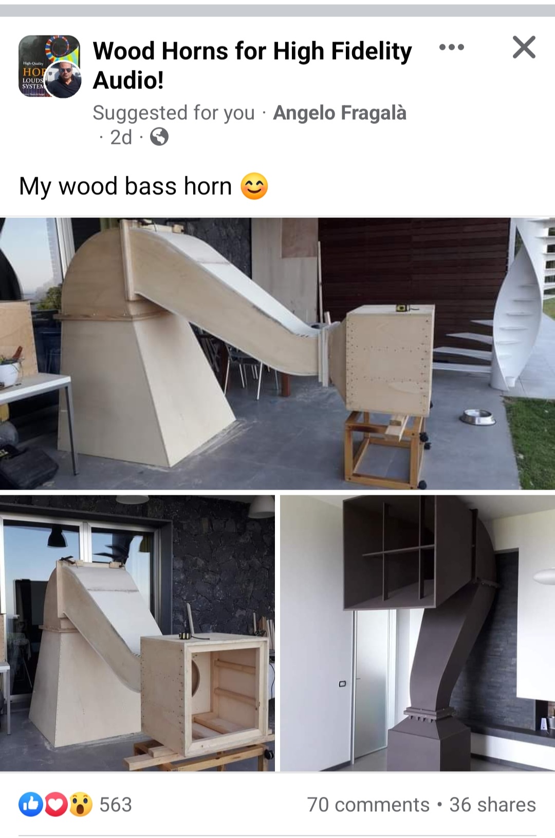

And then there's this type of thing..
- Posts: 29093
Just by looking at it I can tell the rear chamber is much too large and the horn path is too short. I'd say he saw a picture of a 1920's vintage Western Electric theatrical horn and used that as his inspiration but didn't use HornResp to engineer it. It looks interesting, but that's the only positive comment I can make about it.
