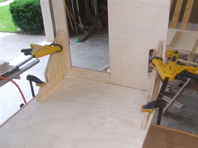

Why not build you some of these.....
They work better and have no issue with glue....

You can't remove panel warping with those. On outside corners you don't even need right angle jigs, or clamps. A 2 inch wide piece of plywood gives a perfect joint and zero warping.Bruce Weldy wrote:Why not build you some of these.....

I've only built with BB, so I haven't had any panel warping. I've used 'em on every cab I've built....plus many other projects over the last few years. Couldn't imagine building a box (or anything with a 90 degree angle) without 'em.
I haven't ever had a problem with outside corners lining up.....maybe I'm missing something here.
