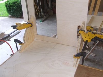

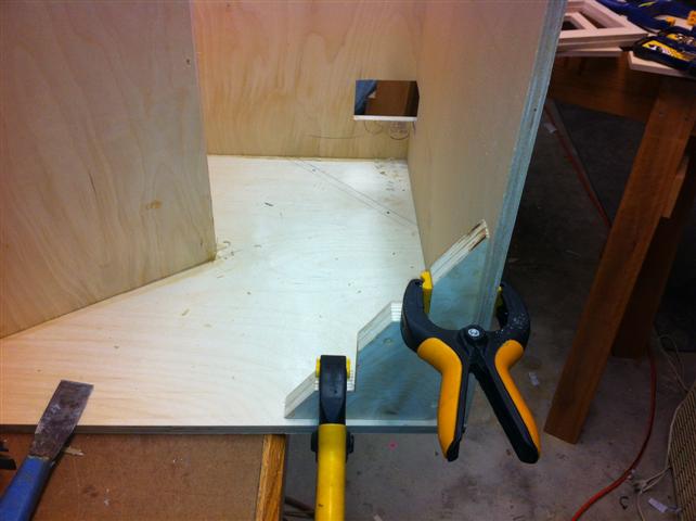

Why not build you some of these.....
They work better and have no issue with glue....

Bruce Weldy wrote:Why not build you some of these.....
You can't remove panel warping with those. On outside corners you don't even need right angle jigs, or clamps. A 2 inch wide piece of plywood gives a perfect joint and zero warping.

#15 Post by Bruce Weldy »
I've only built with BB, so I haven't had any panel warping. I've used 'em on every cab I've built....plus many other projects over the last few years. Couldn't imagine building a box (or anything with a 90 degree angle) without 'em.
