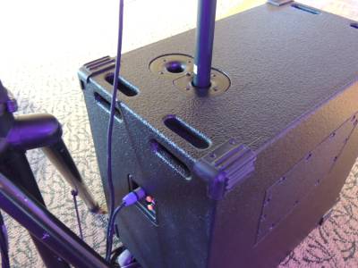

On latest builds, been using the new filler putty from Elmer's. Pro grade. Hardens in about 15 minutes. Sands real well. Very well. When done, the sanded portion looks just like wood and is hard as the wood.
First two cabinets have been sprayed professionally with Vortex. Hard shell but not slippery like Duratex, and not rock feeling like lineX. Its is hard though. I used Duratex in the handles area, and then they sprayed over it, just in case they couldn't reach in the insides of the handles. Have used Duratex many times with great results, just wanted something harder on these subs.

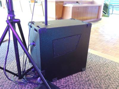

Here's a few pics of different angles with Vortex. Don't mind the "pinkish" color, that was from some uplighting we had on the walls in the area... FYI, if any of you are Packer fans, this wedding was actually at Lambeau Field. Two of 12 are built and finished, 2 more will be sprayed this week, then on to #5-#12.

Re: Finishing cabs
uh oh, now you've done it.
where your braces at

Re: Finishing cabs
Re: Finishing cabs
Because that's life. Not everything can be "ideal", as corner placement, boundary placement, etc. We have to roll the way we can.
Re: Finishing cabs
I'm not asking about boundary loading, I am wondering about splitting your subs. Are you in a very small room? You do know you gain 6dB just by stacking 2 sub cabs together, but you create null zones and power alleys by splitting. I fully understand not always being able to boundary load, but why lose coupling gains? The exception would be in a really small room, as you would split the subs to try to even out response. I may be reading too much into the pictures you provided, but it appears like you have your subs split under your tops. If you don't, my bad.sddj wrote:Because that's life. Not everything can be "ideal", as corner placement, boundary placement, etc. We have to roll the way we can.
