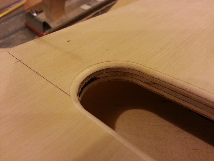

Panel 7 done. BTW I convinced my dad to get a flush cut bit for his router so I was able to make this sweet handle template!

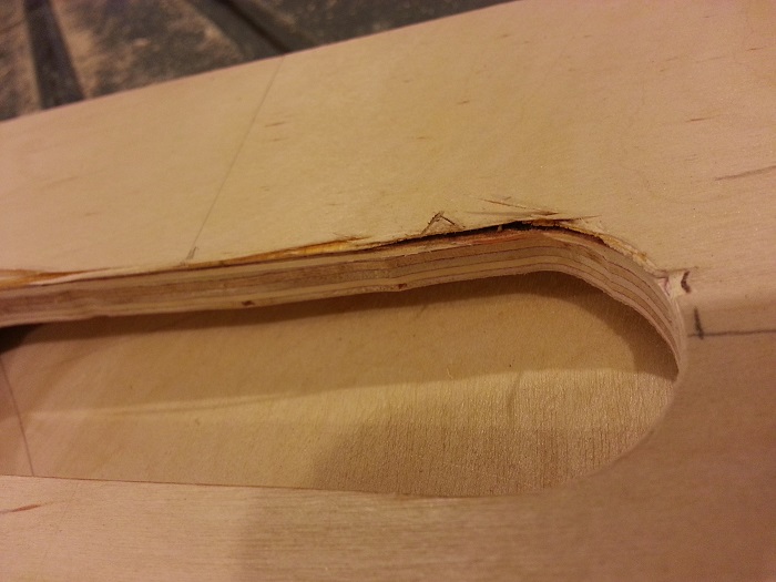

First build casualty, the part that holds the router bit in place whose name escapes me at the moment slipped and thus my template and one handhold are a little bit out of wack. I'll make a new slightly bigger one to cover up the error and I'll be back at it. However, it made me end the night short (as I've learned from the forum/speaker cab building "if something goes wrong, just step away for a day").

Collet perhaps?

Precisely. My dad's router has a pita collet that likes to slip.

Remove the collet lock-nut and the collet. Disassemble the collet and thoroughly clean it, and the inside of the router's drive shaft. If it still slips, replace it. Losing a router bit at high speed could be as lethal as a bullet.MissileCrisis wrote:Precisely. My dad's router has a pita collet that likes to slip.
