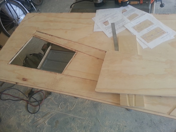

On another note I just supremely messed up my side panel (yeah the one with the intricate routing, see attached). When about to put in panel 1 I measured the distance to the top and it was 5.25 instead of 6.75 inches. My plan is glue the side panel back into place (on the edge that needs fixing) and re cut that edge such that no one will know the difference. (Prays to PL gods that the PL will hold through the recut/bondo/sanding).
See below for before picture. Also I need to remember to plug up all the pin hole drill spots used to draw the layout on the other side of the sub.

Back on course, PL held like a champ. First panel in and pre-dadoed. See below for recovery and first panel install

Re: T60 build. Finally.
Good recovery
How about running a nice thick smear of PL along those dado's that won't be holding panels, to make sure the ply doesn't separate...

Good idea, however since I have screws holding panel two into glue position ATM I'm pretty sure that won't be necessary, but I'll re-evaluate once it is solidly in there. See attached for install of panel 2.
Also, this ply is a whole level better than the crap I bought last time, for reference, I cut 1/16 inch slivers off when trimming a piece and the layers wouldn't separate. The 5 even plies are making my life a lot easier (dealing with some IMO rather large warp at the moment with the help of screws) The dado's are also helping line it up. Maybe you could reword what you meant about the plywood seperating (are you referring to the different layers? or the super thin in between region near the mess up zone?). I appreciate the encouragement. Just ordered another Lab 12 so I can keep my T39 (until I build a 2nd T60) and you won't believe the deal I got. Amazon prime free 2 day shipping (amazon has a 10% off on all their major brand products which includes Eminence) IF you're in the USA and in the market for a Lab 12 I recommend you look into it (although I got the last one they currently were stocking
Yes, a smear of PL to stop the layers from separating, because your (wrong) dado has exposed those layers...
MissileCrisis
- Posts: 1128
I'll put a thin layer of pl in that groove tonight. I wouldn't have thought to do it. Thanks.

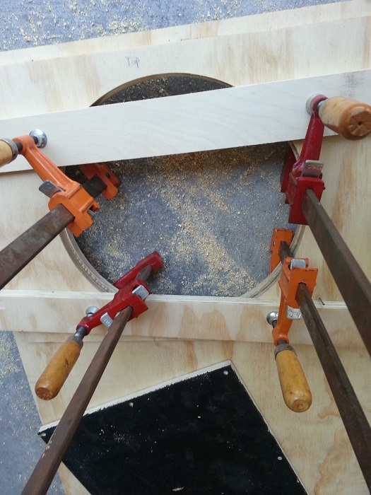

Moving right along, finished the slightly time consuming panel 3 and will be installing 4/5 tonight (who needs fireworks, I make my own, muahaha).

New photos, installed panels 4 and 5, complete with speakon holes (planning to seal with lots of some sort of glue although the fit is pretty snug). The plan is to place two speakons in the access cubby-hole and two on the bottom back (recessed on bottom so that when tipped up on wheels they don't get smashed).
Lookin great! I like the Speakons inside the cubby idea.
