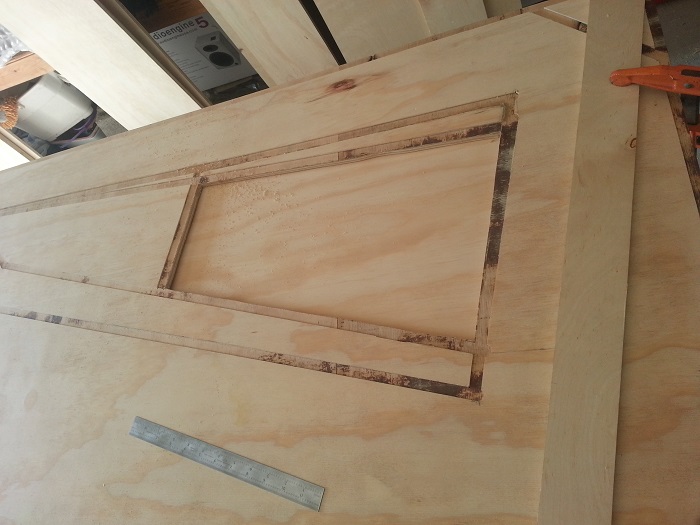

On another note I just supremely messed up my side panel (yeah the one with the intricate routing, see attached). When about to put in panel 1 I measured the distance to the top and it was 5.25 instead of 6.75 inches. My plan is glue the side panel back into place (on the edge that needs fixing) and re cut that edge such that no one will know the difference. (Prays to PL gods that the PL will hold through the recut/bondo/sanding).
See below for before picture.

Back on course, PL held like a champ. First panel in and pre-dadoed. See below for recovery and first panel install

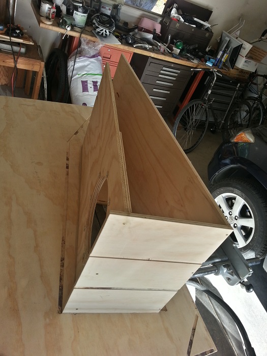

Good idea, however since I have screws holding panel two into glue position ATM I'm pretty sure that won't be necessary, but I'll re-evaluate once it is solidly in there. See attached for install of panel 2.

Moving right along, finished the slightly time consuming panel 3 and will be installing 4/5 tonight (who needs fireworks, I make my own, muahaha).
Squeeze-out is king
Squeeze-out is king
Dados per usual

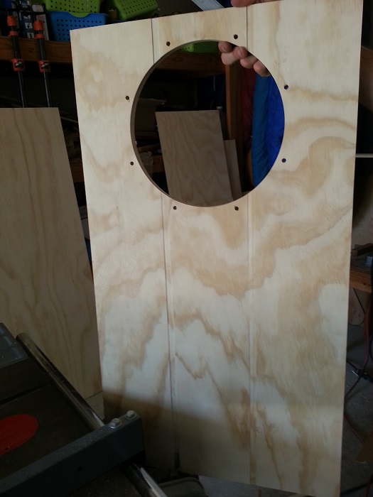

Testing driver for cone slap as per plans. Picture seems stationary because the phone that I was using to tone generate decided it likes to pause audio output when taking a picture, a bit lame.
Looking good so far
Looking good so far

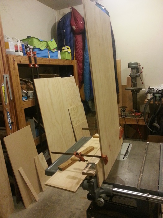

New photos, installed panels 4 and 5, complete with speakon holes (planning to seal with lots of some sort of glue although the fit is pretty snug). The plan is to place two speakons in the access cubby-hole and two on the bottom back (recessed on bottom so that when tipped up on wheels they don't get smashed).
