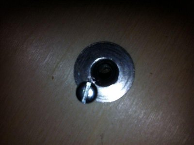

To avoid in the future use the "security screw" technique pioneered by Harley (I believe) to prevent movement of the hurricane nuts. Also always make sure the bolts go in by hand or with only very slight pressure applied to an allen wrench. Using coarse threaded nuts/bolts works better with less chance of cross threading.

That technique is intended for regular t-nuts. Hurricane nuts have a round base.Ryan A wrote:To avoid in the future use the "security screw" technique pioneered by Harley (I believe) to prevent movement of the hurricane nuts. Also always make sure the bolts go in by hand or with only very slight pressure applied to an allen wrench. Using coarse threaded nuts/bolts works better with less chance of cross threading.
If you spun hurricane nuts you quite possibly drilled the pilot holes a bit loose. Also, these work best in baltic birch, as the wood is more dense than pine. If properly installed in BB, you can't spin these even if you try to.

mr.lussier wrote:That technique is intended for regular t-nuts. Hurricane nuts have a round base.Ryan A wrote:To avoid in the future use the "security screw" technique pioneered by Harley (I believe) to prevent movement of the hurricane nuts. Also always make sure the bolts go in by hand or with only very slight pressure applied to an allen wrench. Using coarse threaded nuts/bolts works better with less chance of cross threading.
The technique works just fine with H-nuts.....remember, we are DIYers. Drill a hole in the flange.
