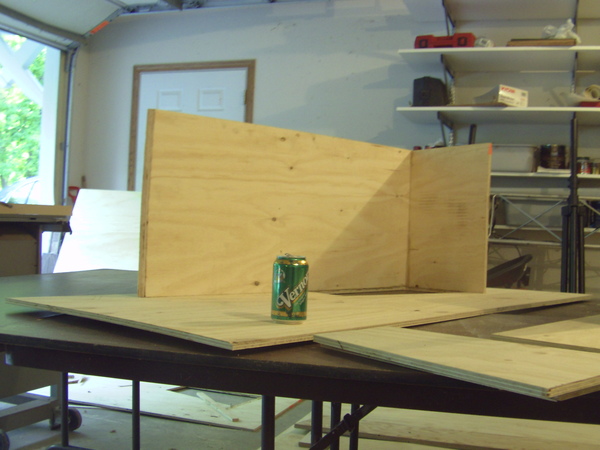

I made a stupid mistake on cutting out the sides, and didn't notice it until putting panel 3 on. :wall: I had the side and the panels cut next to each other, so what happened was it was a 1/2'' short on one end of the side, and 1/2 rich on some of the panels. I trimmed and reused the panels but I will use the bad side for braces or flight cases. when you spend 260$ on ply you will be sure to use it! :broke: I was hoping to get farther with it. tomorrow I will sync up the other one to it
all that was accomplished on the t60 :(

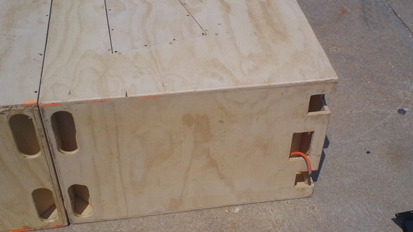

decently sized handles, a little thin, but as long as it isn't dropped on the edge I'm not worried

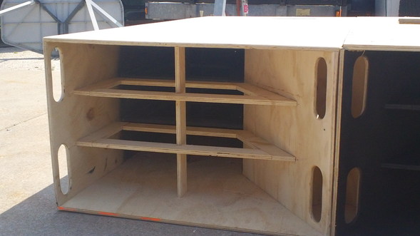

I'm not to happy about the innards of these cabs, if time wasn't a factor they would look nicer inside. After I glue on the side, who's going to know anyways?
