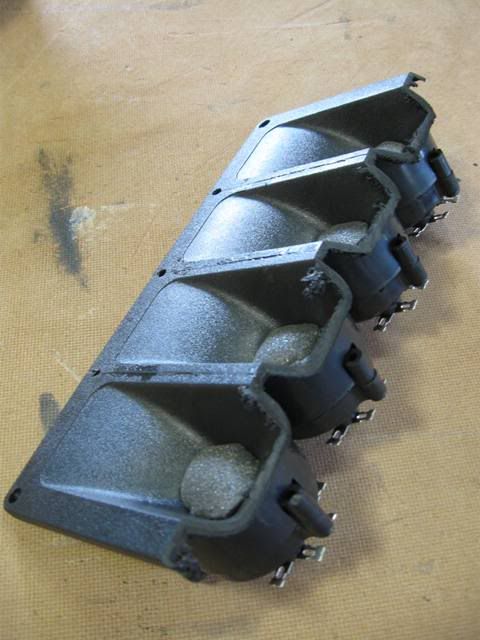

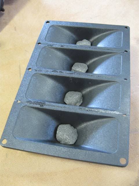

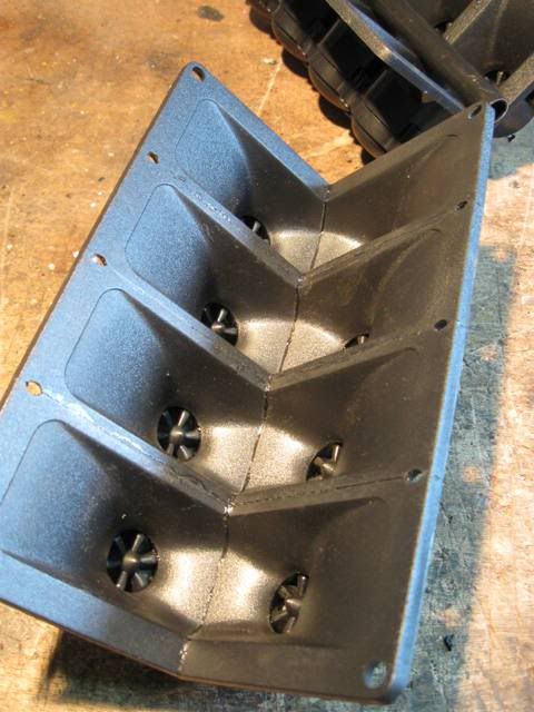

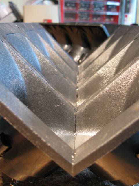

The throats closed with foam plugs:

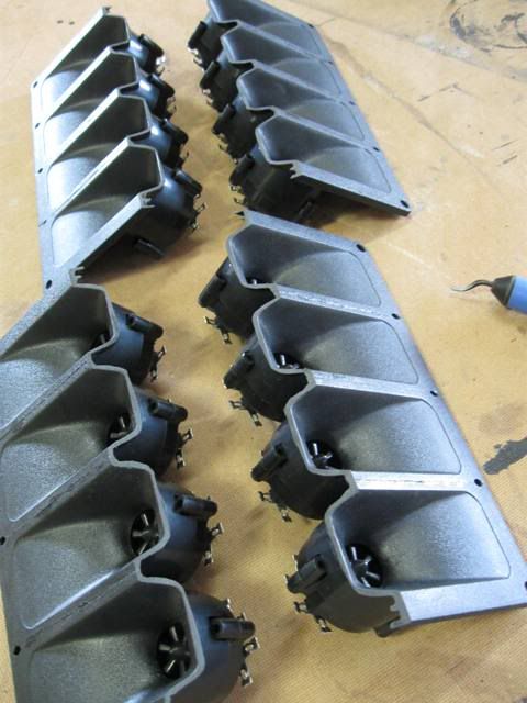

The trimmed quartet:
The quartets cleaned from the cutting residues and ready for gluing:

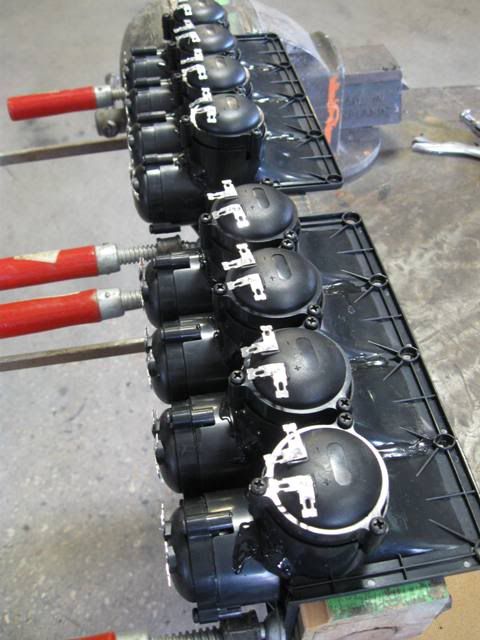

Arrays glued and left to dry:

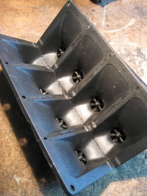

The melded arrays are melded…
I must say I am really impressed with this DIY glue. Very easy to apply, and the result looks as if it was joined by Ultrasonic welding:

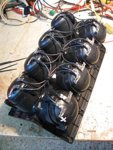

The arrays wired:

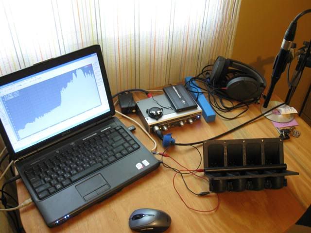

I've arranged this test setup to see what the melded arrays actually produce:

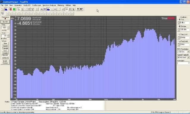

This is the response curve:
Not so clear in the picture, but the Piezos 'wake up' just over 1 kHz. With the X-over high passing at around 1.5 - 2kHz that looks good.
The two significant peeks at 4kHz and between 6 and 8kHz will be easily trimmed with the send EQ.

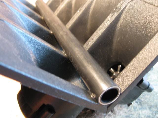

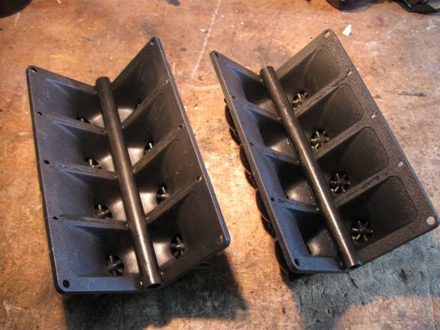

Forgot to show a little tip/trick regarding attaching the melded array diffuser…
Before attaching the diffuser tube to the array, I folded around it a long piece of fine grit sandpaper,
and while pressing it lightly in its intended position, I slid it along the tube axis up and down a few times.
This achieved two things: it marked exactly where the contact points are so I knew were to put the adhesive,
and also it roughened those points a little so the adhesive would grip better.
Here after marking with the sandpaper:
I used black silicone compound for attaching the diffuser tube – a bead to each mark/point.
The diffuser tube is made of 16mm (5/8") house plumbing pipe.
Its outer and inner layers are Polyethylene and an Aluminum layer in between (locally known as SP)
Here a close-up of the contact points (and pipe section…):
