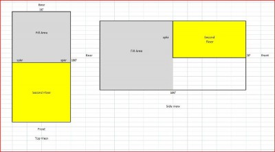

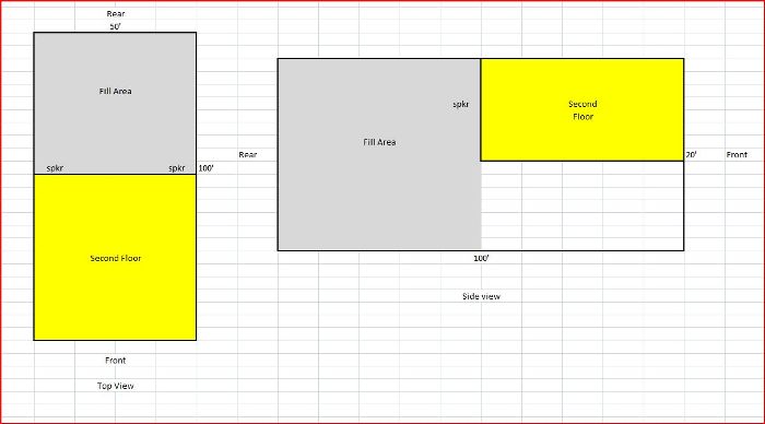

#9 Post by MDW »
Here's an attempted at a drawing of the building:
Top and side views
Top and side views

Hi Michael! Welcome to the forum! There are many here who didn't know the terminology either, but as time passes........ And there are many here willing to give you friendly advice. :)
I think TLAH hung up will do you well, and may even cover the upper "room". The TLAH will help in overcoming the reverb. And add a T48 or two. The subs that Bill designed are all about clarity and efficiency, not the nasty 'boom'. It's a genuine bass sound reaching nice and deep.
