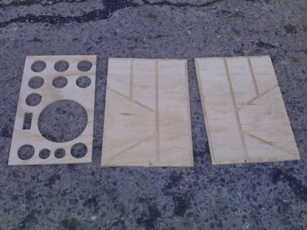

I only have a couple of pics of the top, bottom and speaker mount I cut on my CNC router. I eliminated a couple of parts to make the building a bit easier -- especially with the use of the CNC. Don't kill me, please. :) The dados in the top and bottom made it really easy to glue together. I didn't even use screws or nails -- just PU. I'll likely do the same for the sides of the T39. The dados allow you to rip a whole bunch of wood to height (width for the T39) and then fit them to the dados. I built the box in a few hours and then took all day to cure the PL. I'll install the speaker and wiring tonight.
I found good wood at Home Depot. It is the smaller, precut wood section. I used a couple of 2'x4' pieces of 1/2" and a bit of 1/4" thick wood. The 1/2" has 5 even plys. I looked all around and they don't have it in the 4'x8' sheets. If I were building anything bigger, I'd go elsewhere with my trailer, but it was nice to put the smaller sheets right into my car.

Nifty CNC work - as ever, a few questions.
Why did you make the driver baffle full width and put holes in it - would it not be easier to cut it shorter? Also, if using dados, why not create one for the baffle? or did you create one for the baffle but not the horn flanges? or have you made a huge mistake by not sealing the horn side of the baffle?

I eliminated the horn braces/flanges, so needed to make the baffle full width. Since I made it full width, I added the holes.
The dado is for the baffle.
The baffle braces were also eliminated....but I realized that I needed something to seal off the sides of the speaker opening.....so I did with some 1/4" ply.
I also used 1/4" ply for the horn sides. I wasn't planning on it, but ran out of 1/2". :wall: The box feels really stout, so I'm sure it will be fine. If not, I will add some more support to them.

AndreasMergner wrote:I eliminated the horn braces/flanges, so needed to make the baffle full width. Since I made it full width, I added the holes.
You need the horn flanges to create a seal between the horn opening, the baffle and the driver but if you have covered that with 1/4" hopefully you will be ok. There will be quite a lot of pressure on it.
I suppose if you had made the baffle from 3/4" you could have CNC'ed a 1/2" step and made it from one piece.

Chris_Allen wrote: I suppose if you had made the baffle from 3/4" you could have CNC'ed a 1/2" step and made it from one piece.
That's what I was thinking too! If only I realized beforehand..... It should be fine, It is only ~2" wide and supported by the horn on one side and the baffle on the other.
