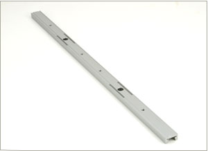

If you still have problems, I ended up getting these after spending days remaking multiple sleds and still not able to get strait cuts making my own sliders. These are adjustable, you just drill holes through your sled to the adjusters, so you can make small adjustments with the sled on the table.
http://incra.com/product_jfc_miterslider.htm
INCRA Miter Sliders 18” & 24"
I'm very much a novice to woodworking and had many frustrating days and a lot of cut panels that weren't square. I could never get pieces of wood perfect enough to run in my t-slots (again i'm very much a beginner with this stuff).
I purchased their sled also, but from what I've gathered on woodworking forums, these work great with a home made sled.
Now I cut 24" panels and they come out perfectly square (finally).

That is pretty awesome, I'll have to give it a go.
