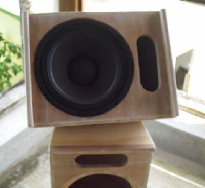

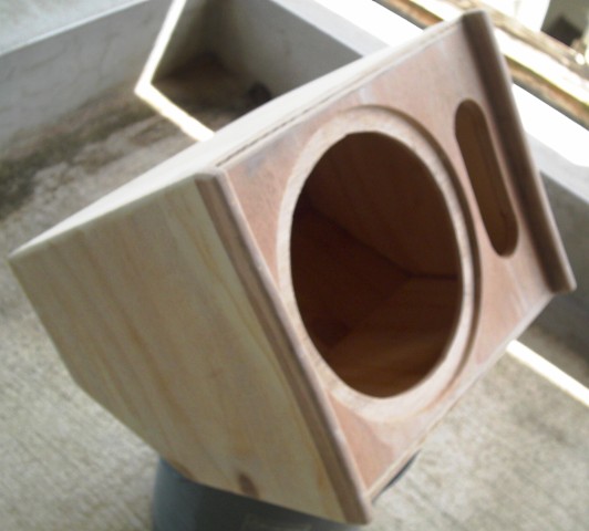

Sanding and prep. is king. I'd say that the Elmer's wood filler is great to work with water clean-up if starts to dry put a little water in it and problem fixed and you could get it the consistency you want.
elmers woodfiller.jpg (10.9 KiB) Viewed 1469 times
These are a pair of small monitors for a client.
This wood filler is great to work with!!!
