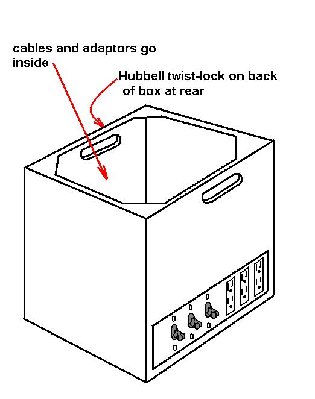

My Wire box/Distro:
I can carry it (stairs or outdoor) or wheel it on a wheel board. The box size will be the same as my amp racks so that I can install the locking corners and stack it easier.

To protect the distro itself. By code the sub panel is supposed to have a main breaker. The feeder wire would have to be split into 4 seperate feeds so without a main breaker you are not protecting the panel or the feeder at that point in the system.
Also a distro would be considered a sub service so be sure to keep the Neutral and Ground isolated from each other. A lot of people try using Home Panels as distros and dont realize that the Neutral and Ground bars are tied together.As a sub panel that would probably humm really bad so please keep the ground isolated from the Neutral if you want a humm free system.
Hubbels are fine if you already have them. I used to always use them but man they have really gotten expensive. The same connector through Leviton or Cooper is nearly 2/3 the price and it's the exact same connector made to the same code.

Problem with the Furman design is if someone decides to wire it up with say 10 ga feeder and that feeder shorts or the insulation melts to the chassis there's a good chance that it will not trip the breaker feeding it before it blows a hole or causes a fire in the distro. With a main breaker even at a full 100 amps so close to the short there would be a better chance of that not happening.
They get around the code by not putting more then 6 breakers in the panel.While still legal it isn't very smart! My opinion is there's no substitution for safety irregardless of cost!
Also another very good reason to keep a main breaker is in the event of a main trip you can reset (after removing the problem device) without having to trek back to the panel you're tapped out of, which in some instances may be locked after you tap! When I work at schools they always have the Fused Safety switch that I tap from locked out! You can still throw the switch but you cant open the door even with the toggle on the side of the switch!
