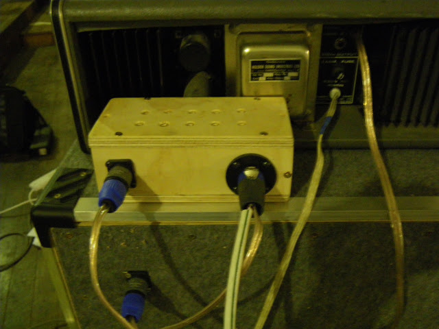

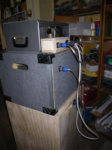

I had done something similar for mine last year.
The input is on the left on a 2 pole Speakon
The output is done on a 4 pole Speakon. With two cables then going out of the Output Speakon connector to their respective cab.
-1+1 }===============================D=: Male Speakon 4 on the -1+1 poles
-2+2 }===============================D=: Male Speakon 2 (on the existing poles)
The Otop has a 2 pole Speakon socket, so it can only get the full range signal or the HF part
The T39 has a 4 pole Speakon socket (driver connected to -1/+1), it can get anything.
Because I don't trust myself, I made it foolproof...
I put the connectors on one side only so that the XOver box sits nicely at the back of the amp.
I drilled some holes for ventilation, just in case.
I forgot to paint it ;)
