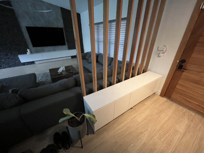

Hey all, I just moved into a new spot and i'm debating what do with building a sound system. The living room is pretty dang large with a huge L shaped couch and this useless entryway cabinet that's right behind it. It looks nice, but serves no real purpose.
What i'm wondering is if it would be smart to just replace it with a low profile THT. It would be roughly the same size and being so close to the couch, i'm assuming it would provide quite the kick during movies.
The other option is going with a more traditional sub that would be corner loaded up next to the TV (you can barely see this in the top left of the pic). I'm sure this would sound good too, but i'm just debating which path to start down...and hopefully you all have some stellar sage advice. Could I just run both with some delays factored in?

It really depends on the room itself whether sub placement at that specific location will sound good at the couch seating positions or not, whether or not it's a noticeable null zone at certain frequencies. If you currently have a subwoofer, you can test different sub placement locations throughout the room prior to committing to a solution. Or the reverse process... the sub crawl. Place the sub in your preferred listening position, get on your hands and knees, and crawl around the room listening and/or measuring bass response around the perimeter and desired placement locations, choosing the location that has the best and most even response throughout the desired frequency range.

It should work, my TT 2x4 is right next to my recliner/listening position/home theater/home office.

Seth wrote: Sat Jan 31, 2026 2:51 pm It really depends on the room itself whether sub placement at that specific location will sound good at the couch seating positions or not, whether or not it's a noticeable null zone at certain frequencies. If you currently have a subwoofer, you can test different sub placement locations throughout the room prior to committing to a solution. Or the reverse process... the sub crawl. Place the sub in your preferred listening position, get on your hands and knees, and crawl around the room listening and/or measuring bass response around the perimeter and desired placement locations, choosing the location that has the best and most even response throughout the desired frequency range.
Yea, I hear that. I do have a sub I could test various positions with...that's a good idea actually. Thank you internet friend!
