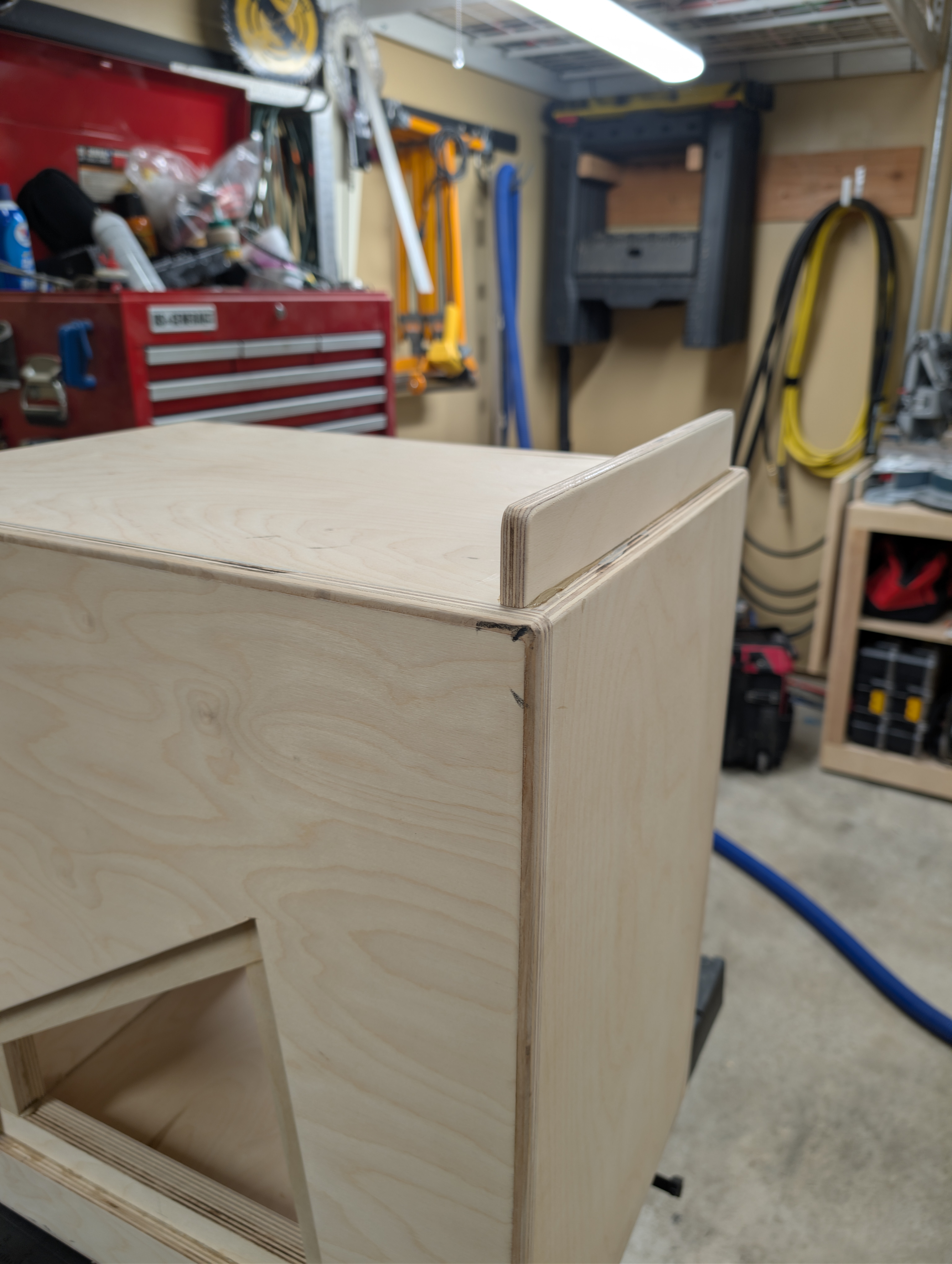

Panel 11 is now in place. Once it's set, I'll get the brace cut out. The brace is going to double as a brace and handle as I want the sub to be easily removable from the truck cab in case I need the space in the back seat.
Also, can NEVER have too many clamps!

Got the second side attached. I was able to do a test fit in the truck and it fits perfectly between the seat rails!
@Bill (or anyone who would know): the ID width of this cab is 13" (14" OD). Is the mouth brace necessary for a cab this skinny? I'm rethinking the handle situation after test fitting it in the truck. If the brace is necessary (which I assume it is given that the plans don't say otherwise), then I'll make it work.
Re: TAT Build
Posted: Tue Dec 16, 2025 12:25 pm
by Bill Fitzmaurice
I go with no more than 6 or so inches of unbraced panel width. It may not be absolutely necessary, but I'd rather be safe than sorry.

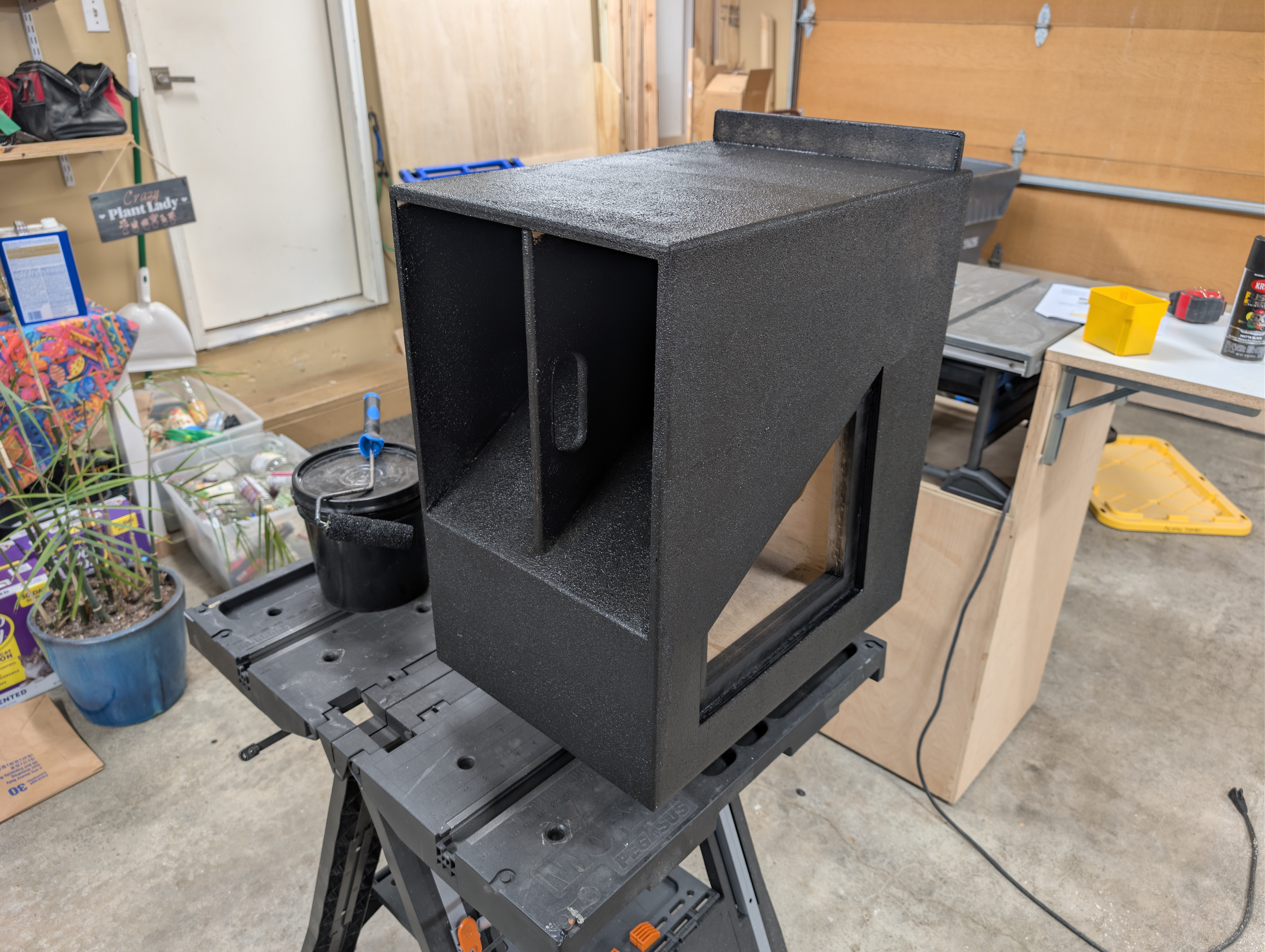

Got the mouth brace with handle cutout installed. Pieces under it in the image are jigs to keep it straight.

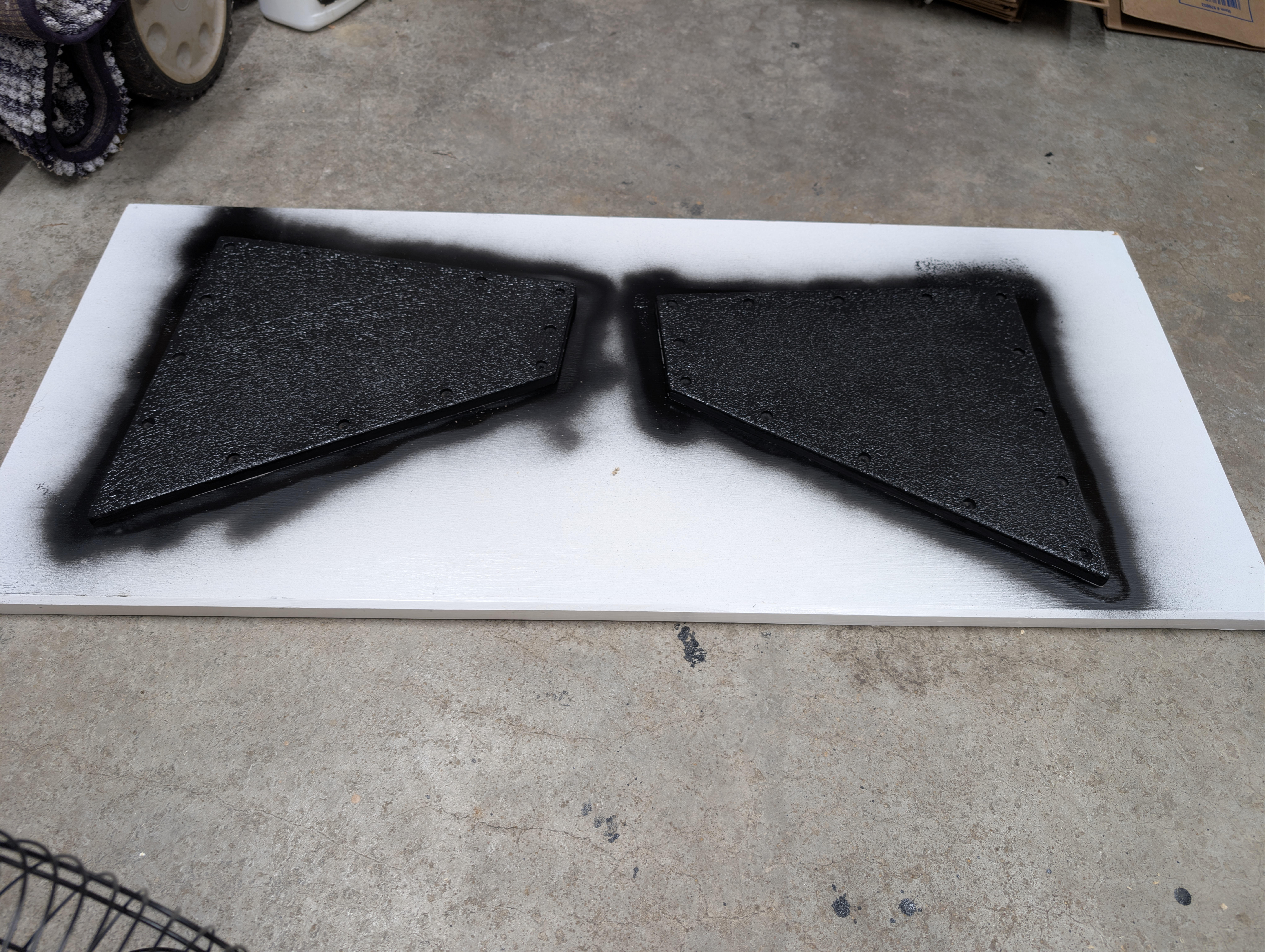

Driver chamber cover flanges installed. Got the cab all sanded and corners rounded. Also got the "foot" installed so the cab is level in the back of the truck. Decided to go with Duratex as the finish as it's tough and will match the black interior of the truck pretty well. Also way easier than trying to carpet it or wrap it in vinyl.

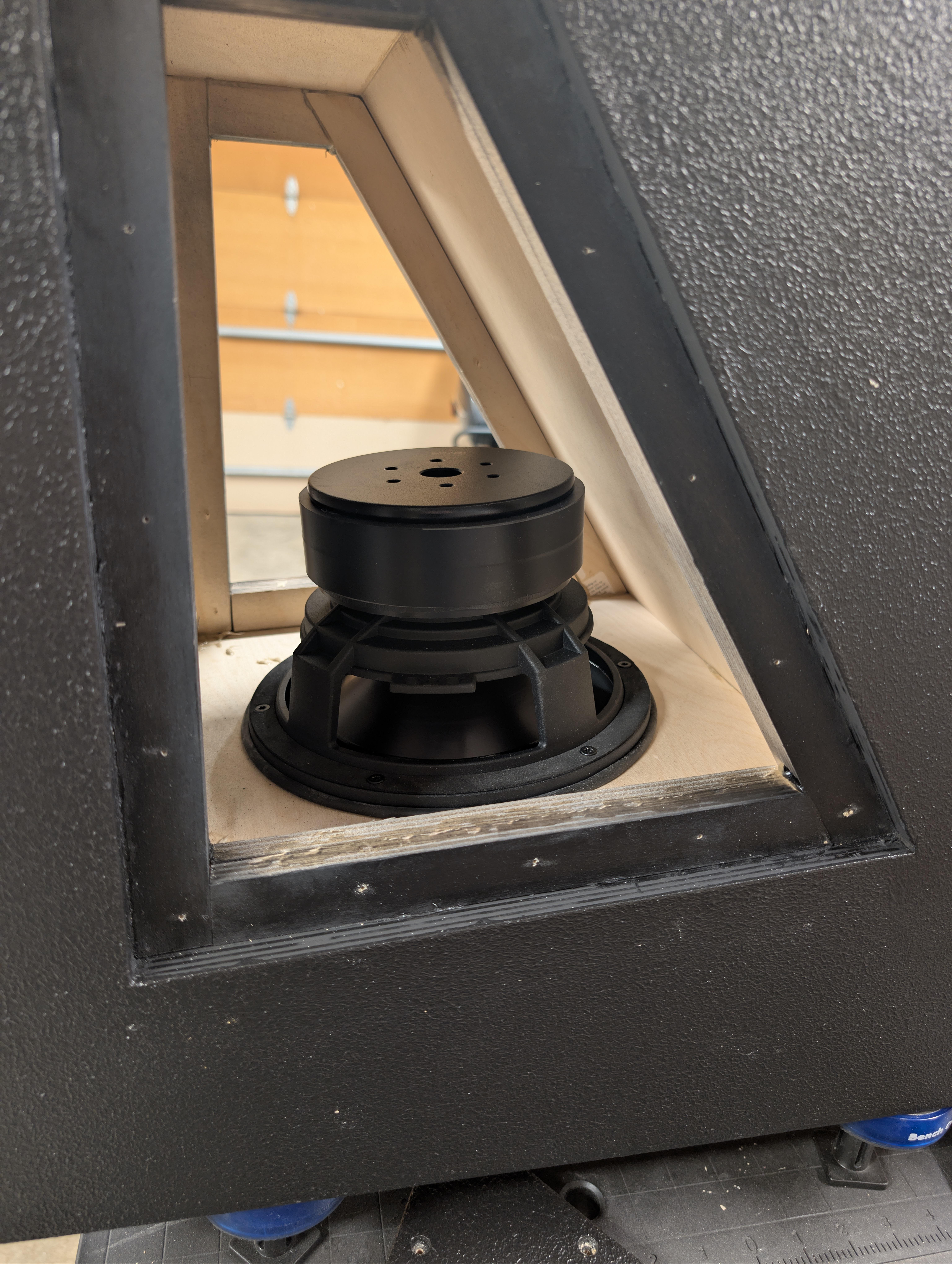

@Bill
I found what might be an error in the plans. On page 28, the driver cover image description says "Cover for inlaid mounting" but the dimensions in the image are too large for inlaid mounting. Perhaps the description there should be for "overlaid" mounting.

FIN
Got the DSP wired up to the factory system which was a PITA (yes I used aftermarket wiring harnesses so I'm not hacking apart the stock wiring harness. Learned that lesson a long time ago). The DSP allows for things like setting a HPF for the door speakers and LPF for the sub as well as built in EQ and such. Neat piece of kit.
I've got the initial dial in of the sub done. I'll definitely be tweaking it over time.
First impressions: this thing is utter madness! I've had an autotuba before but never in a truck. This thing kicks like no one's business. Definitely puts out more clean, clear, accurate sound than a single 8" woofer and probably 100 watts of power has any right to. That's a testament to the efficiency of Bill's designs!
