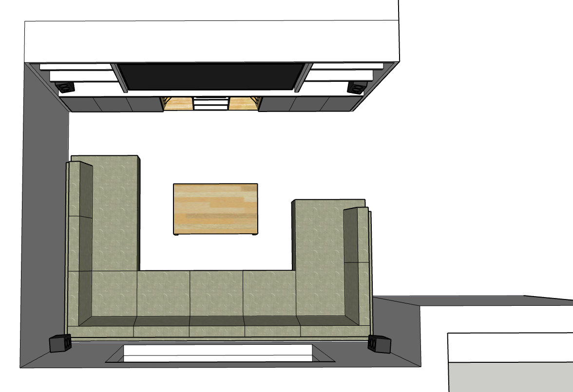

So I decided to pull the trigger and get started on a THTLP build for my living room / home theater project. Space is limited, so I have to be smart with my design and therefor I purchased the LP version. My goal is punchy, precise bass with as much LFE possible without running into group delay issues. I wanted to follow all the recommended steps to get maximum performance, however importing two Dayton Audio rss390hf-4 15" drivers to my home country of South Africa is incredibly expensive given import costs, duties, etc, so I'll have to choose from locally available drivers. We dont have anything like a Parts Express here, so the options are chinese made "professional" style drivers or car audio.

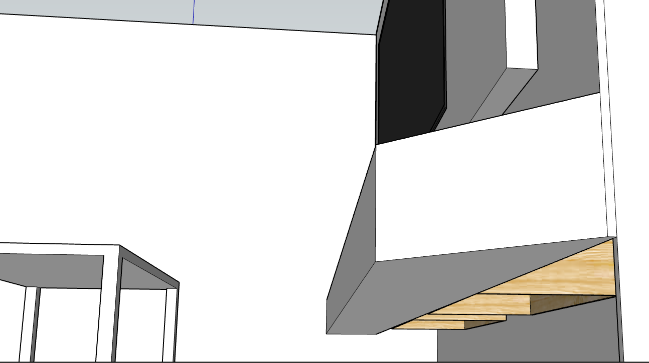

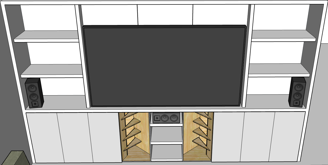

My design has incorporated two of the 36" versions. I'd prefer not to have them 36" wide, as that means the bottom of my tv would be at least that high off the ground. I'd prefer to get it lower. I know they should be corner loaded for best performance (and I possibly have a solution for that if I can go with a slightly narrower cabinet without losing performance) but I obviously want the most low end extension I can get without losing too much of the available space in my living room. The space in between the two horn openings in the attached image are about 500mm, which is less than the prescribed 2.8ft / 850mm as detailed in this post: viewtopic.php?t=398

#2 Post by Bill Fitzmaurice »
The driver Fs does not need to be 19, it needs to be between 17 and 30. Lower Qts is better than higher. The cab width is explained in the plans. Placing subs below a TV is a very bad idea. The low frequency output will vibrate the TV, the shelves and everything on the shelves. You also don't want two subs on the same end of the room. Determine the best location for the first via the subwoofer crawl (google it) then with both subs operating do the crawl again with the second sub. There's no reason to build two 36" wide cabs, with a pair of them 20 to 24" wide would suffice. Two 36" wide cabs would be sufficient for a 50 seat theater. As for group delay, that's an audiophool myth. Below 80 Hz you can't hear it. Above 80 Hz if you did hear it the speaker would be so totally flawed that you wouldn't be able to listen to it. 'Punchy' and 'precise' bass are also euphemisms used by audiophools. They don't define anything where acoustical engineering is concerned. Ask any audiophool what the correct acoustical engineering terms are for what they're trying to describe and the only sound you'll hear is crickets. As for driver sourcing, others in your area might be able to help, but we don't know where that is. You should complete your profile.
