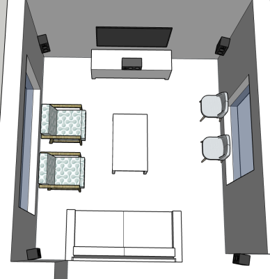

Arcane wrote: Thu Jul 03, 2025 10:24 am ..there really isn't any other place the sub can go other than my front wall, due to the size and layout of the couch..
Do you already have the couch and cabinet in the image? Could you ceiling mount the sub?

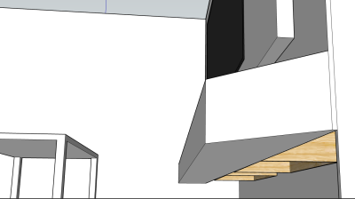

The attached image is a rendering of my current setup. My idea was to turn the room, as putting a THTLP in the front wall of the current layout, takes away too much of the room length, making it feel cramped. I like the table tuba as a space saving idea, but the wife doesn't like a cable running to it over the carpet to the center of the room and I dont think there's space anywhere else for it. That's why I settled on the THTLP. Dont have u-shape couch yet. That was the plan as my wife wants to make the area a bit more 'cozy' and she feels it'll be more inviting. I'd like to incorporate her wishes and a theatre. Not an easy task! Im not opposed to removing the window on the right and sinking the sub into it, to save even more space. It was an outside window, but an additional room was built onto the house, so it wont be a problem if it goes. One of my early ideas was to wall mount and down fire the THTLP so the sound comes from below a floating wall unit. I'll attach an image of that as well.

It seems you haven't looked at the TableTuba Longstyle, Table Tuba Two by Four and the two Small TableTuba options. I see three corners where upright placement would work, not to mention end table placement.

Arcane wrote: Sat Jul 05, 2025 8:10 am The attached image is a rendering of my current setup.
It's great you've taken the time to create these images, makes it so much easier for us try to help!
Arcane wrote: Sat Jul 05, 2025 8:10 am ..Dont have u-shape couch yet.
If you are set on choosing the THTLP, the cabinet could form part of your desired U shaped couch, l also suggest you consider the other smaller HT sub designs if space saving is a high priority, the THTLP form is a proper tank of a sub as Bill mentioned, you may not need all that power. We have an 8" Autotuba in our upstairs 3.1 HT in a room slightly smaller than the one you picture, and it outperformed an 11" bass reflex sub at half the power setting.. with a substandard driver! We also keep a 20" LAB15 THT downstairs for nuclear warfare :)
