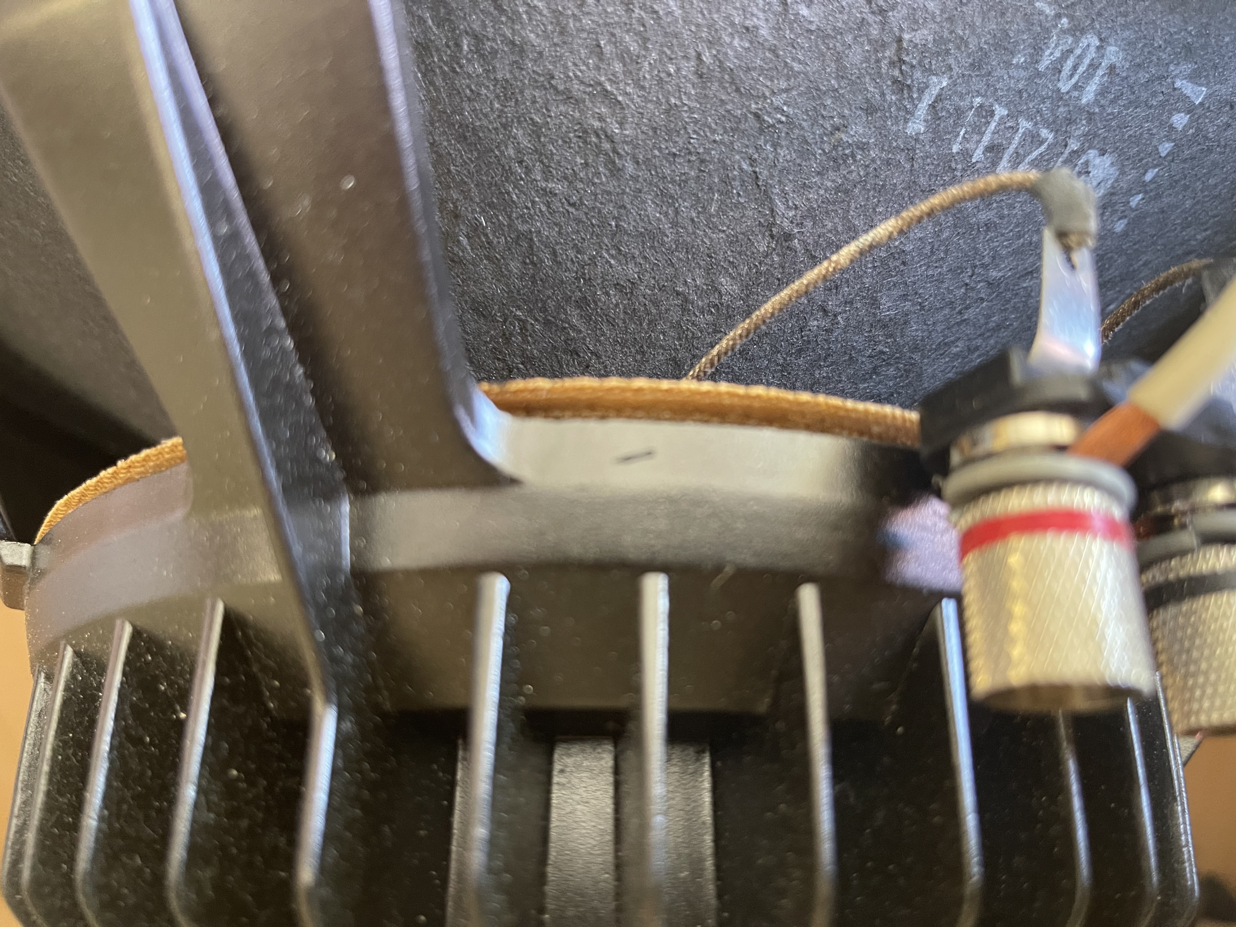

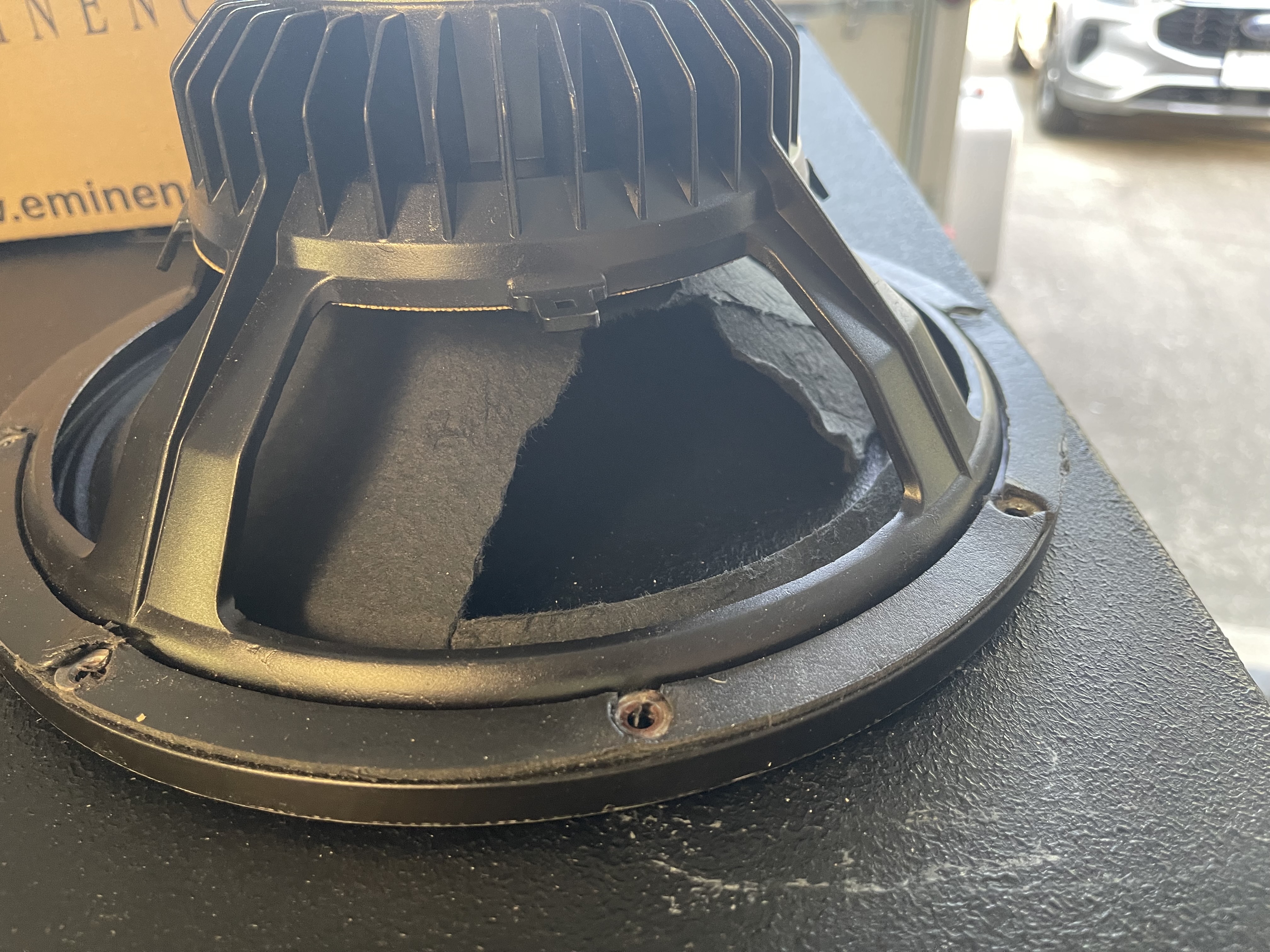

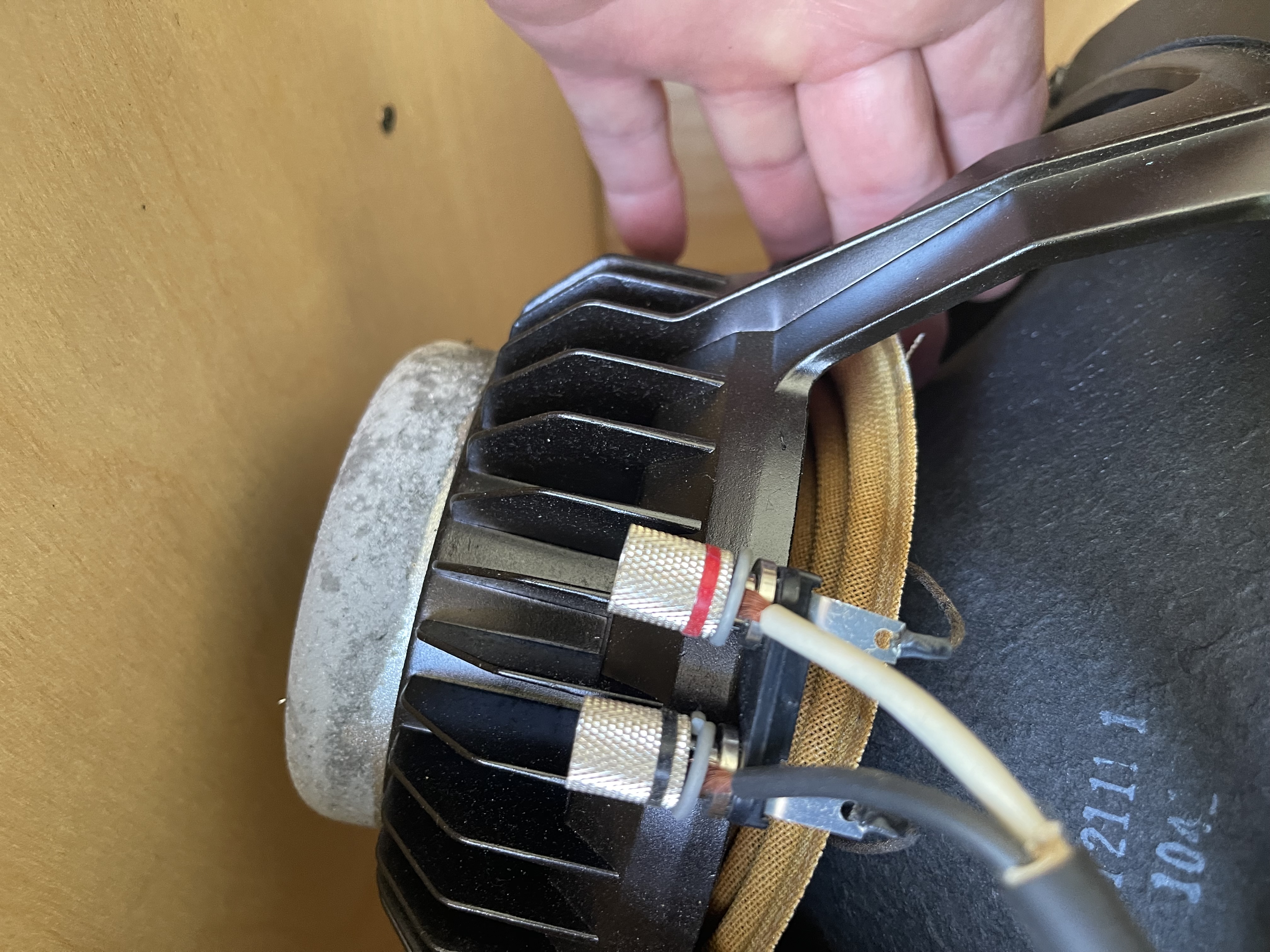

Well, after 15 years - I finally blew a driver. This was one of the first 2 T39s I built. I tested it and it sounded ok until you gave it a little juice, then it started rattleing. I could tell it was coming from the driver chamber, so I opened it up.
I knew right away something was amiss when I could see the spider separated from the magnet structure.
Then, being the great dectective that I am, I immediately saw things in the chamber that didn't belong there - at least not where they were laying. There were a couple of pieces of the cone in there and they weren't attached to the driver any longer. I reached around to the backside and quickly found where those pieces used to be.

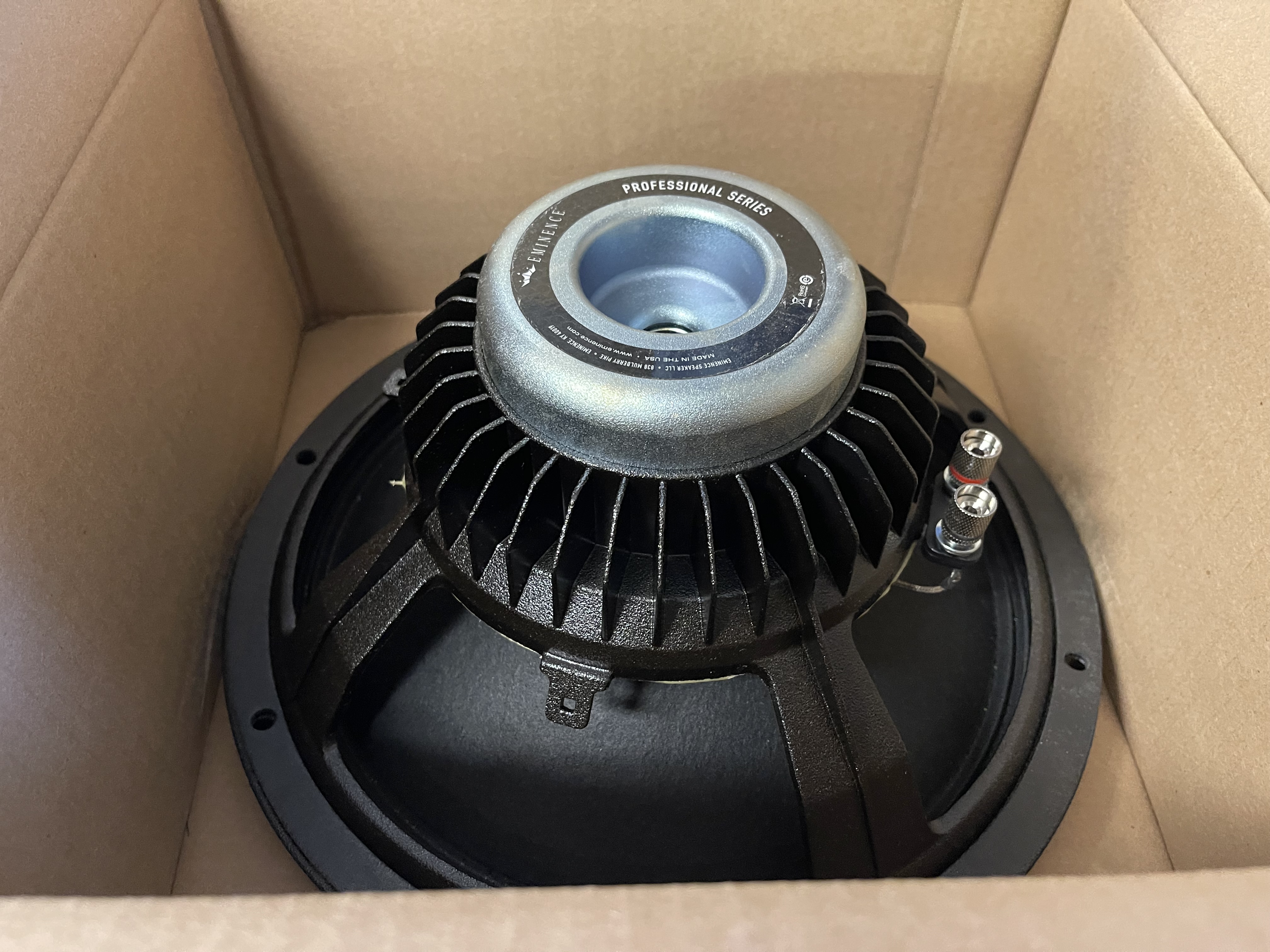

As I really didn't think I could go 15 years without blowing a driver, I bought spares for my system probably about the time that I built the second set of speakers. So, out comes the dusty box with a brand new 3012LF (I only show the dusty box for sheer drama of it).
Now, I need to get out there and start putting 10 volts worth of 30hz through it to see if can still take the pressure after such a long time on the shelf.
