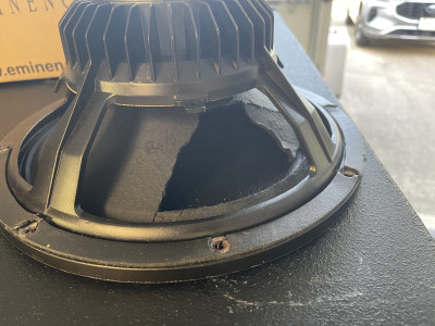

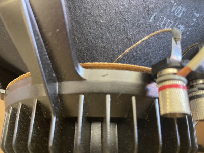

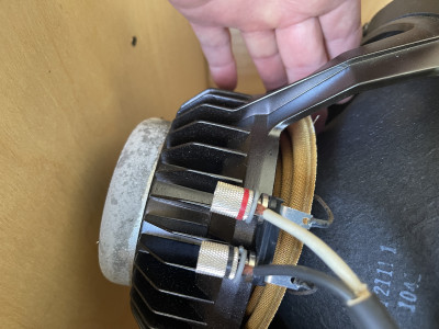

Well, after 15 years - I finally blew a driver. This was one of the first 2 T39s I built. I tested it and it sounded ok until you gave it a little juice, then it started rattleing. I could tell it was coming from the driver chamber, so I opened it up.
I knew right away something was amiss when I could see the spider separated from the magnet structure.
Then, being the great dectective that I am, I immediately saw things in the chamber that didn't belong there - at least not where they were laying. There were a couple of pieces of the cone in there and they weren't attached to the driver any longer. I reached around to the backside and quickly found where those pieces used to be.

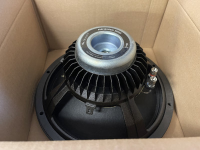

Man, I finally got the break-in started. Geez....had to drag out the old laptop with Win7. Fortunately, Audacity still had a file on there with a 30hz test tone. Had a hard time getting the correct settings on the headphone output to drive the amp hard enough to get 10 volts.
I haven't broken in a driver in about 10 years.....Hope this is the last one I ever have to do.
