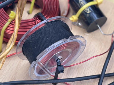

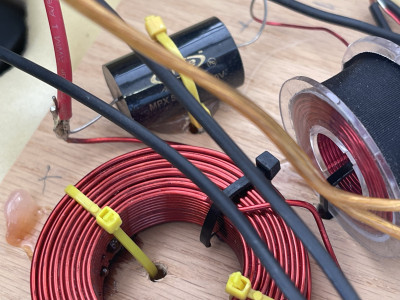

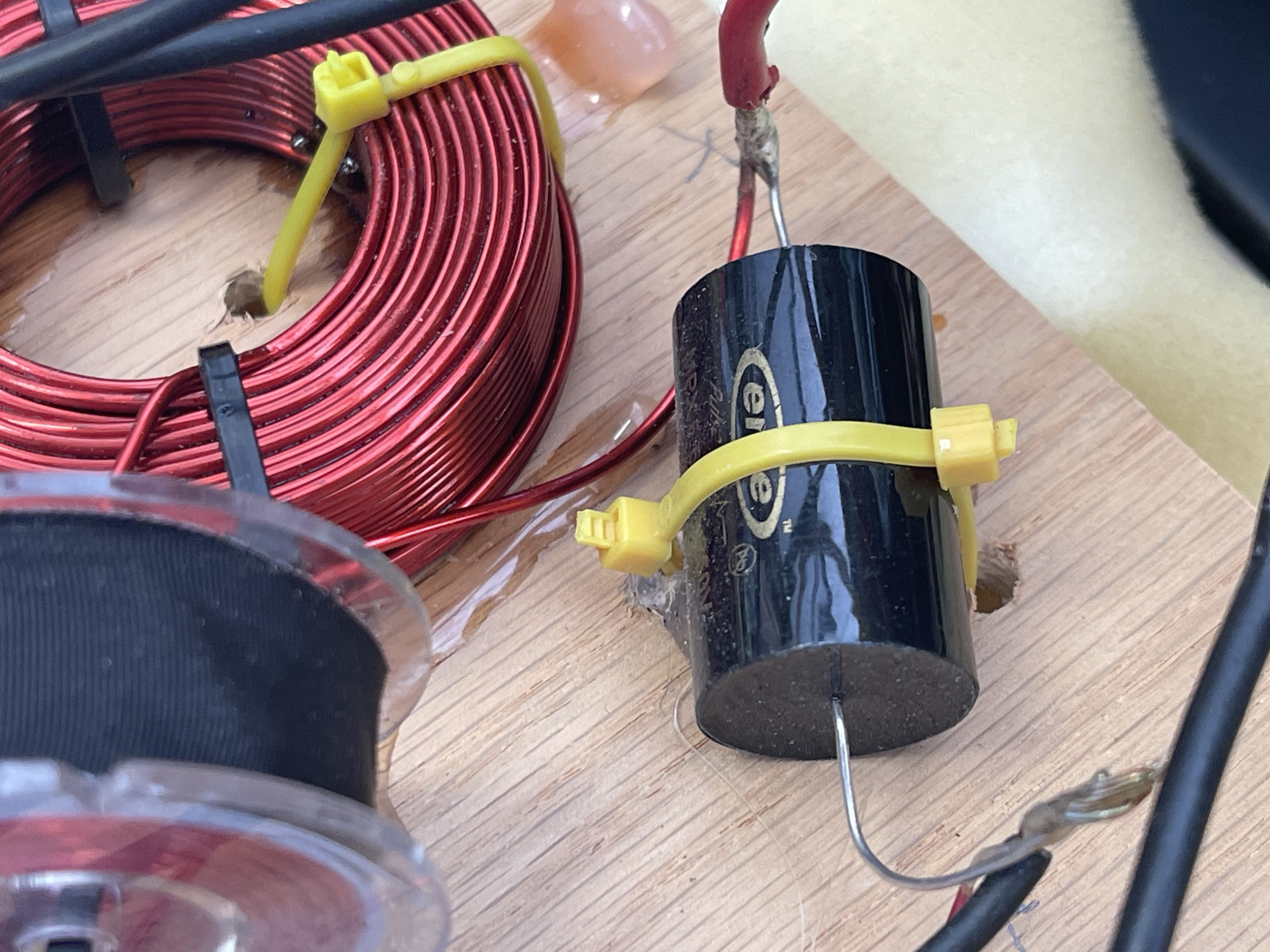

Here's some pics of the crossover (hard to believe that I built this about 10-11 years ago.) The components all look good as far as I can tell. Any ideas what this could be?
