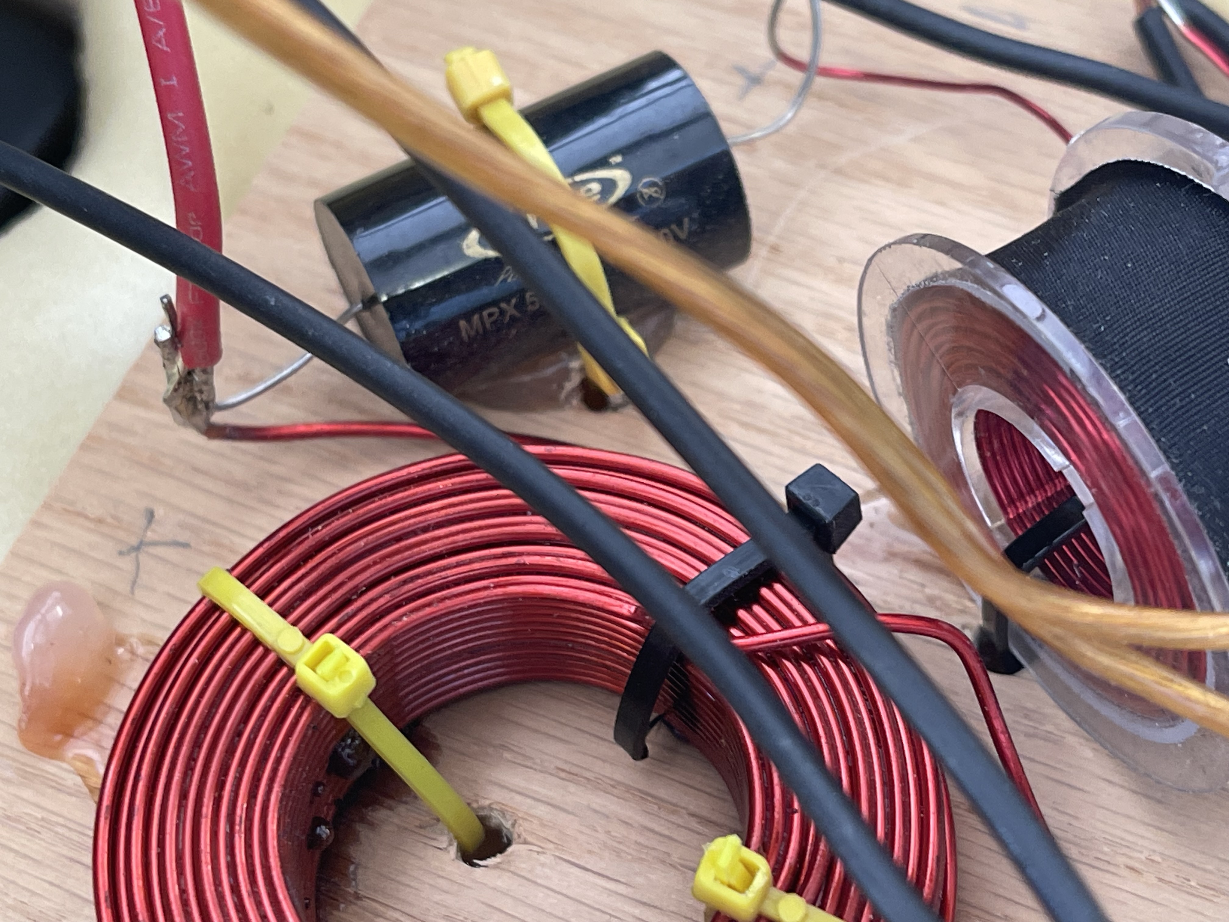

So, it's definitely the cab. I took the back off the cab and one of the inductors had come loose from the crossover board and was resting on the bottom of the cab. I inspected the crossover, all looked good. Re-attached the inductor - I figured that when it fell maybe the wires were shorting out.
Tested again with the same result - no change.
I decided to do a video so that ya'll could hear it. Having trouble getting the video to download to my computer from my phone.....so, I don't have that right now. Keep in mind that I was turning the amp off as soon as the noise started. But, trying to walk over to the cab to video, it took a few seconds for me to get back to the rack to turn it off....it stopped right before I could turn it off. Turned it off and back on again - no noise.
This really has me perplexed. That's what happened the other day too....just started working. I figured that maybe it had shorted and messing around with it jostled it enough to lose the short. Obviously not the case now - I made sure all of the wires had room and weren't touching.
Here's some pics of the crossover (hard to believe that I built this about 10-11 years ago.) The components all look good as far as I can tell. Any ideas what this could be?
