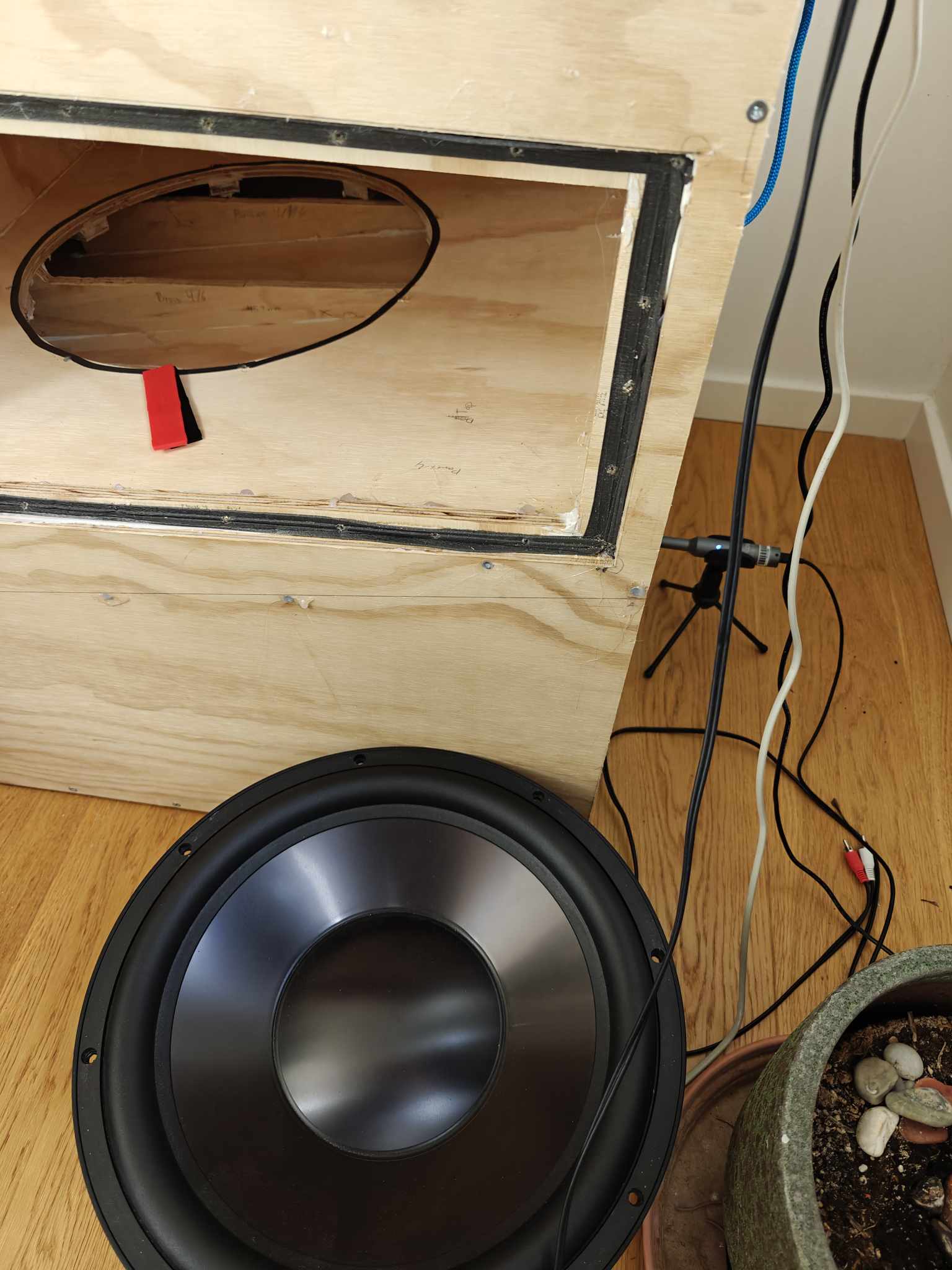

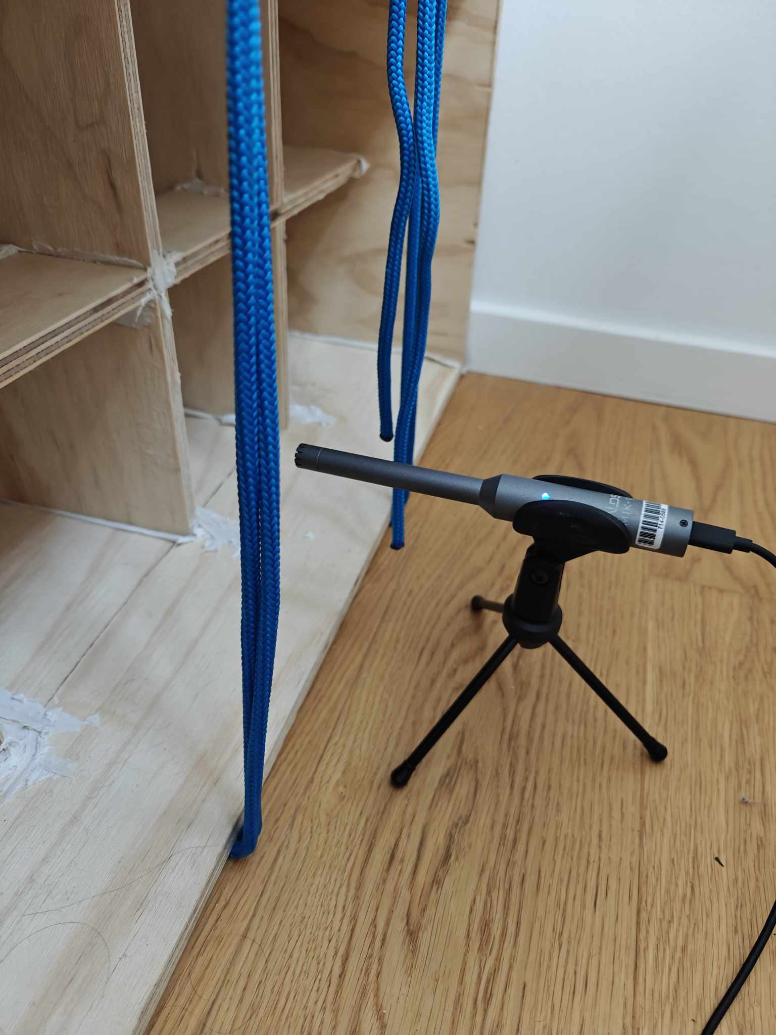

I placed the UMIK 1 calibrated microphone in the mouth of the horn in an attempt to measure the output of the woofer "without" room gain.
Microphone placement in horn

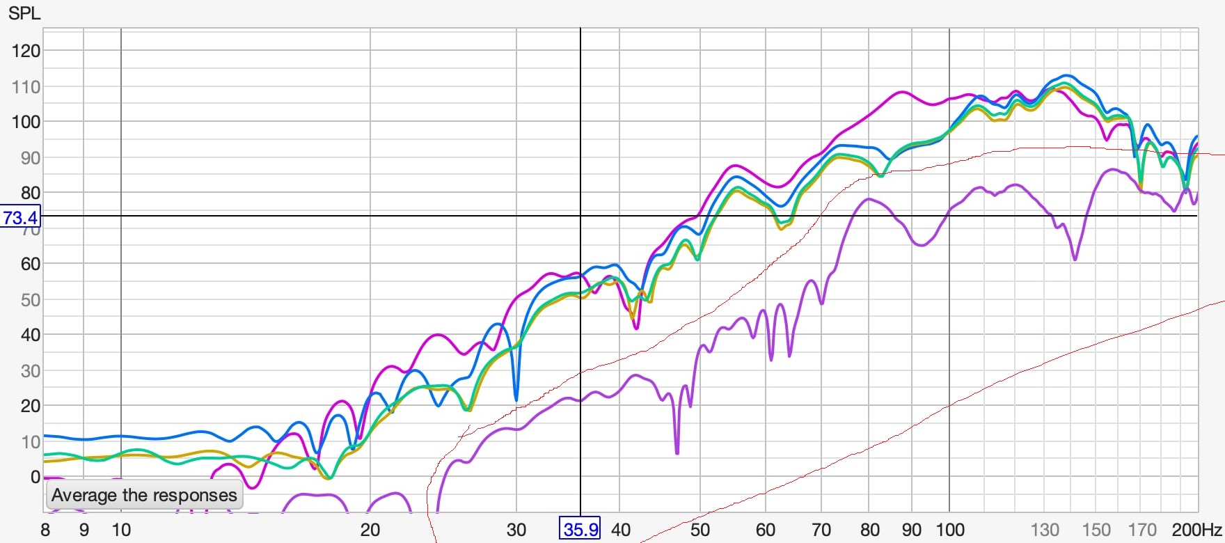

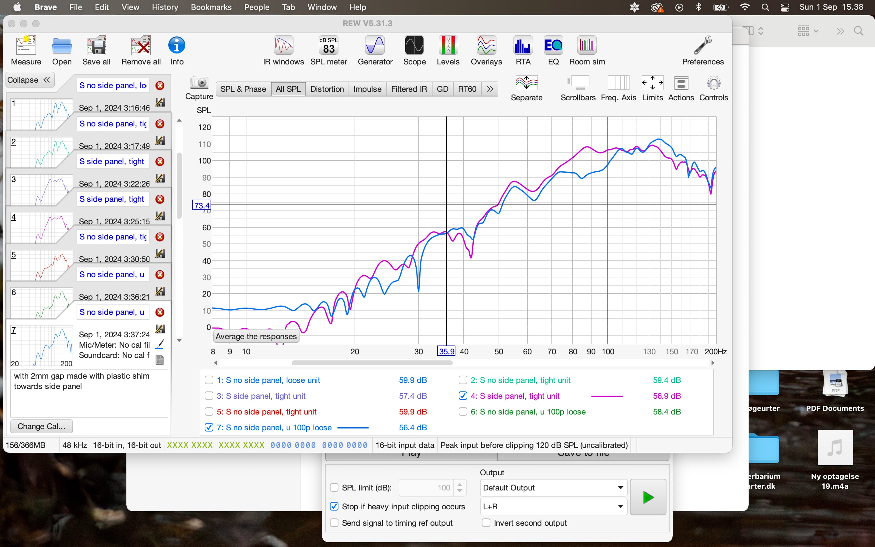

Heres a screenshot from REW, purple line being the measurement with the unit tightly screwed down and the sidepanel attached securely. The blue line shows the subwoofer with all loose screws, a 2mm shim to lift the unit and provide a definite leak, with the side panel off.
I'm at a loss, why are the two measurements so close together? Am I measuring wrong? Do I have a leak in the horn path?

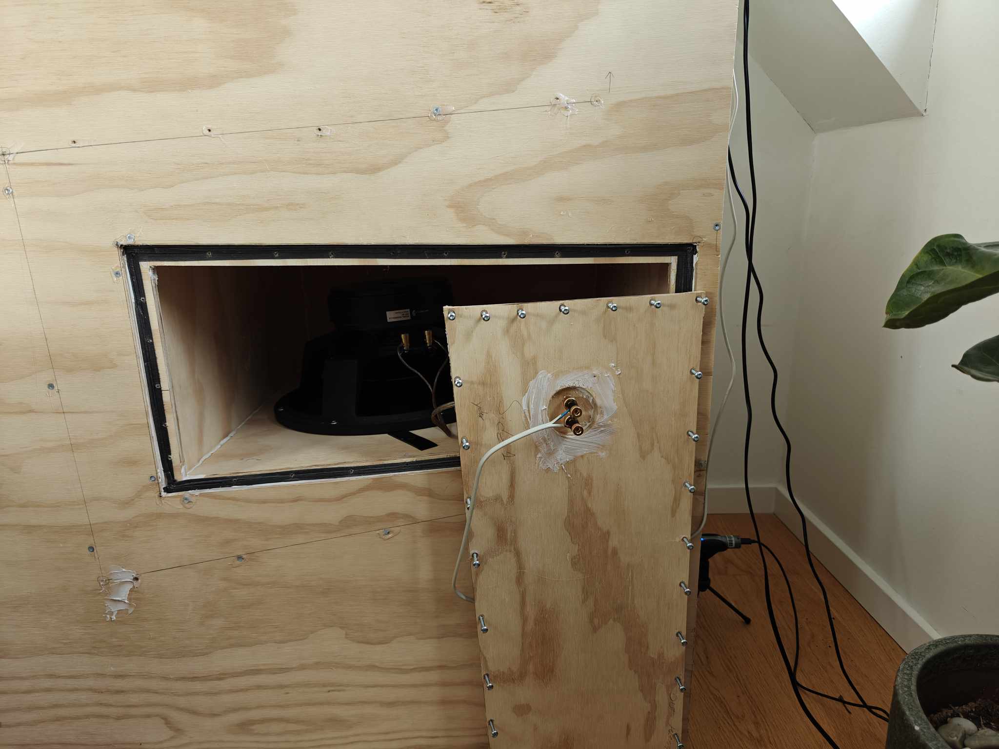

Test setup for blue measurement
Measurements
Measurements

I'm starting to think the measurement is somehow wrong, I have the same exact response albeit at a lower SPL with the unit in free air...

I rotated the subwoofer 90 degrees facing the horn out into the room along a wall. I moved the microphone to a different position ( to the listening position at the couch) and I tried a different amplifier, to no avail...
I also sealed up the inner chamber as best as I could, I applied tons of extra gasking tape around the driver and at the side panel. Then I added "bluetac" to all the screws on the side panel plus the small gap between the side panel and the subwoofer.
What could explain this lack of response?
Perhaps the driver is out of spec?
I thought I did a great job of sealing up the entire horn with the sides, but even if I did leave a small gap in the folded horn, how does this explain a 50dB loss of spl, matching the relative response curve of the driver in "free air".

What crossover do you have set in your AVR or amp or if you also use a DSP? It almost looks like high pass at some higher frequency like 50 or 80Hz and cutting below that.
But also like Bill suggested, test with another sub, even a different model. No matter where it's placed, you should have lots of ridiculous bass, but corner should help.

Your screenshot of REW shows that you aren't using the calibration file for your UMIK.

I’m with AudioTK on this one…the plot looks like a high pass,when it should be a low pass. Check the filter settings. Running the subwoofer LPF too high (above 150) will also do this, but is easy enough detect with a voltmeter as the AC value will track in lockstep with the plot.
