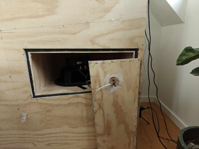

I finished building the TubaHT to a width of 70cm (roughly 27 inches).
I loaded it with the Dayton Audio RSS390HO-4.
I placed the subwoofer in a corner with the mouth of the horn facing into the corner 18 inches from the wall per the plans.
I placed the UMIK 1 calibrated microphone in the mouth of the horn in an attempt to measure the output of the woofer "without" room gain.

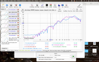

Heres a screenshot from REW, purple line being the measurement with the unit tightly screwed down and the sidepanel attached securely. The blue line shows the subwoofer with all loose screws, a 2mm shim to lift the unit and provide a definite leak, with the side panel off. I'm at a loss, why are the two measurements so close together? Am I measuring wrong? Do I have a leak in the horn path?

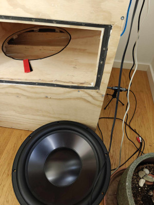

I'm starting to think the measurement is somehow wrong, I have the same exact response albeit at a lower SPL with the unit in free air...
- Posts: 28916
Re: Lack of low end in TubaHT
The only way to measure without room gain is outdoors. Even so those measurements are way off. Something about your setup isn't right. This is my TableTuba 2x4, and the THT goes lower:

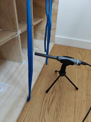

I rotated the subwoofer 90 degrees facing the horn out into the room along a wall. I moved the microphone to a different position ( to the listening position at the couch) and I tried a different amplifier, to no avail...
I also sealed up the inner chamber as best as I could, I applied tons of extra gasking tape around the driver and at the side panel. Then I added "bluetac" to all the screws on the side panel plus the small gap between the side panel and the subwoofer.
What could explain this lack of response?
Perhaps the driver is out of spec?
I thought I did a great job of sealing up the entire horn with the sides, but even if I did leave a small gap in the folded horn, how does this explain a 50dB loss of spl, matching the relative response curve of the driver in "free air".

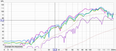

Your screenshot of REW shows that you aren't using the calibration file for your UMIK.
I’m with AudioTK on this one…the plot looks like a high pass,when it should be a low pass. Check the filter settings. Running the subwoofer LPF too high (above 150) will also do this, but is easy enough detect with a voltmeter as the AC value will track in lockstep with the plot.
