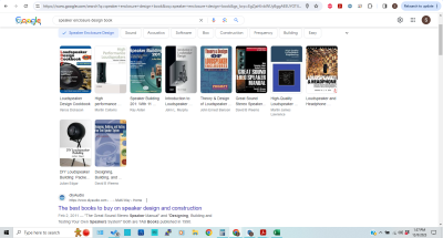

Hey Francois, your best bet is/are books
I'm sorry, I don't have a specific recommendation. Maybe one of the other guys will.

This isn't exactly current, for that matter it predates Thiele/Small. But it remains a definitive work, which you'll find in every acoustic engineer's collection: http://cyrille.pinton.free.fr/electroac ... /Olson.pdf

Thanks a lot, I'll see if I can find any of these books here!
I was taking a shortcut to sum up a bit faster what I studied (and also because it's a lot harder for me to explain in a foreign language, specially 15 years after I got out of college), but yes, it's not a "travel" as a speaker or any sound source don't emit particles like a light bulb does, it's a transmission of energy from one atom to the next ones until there is no energy left to transmit.Bill Fitzmaurice wrote: ↑Fri Dec 08, 2023 5:43 pmStrictly speaking sound waves do not travel through matter. They cause matter to vibrate. When passing through air it's the molecules of air that vibrate. When they hit a solid object, like a wall, what's heard on the other side of the wall isn't sound passing through it. The wall vibrates, which then causes the air molecules on the other side to vibrate. This is why high frequencies are attenuated when you're on the other side of the wall. They lack sufficient energy to cause the wall to vibrate, so the wall won't pass high frequency vibrations on to the air molecules on the other side. Bass has plenty of energy to vibrate walls, because power density doubles with each octave decrease in frequency.frances-rhodes wrote: ↑Fri Dec 08, 2023 12:37 pm it was more about all the maths and physics of sound waves and how they travel through matter.
Thanks a lot for the link! I will try to find a copy of this book
