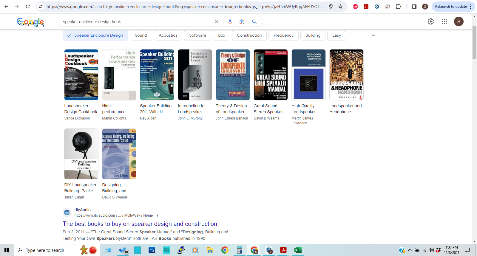

Hey Francois, your best bet is/are books
I'm sorry, I don't have a specific recommendation. Maybe one of the other guys will.

Seth wrote: Fri Dec 08, 2023 4:44 pm Hey Francois, your best bet is/are books
Thanks a lot, I'll see if I can find any of these books here!
