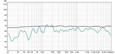

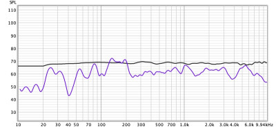

Well there is a boost from 130hz to 200hz from the La Scala's. And a big dip around 40hz from Tuba HT. Green lines with EQ in MiniDSP, not much different, which indicates standing waves...?. (All with 1/6 smoothing).
Posts: 29105
Re: Not getting powerful sound out of Tuba HT LP
#8 Post by Bill Fitzmaurice »
That 40Hz notch is probably a boundary reflection. It's the source of your problems. Either the sub is 2 meters from a boundary or your listening position is.

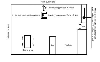

This picture shows my situation. Not typical HT room, its a compromise... (it's one open space)

I'd say that 2.25 meters to the wall behind the LP is the problem. Take a measurement with the mic 30cm from the wall.

#12 Post by Seth »
The mouth of the sub is also about the same distance from the side wall. It would be worth flipping it end to end and testing again too, even if it means it's behind the baffle wall.

Bill Fitzmaurice wrote: Thu Jul 27, 2023 8:21 am I'd say that 2.25 meters to the wall behind the LP is the problem. Take a measurement with the mic 30cm from the wall.
Okey, I will take a measurement 30cm from back wall. But are you suggesting a listening position 30 cm from back wall?

Seth wrote: Thu Jul 27, 2023 8:48 am The mouth of the sub is also about the same distance from the side wall. It would be worth flipping it end to end and testing again too, even if it means it's behind the baffle wall.
Well, I had the sub flipped as a starting point, but the position where it is now is giving a slightly flatter response, not night and day difference.

Jan-Kees wrote: Thu Jul 27, 2023 9:32 am But are you suggesting a listening position 30 cm from back wall?
If that's where the response is best it's either that, moving the LP closer to the front wall, moving the sub to the back wall, or adding a second sub on the back wall. As noted here viewtopic.php?t=398
If there is a 'prime directive' when it comes to sub placement it is this: Never place subs with their radiating planes between 2.5 feet and 8 feet of a boundary. If you do at some frequency the within the 35 to 100 Hz passband, depending on the distance, the reflected wave will be 180 degrees out of phase when it meets the original wave again, cancelling it out.
The same applies to the listening position.
