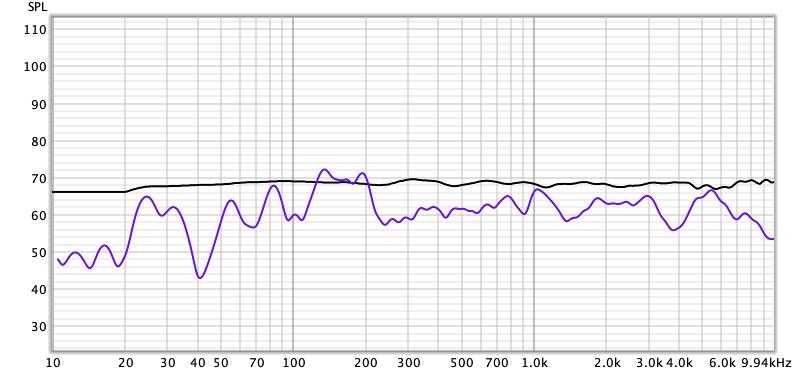

Do you have a screenshot of your REW measurement of the tuned system you can post?

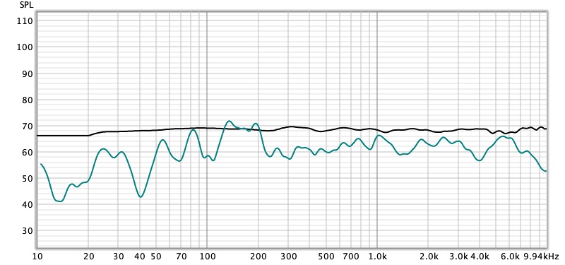

Well there is a boost from 130hz to 200hz from the La Scala's. And a big dip around 40hz from Tuba HT. Green lines with EQ in MiniDSP, not much different, which indicates standing waves...?. (All with 1/6 smoothing).

That 40Hz notch is probably a boundary reflection. It's the source of your problems. Either the sub is 2 meters from a boundary or your listening position is.

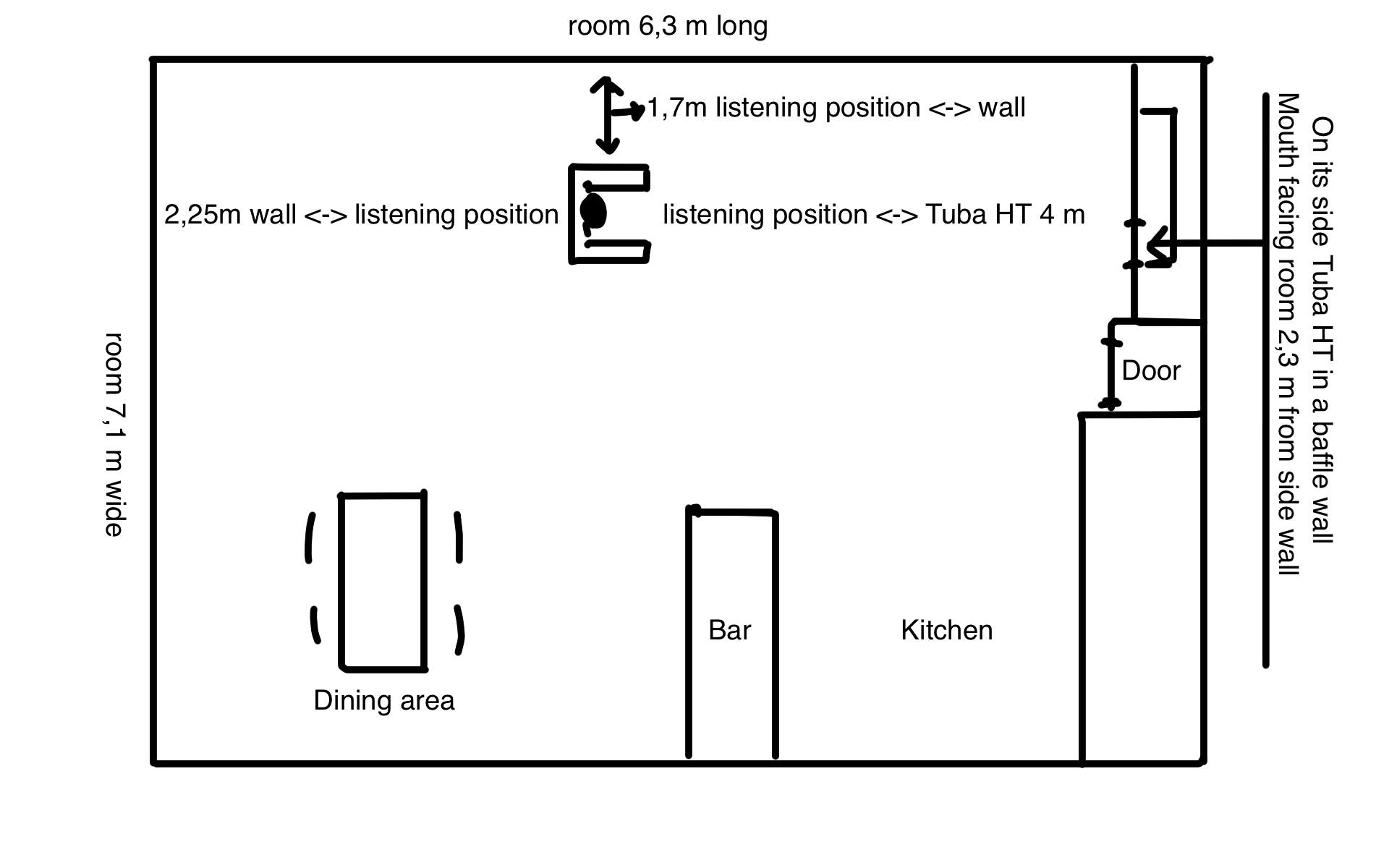

This picture shows my situation. Not typical HT room, its a compromise... (it's one open space)

I'd say that 2.25 meters to the wall behind the LP is the problem. Take a measurement with the mic 30cm from the wall.
Re: Not getting powerful sound out of Tuba HT LP
The mouth of the sub is also about the same distance from the side wall. It would be worth flipping it end to end and testing again too, even if it means it's behind the baffle wall.

Okey, I will take a measurement 30cm from back wall. But are you suggesting a listening position 30 cm from back wall?Bill Fitzmaurice wrote: ↑Thu Jul 27, 2023 8:21 am I'd say that 2.25 meters to the wall behind the LP is the problem. Take a measurement with the mic 30cm from the wall.
